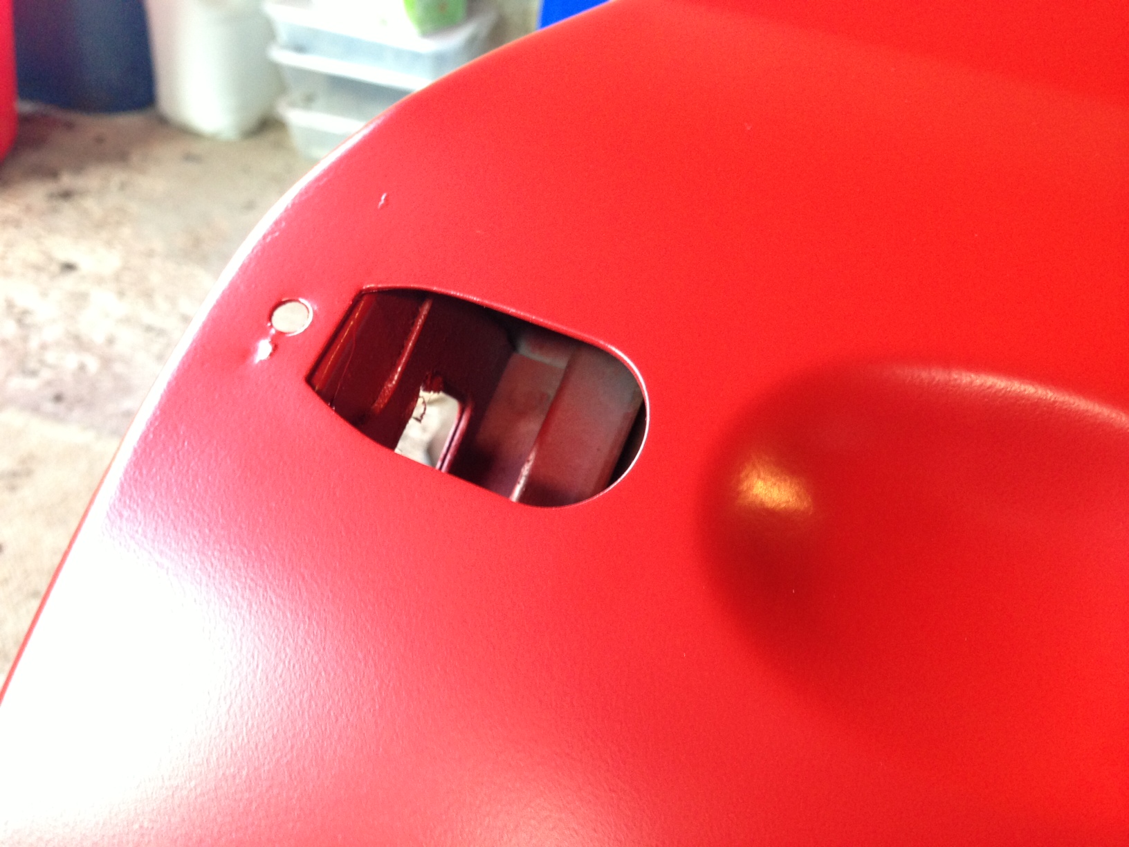

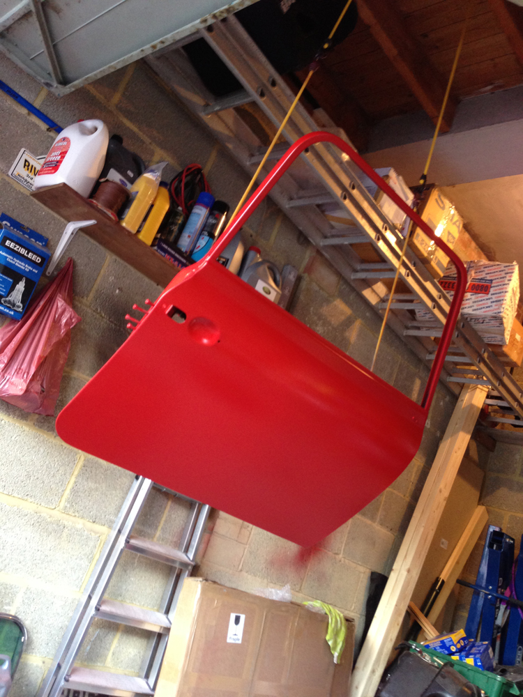

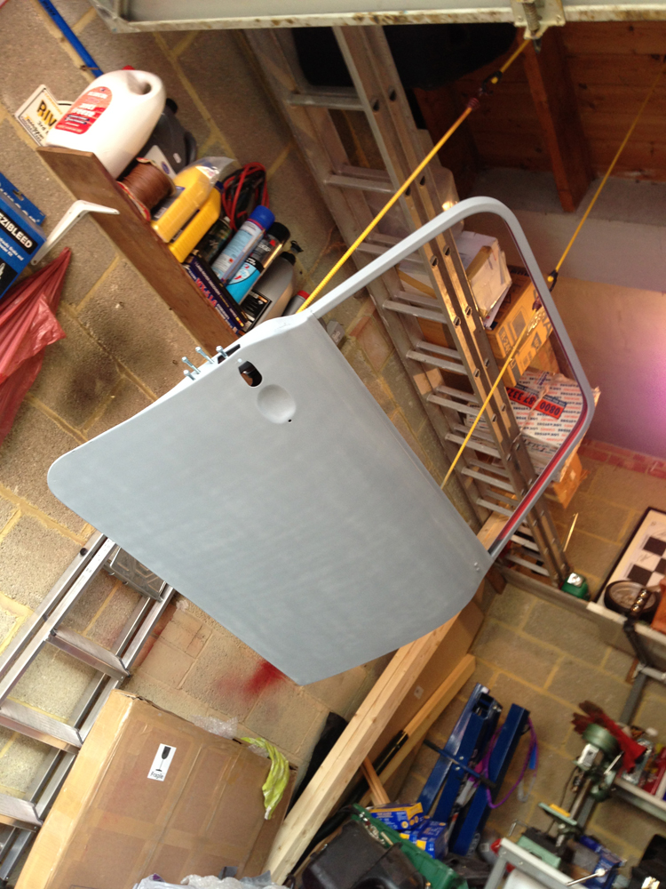

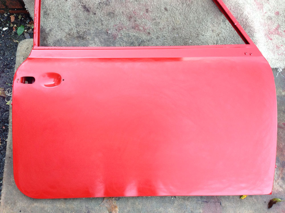

Not doing much this week, but decided to start on the door. Primed it yesterday, then first coat of red today.

2nd coat done. Next I'll flat it back, do a 3rd coat and then it's lacquer time.

looking good Alex; are you putting the paint on with a gun or rattle can (i'm thinking the former)?
6297 Posts
Rattle can!
How did the engine strip down go?
I'd be happy with that then!

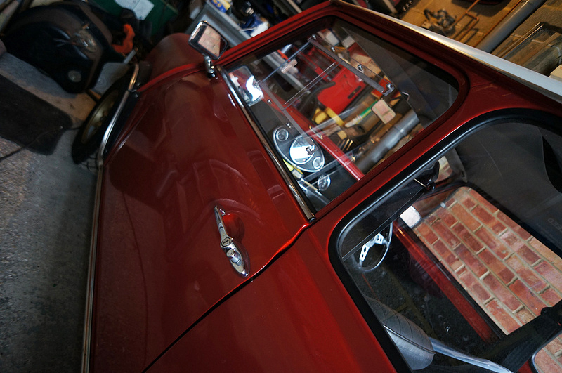

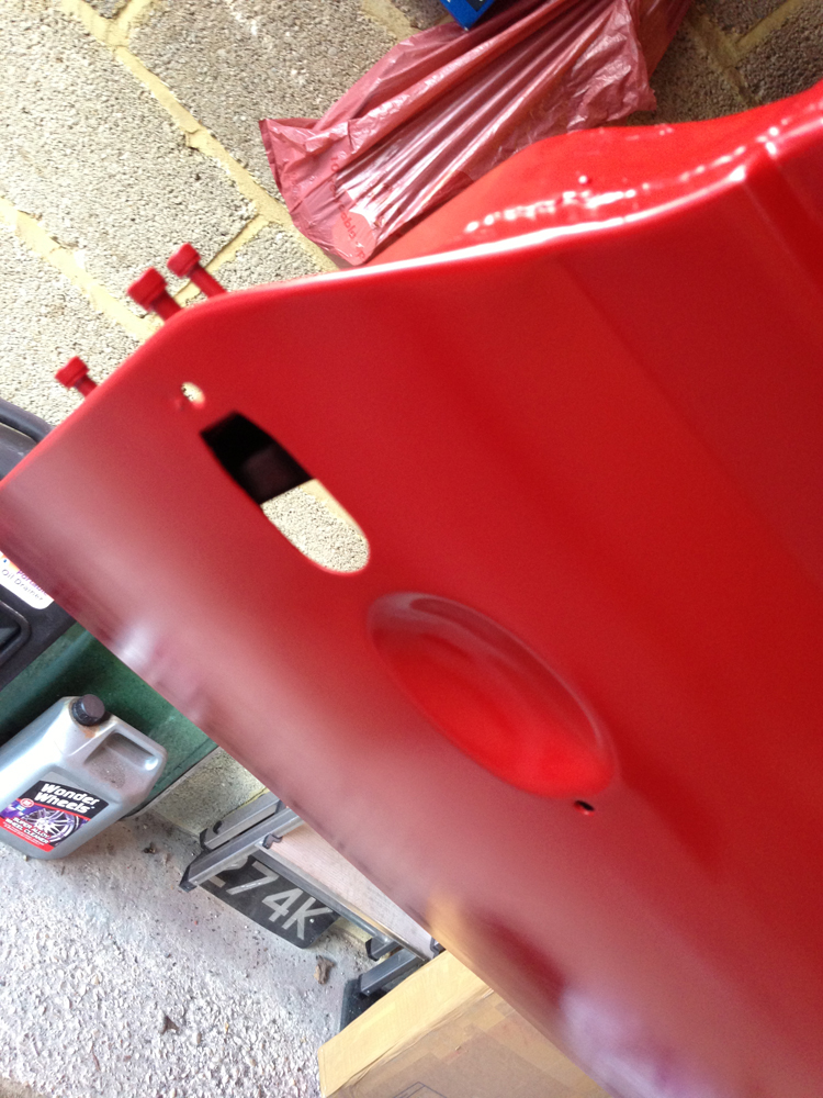

Haven't done much lately, but I just fitted one of the new door windows. I'm sure they'll be scratched and scuffed in about 5 minutes time, but they look alright now.
Haven't finished painting the new door yet but I will try to this weekend, then I can do the other side.

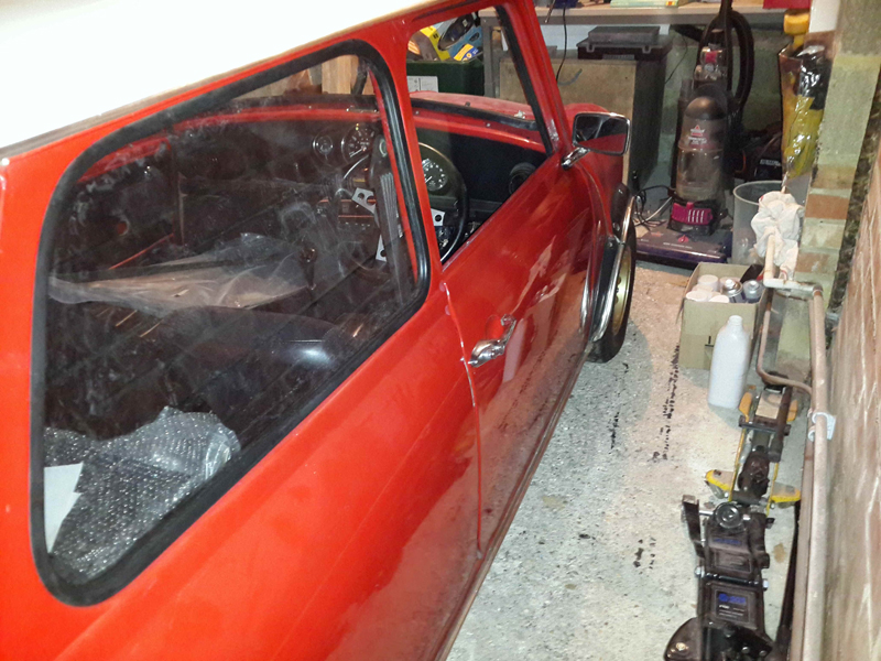

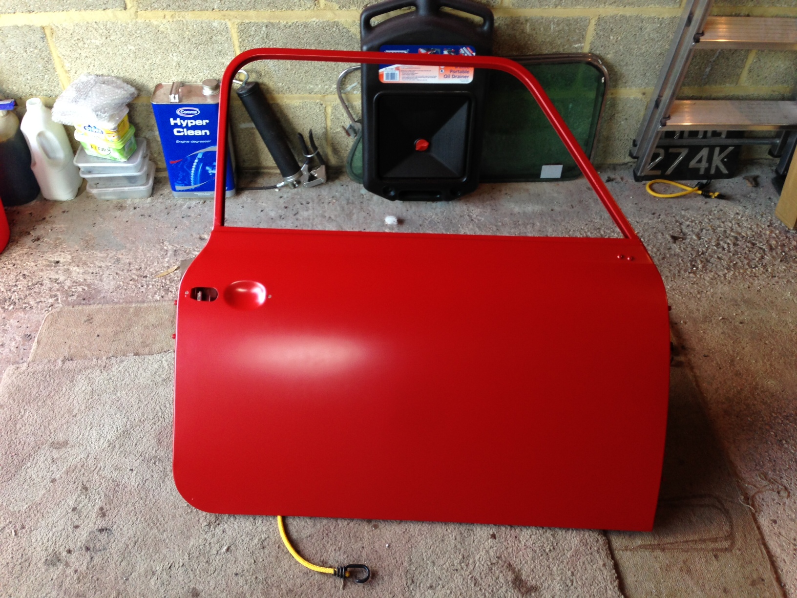

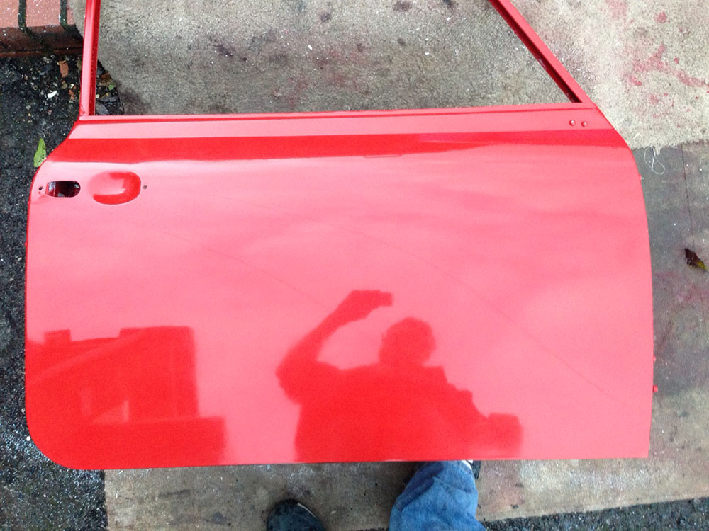

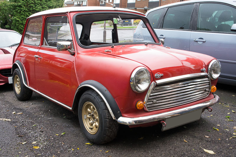

Not much progress really, but the door is ready to go on. It needs a polish, but it'll do for now. The whole car needs paint, so I'm only getting it far enough to use, rather than perfect. That said, I'll give it another going over once it's on the car.
If I get a chance tomorrow without rain I will swap the doors over and start re-fitting the furniture.

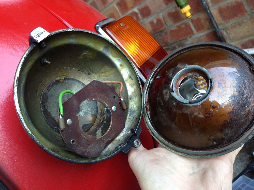

Also, I have a reverse light thing on the back, and I got the wiring working today, but I have no idea what sort of bulb to use on it - any ideas?

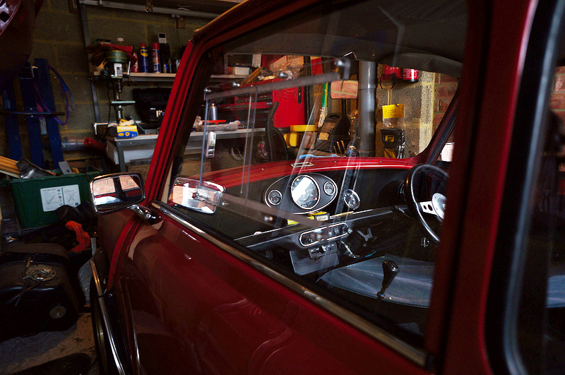

Got the door on - was a bit of a pain and I guess I'll have to do it again at some point. I couldn't get the hinges off since all of the bolts seem to have been rounded by someone else at some point - I didn't even try to turn one. I removed it from the door gap to the door instead, and then re-fitted the same way. The downside in doing this meant I had no adjustment on the door, so it's not perfectly in the frame at the moment, but it doesn't rub and it does shut.
I'll order some new hinges and re-fit at some point.
Only took one pic as it was dark by the time I finished.

Irwin nutgrips for the door hinge nuts. They are worth their weight in gold.
That door looks to fit really well. I'm pleased with that. *smiley*
6297 Posts
It looks less fab when looking straight on - it needs to go towards the back of teh car about 3-4mm I reckon. zero gap (0.5mm?) by the a-panel and about 1.2cm by the b-pillar.
Thanks tom, will google those
I've got a stack of stainless shims I can chuck in the post if you like.
6297 Posts
Only if you don't mind? PM me your paypal address if you want some dosh :)
Let me have your address and I'll send them down.

You need a single contact British Pre Focus bulb for the Lucas 576 lamps
Number 185 under 12V bulbs here:
http://www.vintagemotorspares.com/phdi/p1....document&part=7

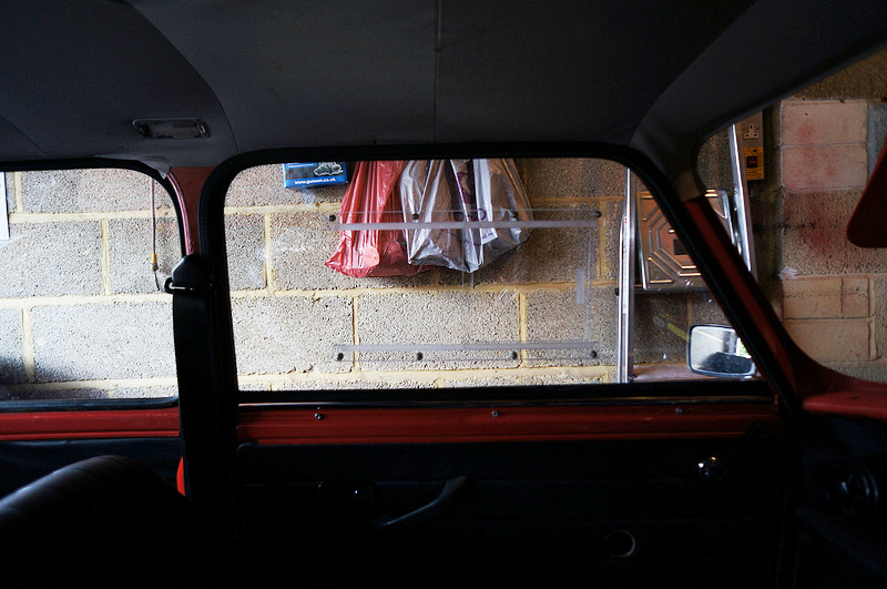

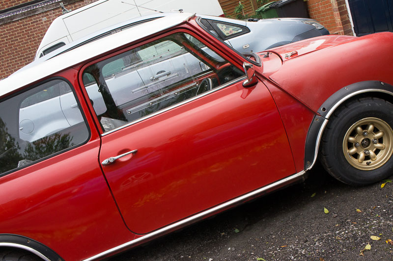

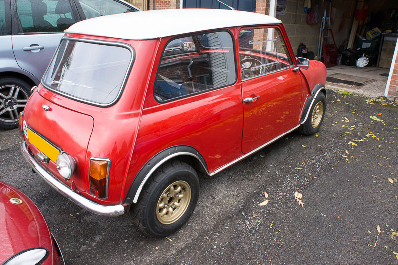

Fitted the window, and took a photo in daylight.
Could do with another polish really, but when the whole car needs paint, what's the point? Next big job is painting the frontend (check how dull it is!) but I'm going to MOT it first, since it's more boring when it's not road legal!
looks pretty good to me
