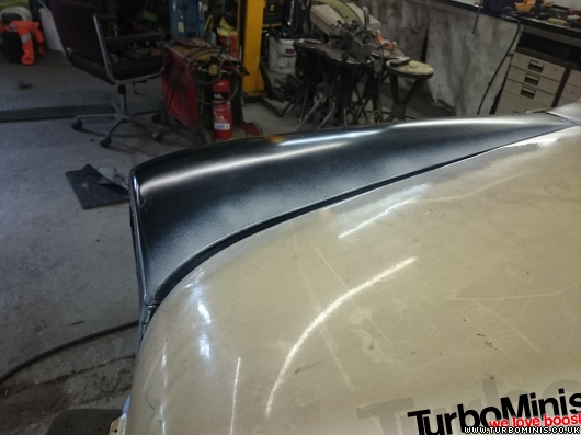

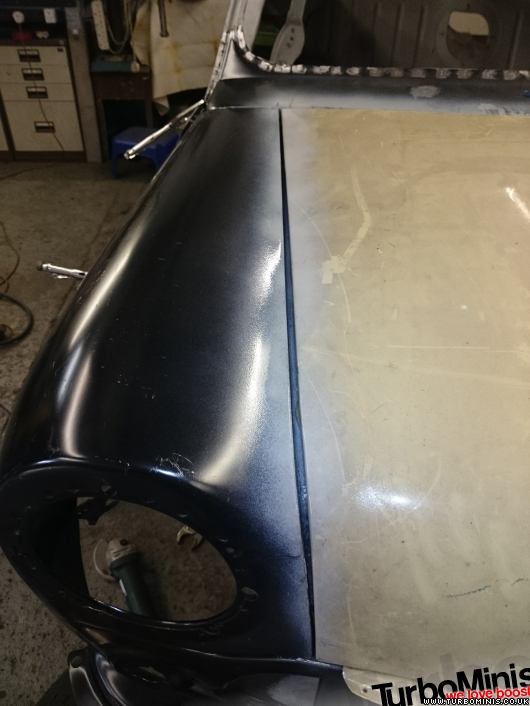

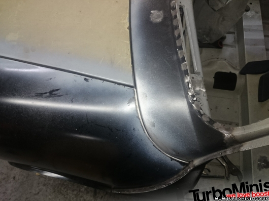

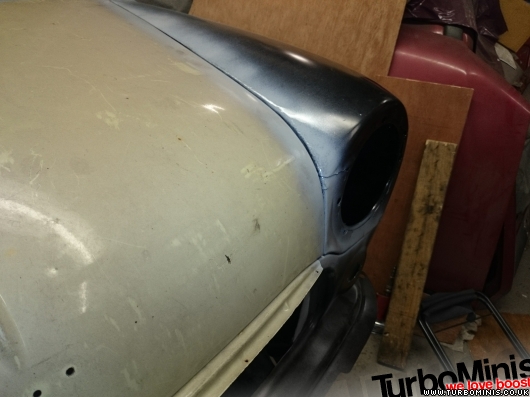

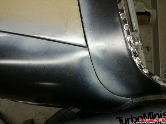

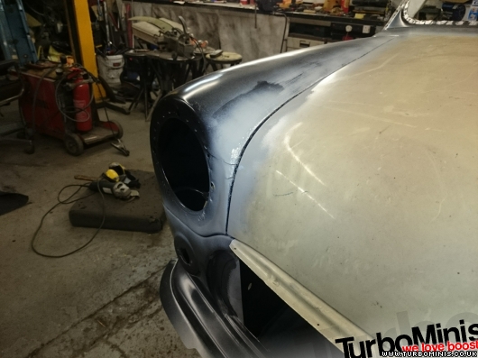

Got all the front end bolted on today to sort the panel gaps out. The wings weren't a great fit, the profile at the front was nowhere near that of the bonnet
It wasn't much better down the edge either and around the scuttle needed some work
So after a full day of bashing the gaps aren't far off now
Will unbolt the wings and front panel and get them ready for welding next. Got the dash rail welded in yesterday aswell

Look much better than the gaps to start with! Whats the idea behind the paint on the edges between bonnet and wing?

The paint just makes it easier to see the gaps that's all

Ahhh simples yet clever!

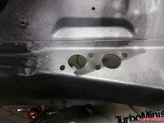

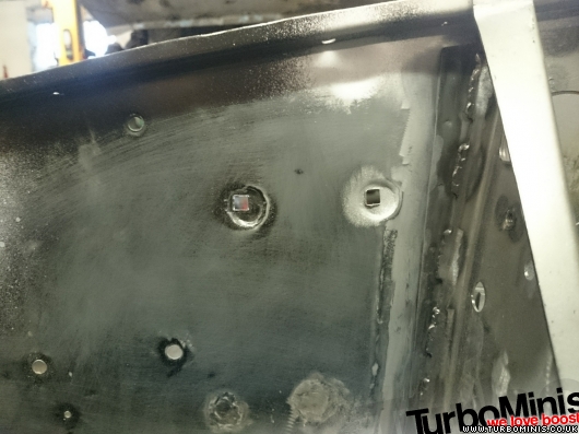

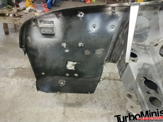

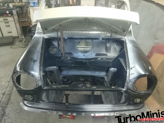

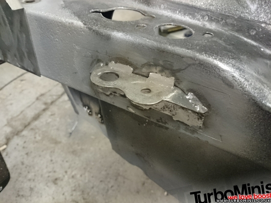

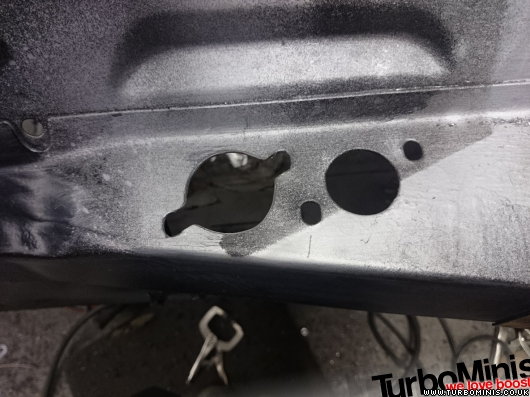

Been working on small details in the engine bay yesterday wanted to get them all done before the wings go on.
The bulkhead was off a mk1 so i copied the mk2 on saturn shape over to the crossmember where the master cylinders go
Before
After

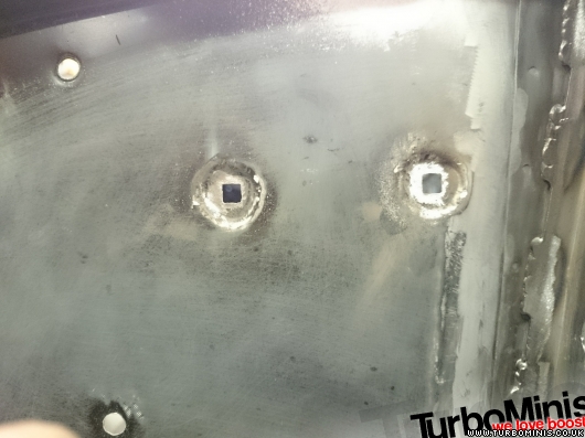

The square holes that the voltage regulator fixes to wernt central, think it must of moved when it was pressed, so i put them right
Before
After
Welded the engine steady bracket back on and decided to strengthen it up with some triangulation and a few stitch welds, maybe a bit over the top but this did break off on my last mini
Got the bonnet prop bracket back on, thats that side done

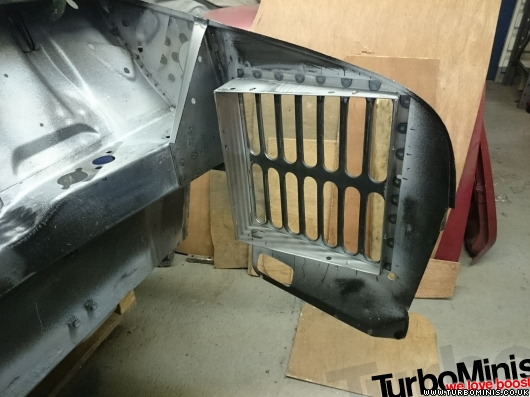

Then the other side was just the radiator cowl
Wings and front panel next
Edited by Callum on 13th Aug, 2017.

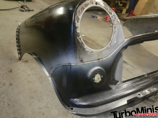

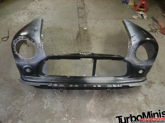

Got the wings welded to the front panel today, was going to prime them in my epoxy mastic aswell but one part of the 2 pack has gone
off so need to order some more.

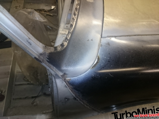

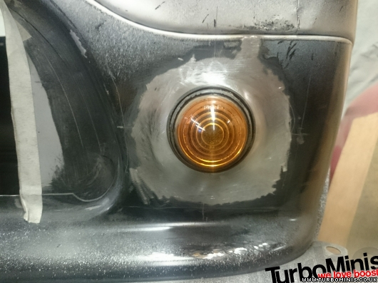

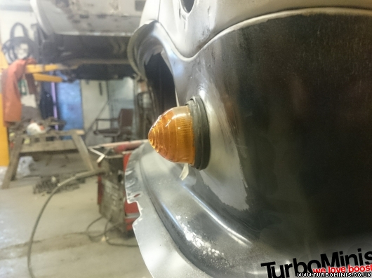

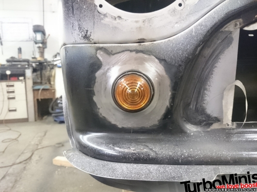

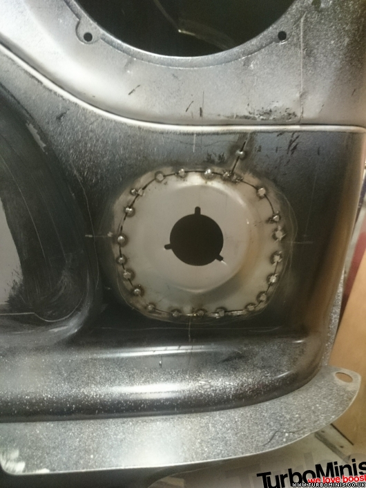

Started on changing the indicator plinths back to original. Didn't realise m machine made the smaller ones until recently, at first i thought i would have to leave it with the larger ones.
Got the passenger side in tonight
Conversion panel tacked in
Welded and lininshed

Wow... i thought i was an anorak n knew all the differences n did not know there was a difference like that... is it just how much it is defined/protrudes? Again amazing detail!
Nothing gets past Dave lol
Callum
450 Posts
Member #: 10396
Stoke-on-Trent

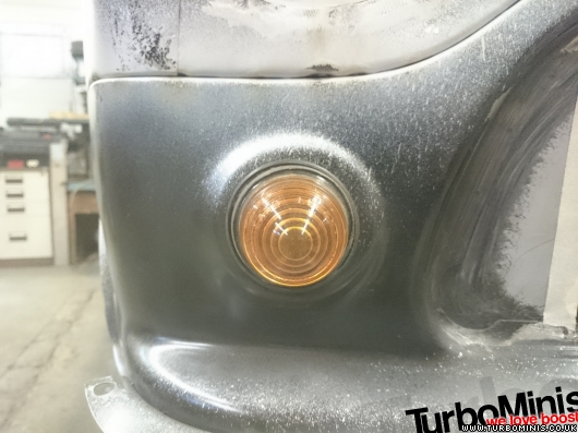

The difference is the size of the flat circular plinth that the lense sits on, if you look at the before picture around the lense rubber there is about 10mm of the flat plinth showing whereas with the conversion panel welded in the plinth is the same size as the lense

Got the other indicator plinth finished today.
Before
After

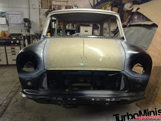

My primer arrived last week so i managed to get the inner wings and the inside of the front panel and wings painted, should be ready to weld on next week.

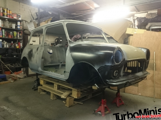

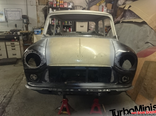

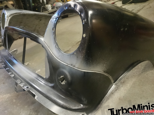

A mini is born! Front end is mostly welded on, couple of bits that were hard to access still to do once its back on the spit.
Will get the doors bolted on next and sort the gaps out
