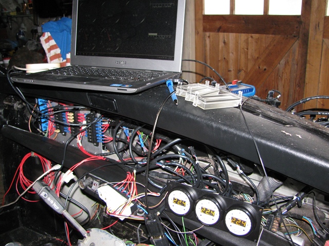

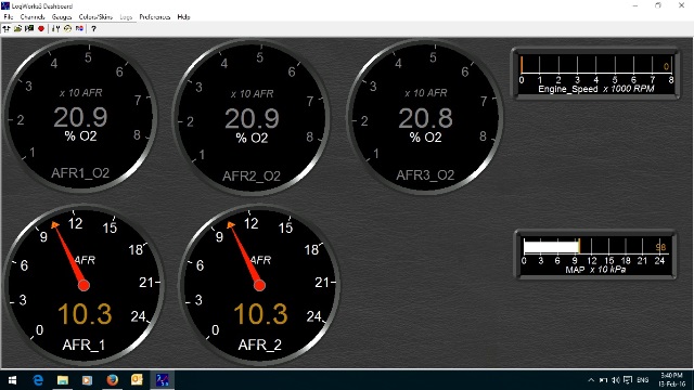

Most of the wiring has now been completed so I've been having a bit of fun with the instrumentation.

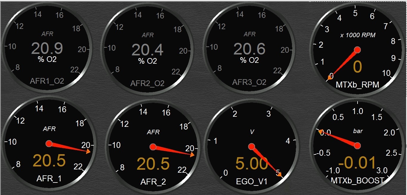

Given the current concerns that the 0-5v signal from the O2 sensor is not accurate and that the serial stream data should be used, I thought that I would set up some logging to get a handle of the errors that I can then correct by adjusting the scaling values in the MS3.
I'm using 3 Innovate O2 sensors which can be daisy-chained together and the digital data from the O2 sensors logged in Logworks. I've also got the Boost/Shift gauge that also adds MAP and RPM to the datastream.
There is also a historical and unsupported method to add data from the MS to the Logworks datastream, so, in theory, I should be able to add the O2 value for each sensor derived from the 0-5v signal by the MS3.
Well I finally got it working today:
Screen shot from Logworks:
The top 3 O2 gauges are the digital/serial values. The lower 2 are from the MS3 0-5v value. Getting the 3rd value needs a bit more work.
None of the gauges are properly setup yet and the 0-5v signals are not connected so the values are all over the place, but the main stumbling block of combining the 2 datastream into one piece of logging software is sorted :)
Edited by Paul S on 13th Feb, 2016.

Using a TinyIOx would make this a whole lot simpler. You would have everything in TunerStudio.
Having said that, it will be interesting to see what you find out.

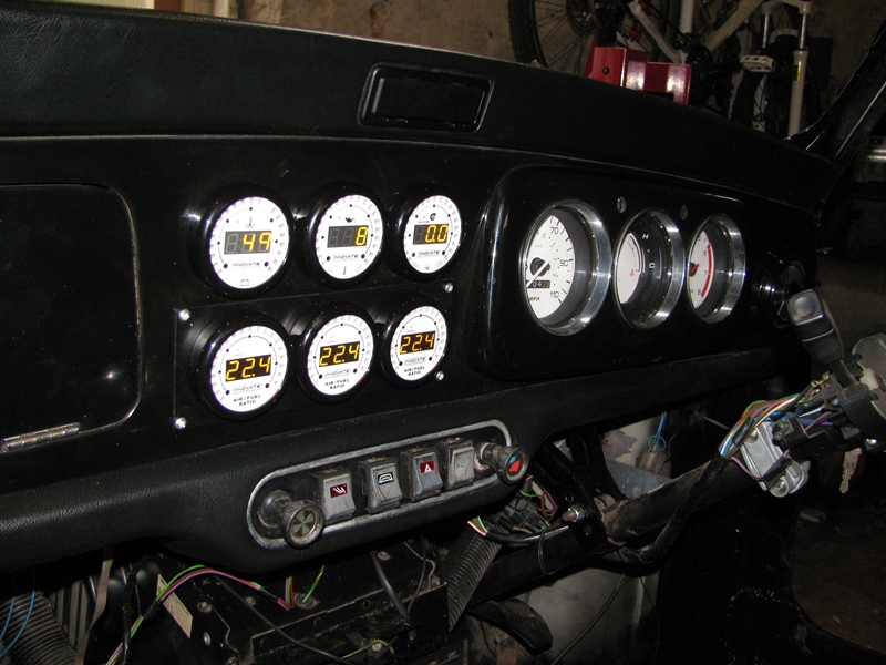

Finally fitted the dash from Sturgeo's car. It will do nicely:

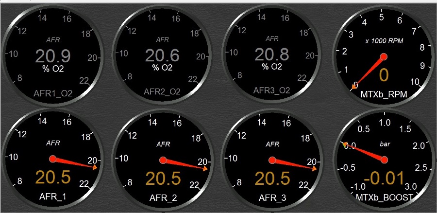

All the Innovate stuff is connected up. Some odd readings on oil pressure and water temp to resolve but maybe just the minimum.
Datastreams combined on the laptop and showing some comparable readings on the digital/analogue channels but not the gauge display *oh well*. Displaying/logging the 5v gauge output for AFR1 as reference. Still can't find AFR3 on the ECU though *frown* :
Offset 254 is not working?
http://www.jbperf.com/
No. There's something odd going on. I've edited the xml file for 252, 253 & 254, using 'A' and 509 bytes but Logworks says that it is using the old 28 & 30 for AFR1 & 2 and the plugin does not give me the option of AFR3.
It's not the end of the world as I only intend to use it to check that vailidty of the 0-5v signal, which I can do with AFR1 & 2, but I'm seeing some odd numbers so far.
EDIT: Windows 10 has, for some unknown reason, copied the Logworks2 & 3 folders to the "virtual store" which is why my edits have not taken effect *frown*

Success:
Top row of O2 gauges are off the Innovate MTS datastream, the lower row are picked off the MS3. Boost and RPM come from the Innovate stream.
Used 'A' and 509 bytes, channels 252, 253 & 254, so it can pick up the full dataset *happy*
Biggest problem turned out to be getting around Windows 10 "User Access Control" and Folder "Ownership" so that Logworks was reading and writing to the correct folder :x Even then had to delete copies of the Logworks folders in the "Virtual Store" !!!
Next job is to set up a tablet displaying calculated channels such as Delta AFR, Average AFR etc to supplement the actual gauges.

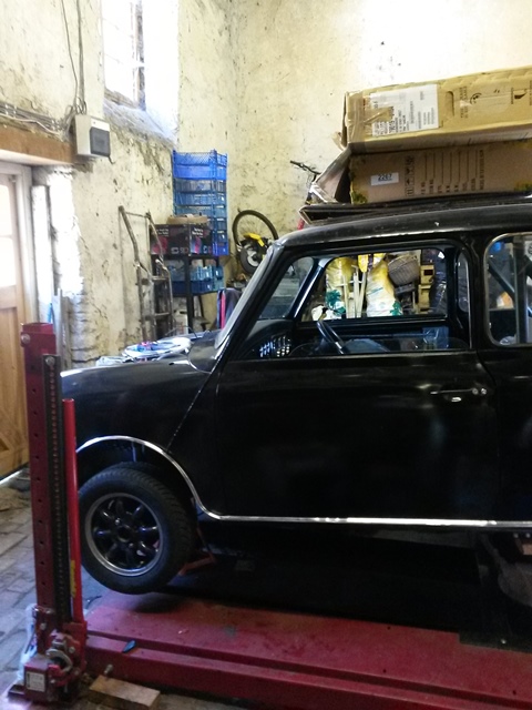

Fitted some old wheels and trim to check that the tyres do not stick out too far.
Looks fine :)
Need to get the 12" steels coated and some new tyres.
Ready to start, almost :)

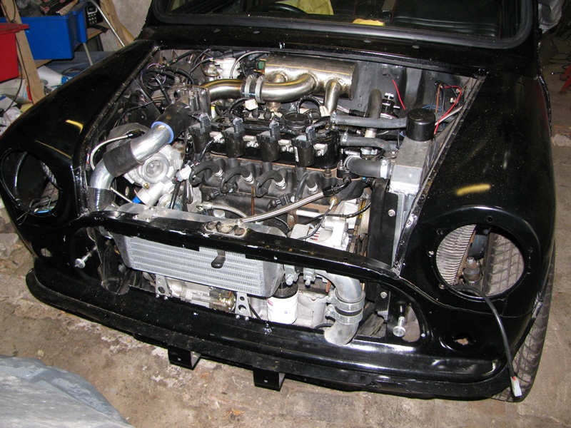

She runs :)
Sorted out all the electronics and got oil presure last week. Today, set the fueling, adjusted the timing, put the spark plugs in, powered up the injectors and coils, turned the key to check for firing and at the second attempt she was running!!!! Took longer to upload the video. A bit of smoke from the manifold.
First run is at high revs to bed in the camshaft which is just as well as it did not want to idle. Need to carry out a few checks and make further adjustments, but major milestone
https://www.youtube.com/watch?v=hAyCpcE7Tvc
