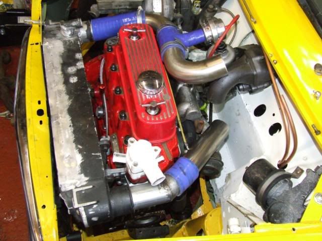

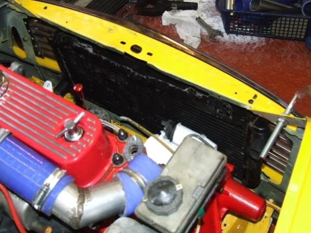

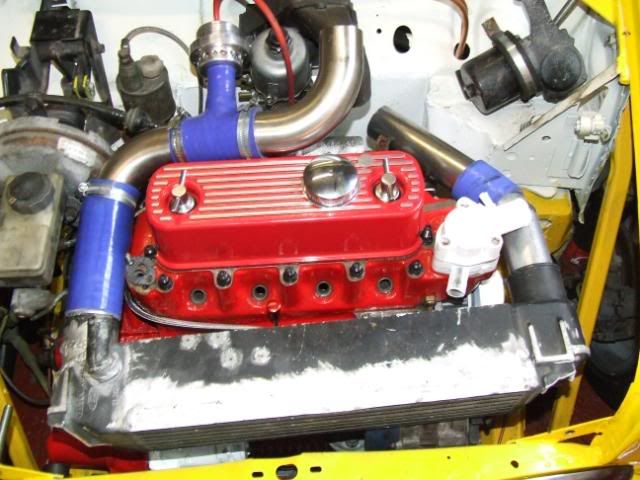

Well thanks to Jordie i have me DV and boost pipes bits n bobs. I took em all to peices and like lego tried different ways, finally found something neat and workable. managed to get the front rad fitted and still maintain stock alternator. some nibbling will need to be completed on the edge of the rad (its just the frame that does not hold water *wink* ) as it is just fouling the blades on the pulley of the alternator. I have seen a golf one which is smaller and mounts the same way so will go and retreive it from the lockup later :) although the cooler appears to be tilted on the photos, it is actually square so the whole of the core is facing forward rather than 45degsish towards the ground *wink*
once i have had the car sortid i will probably get the boost pipes made out of one peice, if it works and people are happy to use this config i will start knocking em out the idea being that the pipe from the turbo will have a flange on it so you do away with the cast alloy peg bit *wink*

Looks neat! Where did you get the IC pipes and hoses from?
Richie
3184 Posts
Member #: 628
JordieNE. i believe he may have a contact for the rubber hosing *wink*
I still need reducers from the cooler to the pipes.

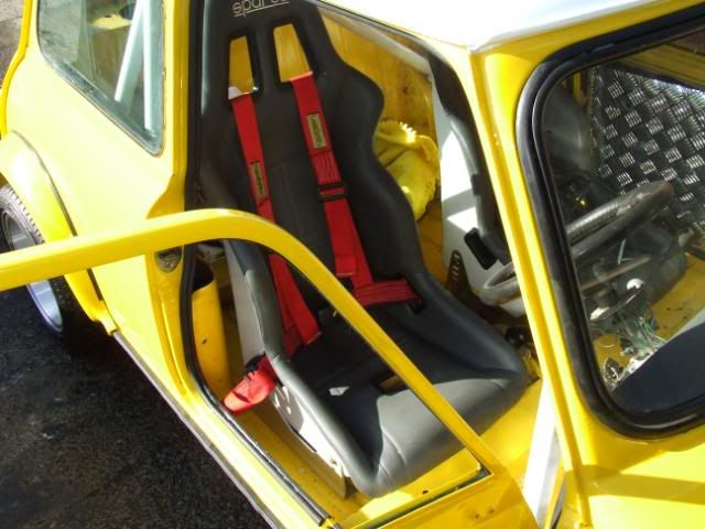

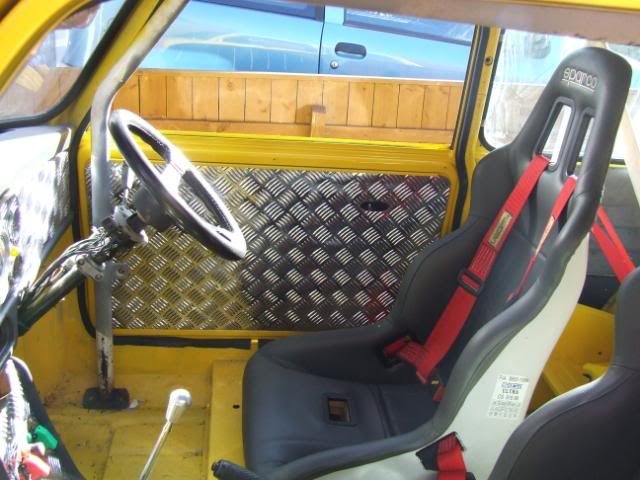

my seats are nowhere near that far back and its well uncomfy! dont you have issues seeing over the steering wheel/dash like that??
cool car, modern retroness man
hario
444 Posts
Member #: 2885
by the way the large hole in the block comes From the oil pump through the oilcooler if ones fitted, through the filter and into the main oil gallery, it is here where the oil pressure is read not direct from the pump which would give an unnaturally high reading, it is this same filtered oil that feeds the turbo..
(and the bearings)
Richie
3184 Posts
Member #: 628
seats are comfy as can be :) iam 5'10" tall so seeing over the dash is not an issue either.

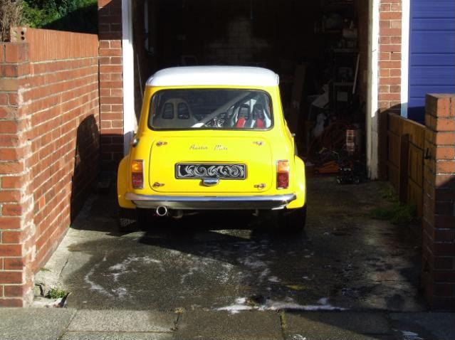

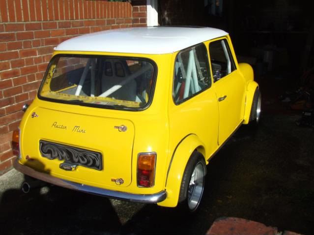

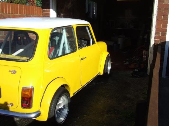

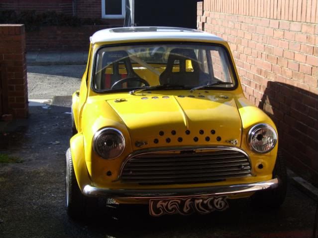

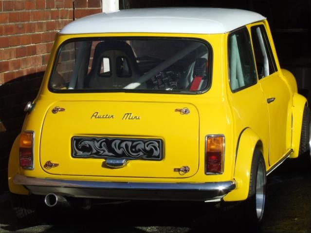

just rolled her out to wash the inch of dust of her, and to try get a pic of the crack in the cage which needs welded up.
so here she is 3 years later. almost done, still got the wiring to do, and iam waiting for the starter motor to come back, i had the mounting lugs cut off then re welded back on so the solonoid is facing ni on upwards *wink*
Edited by Richie on 18th Nov, 2008.
TRADER HALL OF FAME
TRADERS OF SHAME
1 user....pm me 4 details
LEGENDS
MikeRace, Mini13
On 17th Aug, 2009 Jay#2 said:
would it be too late to say paint the rear valance?
seriously nice mate, im just being picky to find something *tongue*
being so close to the end has to feel good *happy*
Richie
3184 Posts
Member #: 628
rear valance is white as per the sills, kinda mirror image of the roof
