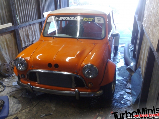

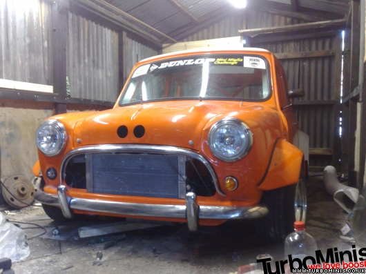

I love this car, looks the muts nuts!
Is your bonnet a tdk racing one?

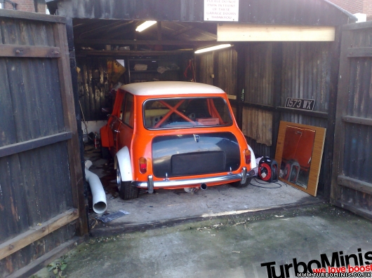

Your shed is only just about wide enough to fit your car in mike haha, looks awesome nice one,
