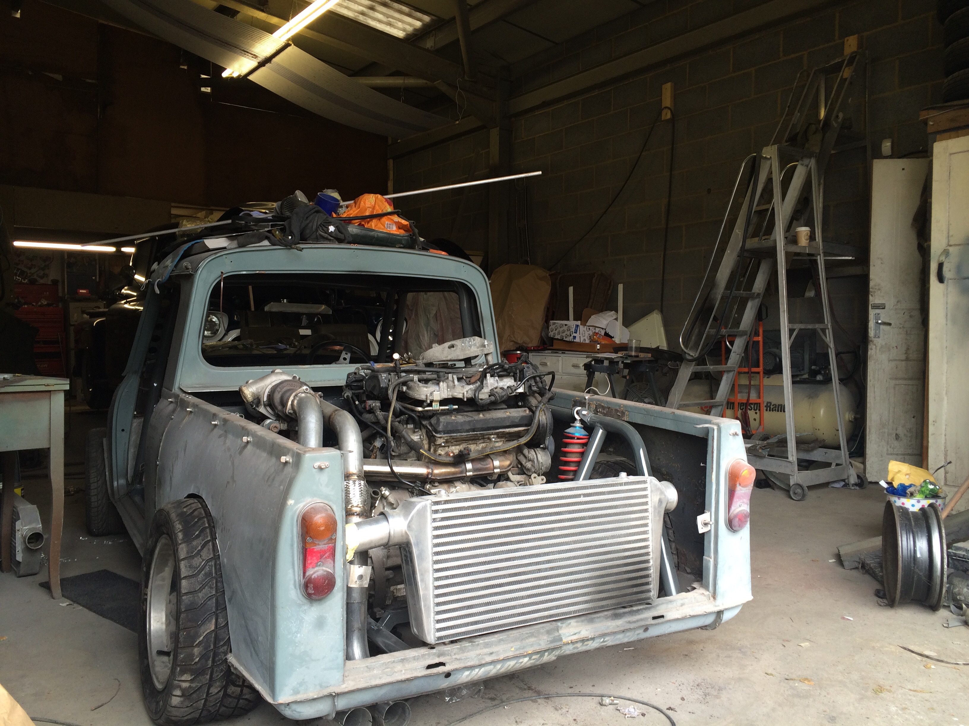

Engines mounted now fitted 3 large 55mm rubber ones like before but il add some stabilisers when everything else is in and fitted up
just need to go round and weld everything up, and make some other adjustments,
Need to get the front subby built back up as I used the one from this on the sprint,
Obviously got lots of bare metal that needs coating, maybe red oxide for now

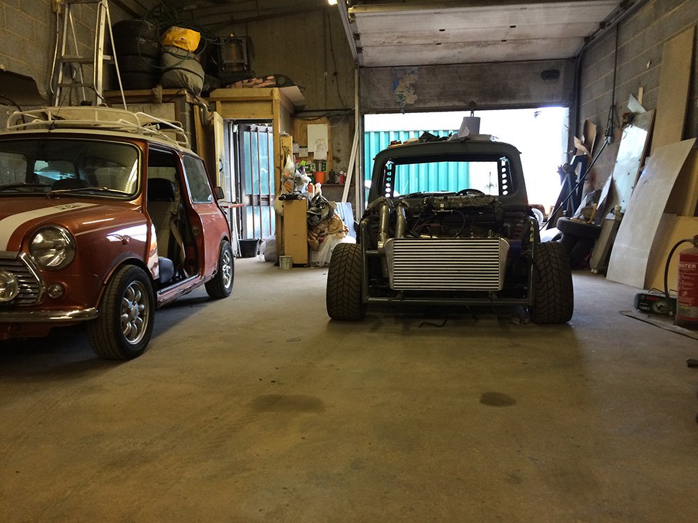

So I have been back about a month now and I sold my orange bodychop to finally get the truck finished!
And so far I am actually getting there for once,

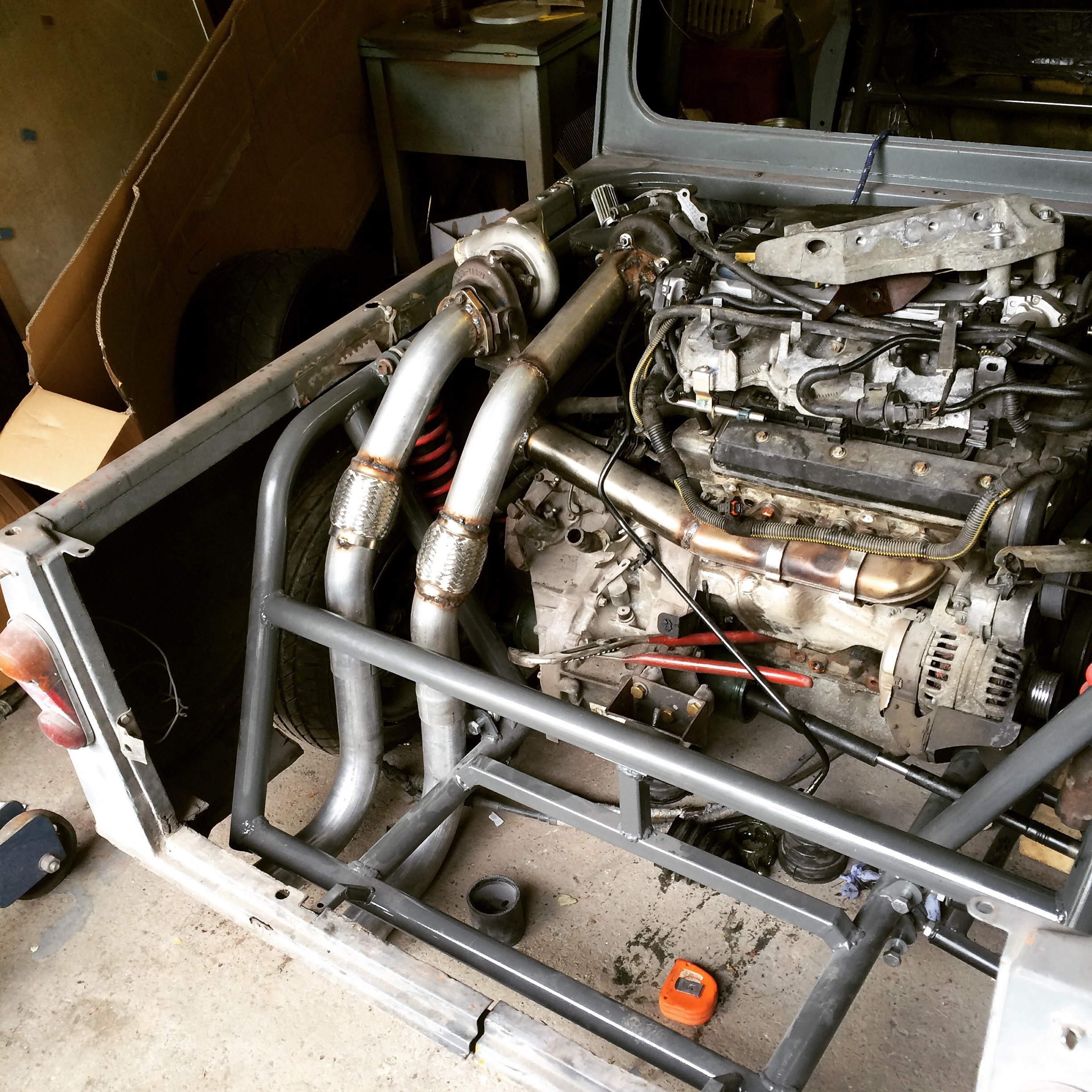

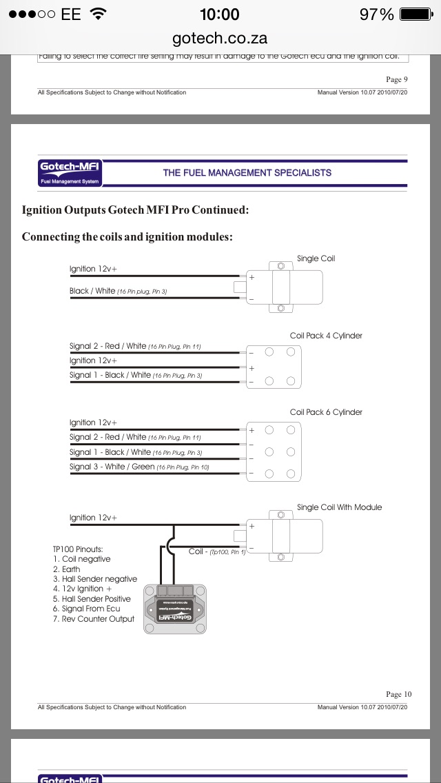

Ended up going for a 3.2 instead, i'm currently having a ball lake with trying to find a wiring diagram for a Vauxhall Vectra C I have an aftermarket ECU to wire in, I think it's going to be a case of some how continuity testing all the wires to find what I need.
I changed a load of stuff and made a few bits and pieces a little bit better although I do have a feeling I won't know that I'm fairly happy until I've actually driven the bloody thing

Welcome back… that is one mean looking machine! *Yes*
Jay#2
2500 Posts
Member #: 648
Northern Ireland (ex AUS)
I was going to ask if your going turbo, then I saw the pics. Good man!

Had an absolute mission tracing wires back,
Because I have 2 coil over plug packs, one each side..
Do I just wire it together like a single coilpack ? As in each of the packs has 3 matching signal wires and the ECU has 3 outputs
Here's the diagram if anyone can make sense of it
monsterob
264 Posts
Member #: 11029
Crewe
vauxhall diagrams are propper dog dirt !
the kit car i built used a donor vauxhall omega !
never using vauxhall again ! sorry i cant help on the wiring diagram but you could check to see how the megasquirt guys do it
i had ms3 on the 4cyl ecotec i had.
