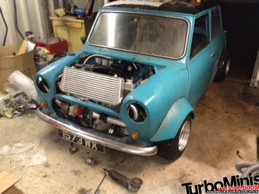

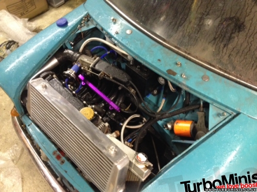

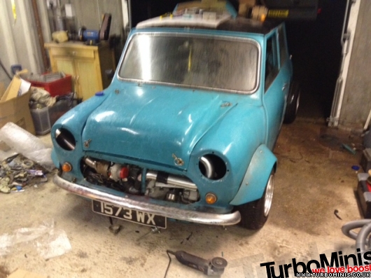

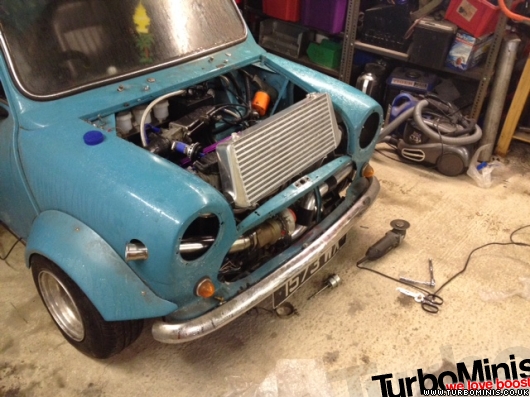

Managed to get the Intercooler Mounted and plumbed in.
I literally cant believe the bonnet fits but it does. Next on the list is Injector rail, fuel lines, ingition module, fill it with fluids, new sparks.

1st pics thoughts... "naaa that cant fit"
2nd pic "naaa"
3rd pic "no way no way!"
4th pic "ohhhhhh bulgey bonnet"
Looks really good!!

That's one big IC!
Will it not get a little warm being right above the mani. Suppose there isn't much choice though.
haha no mate i've kinda exhausted the available space!
Im going to run some lagging over the whole system as everything is in such close proximity to each other.

How does the IC get any air flow through it?
any plans on puting holes iin the bonnet to let some air at that cooler?
Yeah, cant decide wether to go circles or triangles. I vaguely remember someone running triangles from way back in the days on Avon BMS.
Ive also pondered on the idea of making some form of duct down toward the grill to force air up a bit too.
The rear of bonnet stands proud so air should escape out and up the windscreen.
I like the triange idea, think it might have been turbo tims car that went on to be the frog2?
i seem to remember robert doing a wool tuft test on the jacked up bonet rear, IIRC the windscreen pushes air down under the bonet and it exits at the sides. I think that carbon wezel wind tunnel test confirmed this.
Ah right, well the bonnet is upped at the back due to the massive bulge. But i suppose I could cap it off with a sheet of FB to stop that from happening.
Nathan1293
45 Posts
Member #: 11153
There was an article in a previous mini magazine/world issue that looked at areodynamics, and that also showed that air does not exit the rear of a jacked up bonnet, unless you are driving very slowly.
So all the racers that jacked up the back of the bonnet weren't getting the effect they thought for areo or cooling.
It is most areo with the bonnet in the normal position, with gaps sealed.
I think capping off the rear of the bonnet is in order then. The IC should get some good air as the gap above between that and the bonnet is very small so all air will be force through it (in theory lol)
yup ,about 5 inches either side at the back was outflow ,the rest inflow .
