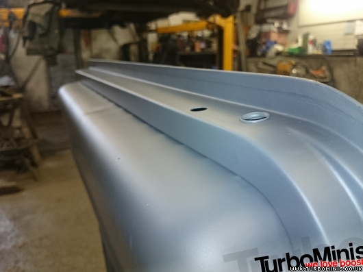

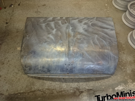

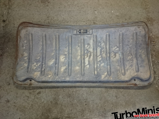

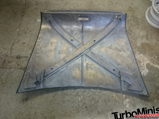

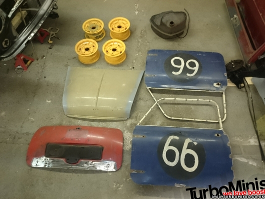

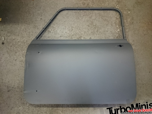

Cheers for the comments. Not had much to update really due to work and holidays but getting back to it again now. I had a load of parts acid dipped at the start of the month. Very happy with how it all came back, the bonnet and bootlid dont need any repairs, the doors are still on their original skins and only the driver's side needs a couple of small patches so chuffed with them.

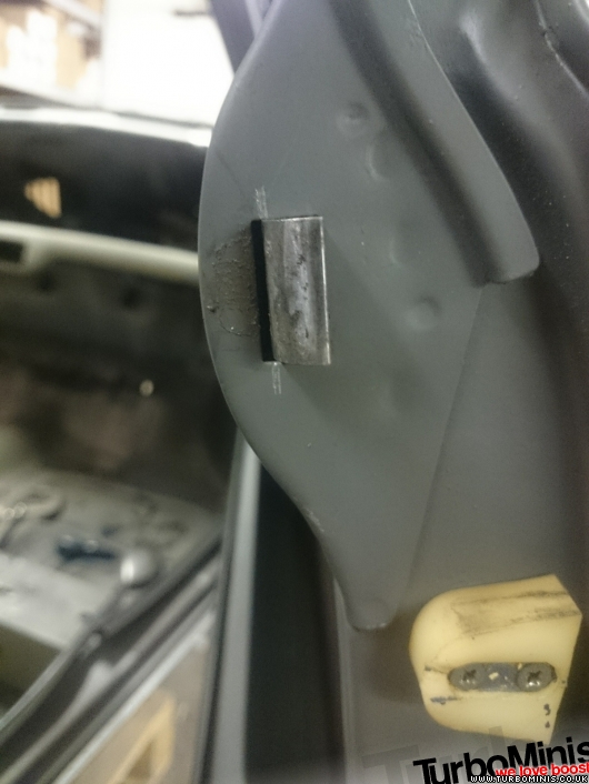

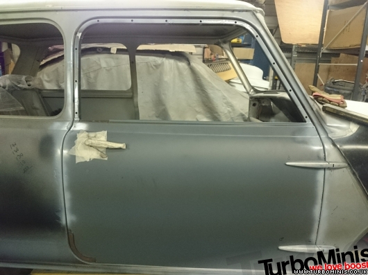

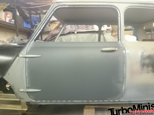

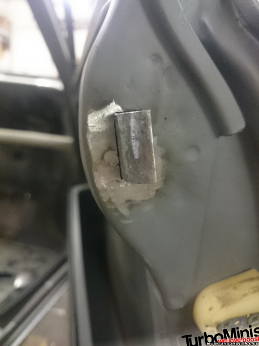

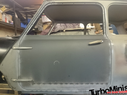

I spent today playing with the drivers door and it fits quite nice now, had to add some weld then file it back where there latch comes through the door as i think the latch is worn and sloppy meaning the door would pop out slightly when shut
Before
After
The gaps need sorting now which is the next job but the door tucks in nice on the bottom corner.

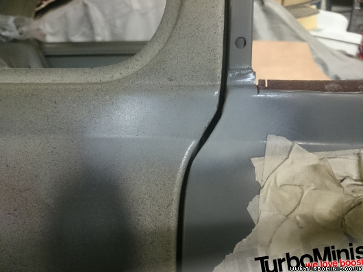

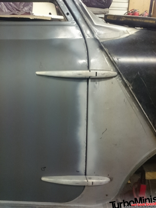

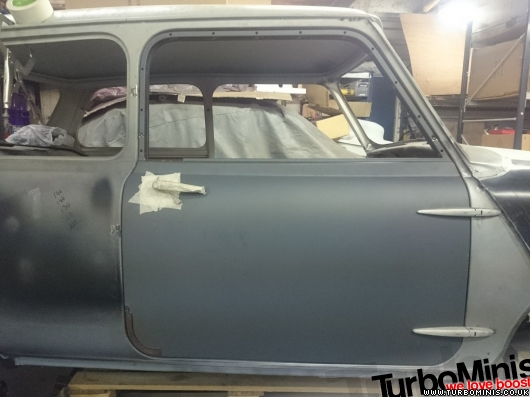

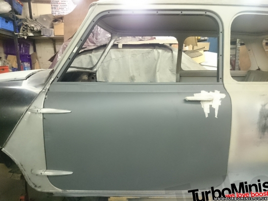

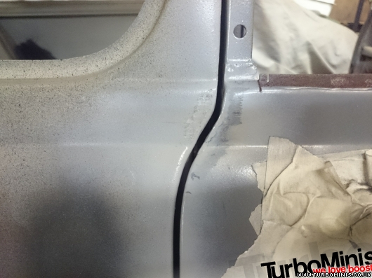

The drivers side door gaps are nearly done, just got to do both bottom corners which i will have to leave for now as the doors have got to go back to be dipped again as i found a small lump of rust in the rear bottom corner

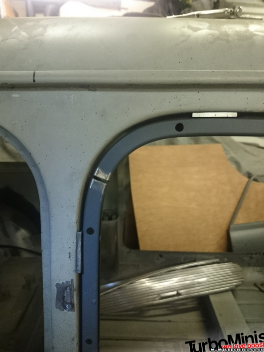

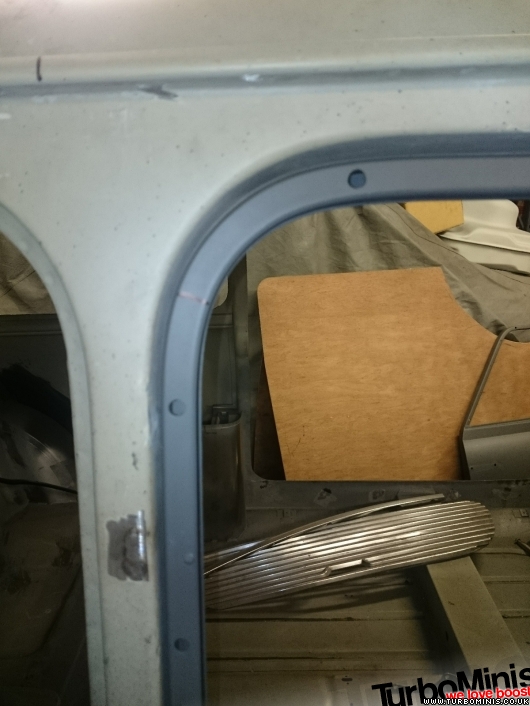

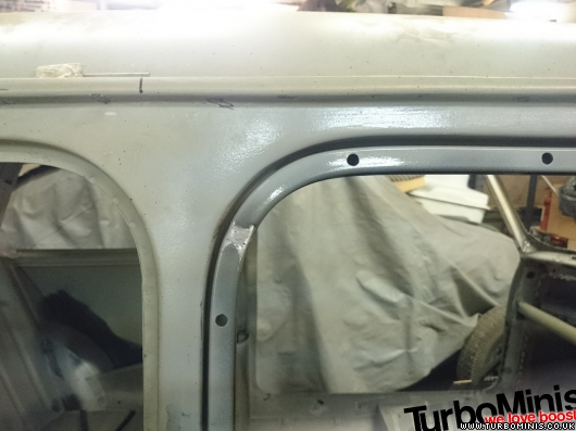

I tackled the upper frame first, the gap at the top was way too big so only fix was to cut the frame and let a peice in
Before
Cut and the gap corrected
Welded
The door apature needs now filler now as it lifts up towards the rear of the door.

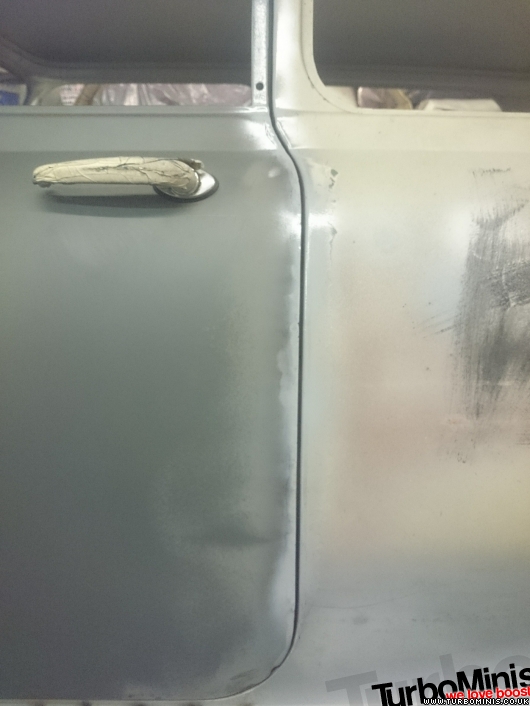

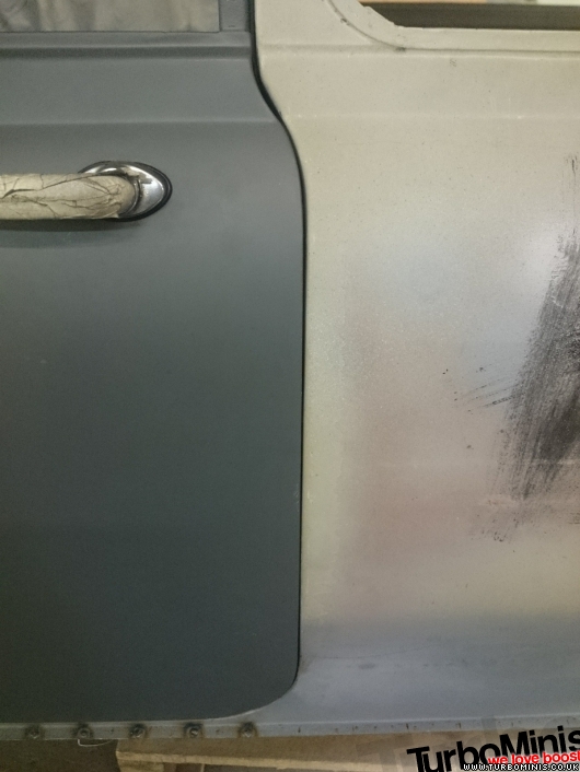

The rear of the door needed a bit of work
Before
After
The front required the most, was too tight at the top, too big in the middle and then going tight again towards the bottom
Before
After
How it looks together
Will turn it round and start the passenger side now. Cheers

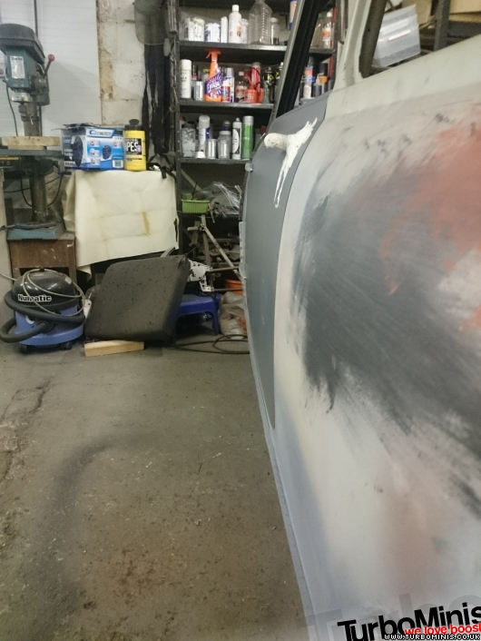

Turned the mini around today and got the passenger side bolted on, the gaps are pretty shit but the door shuts well and tucks in nice at the bottom
Had a little helper today
Although he did bugger all most of the day

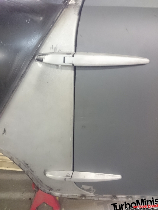

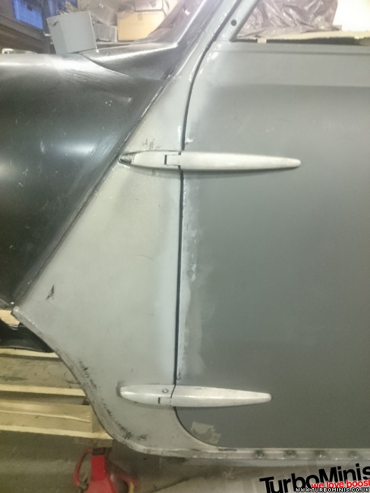

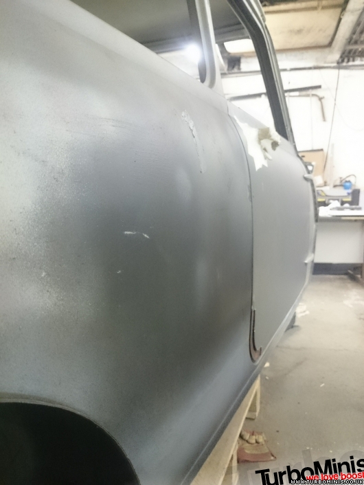

Not had much time on the mini recently as I have had to do some work on the house, but managed a few hours this week so carried on with the passenger door gaps, got them nearly finished today.
They were close at the front and nearly touching at the back, a lot better now but still needs a bit of work.
Before
After
Got to finish the bottom and the upper frame but the door apature needs some filler first so will have to wait to finish that

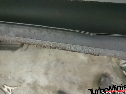

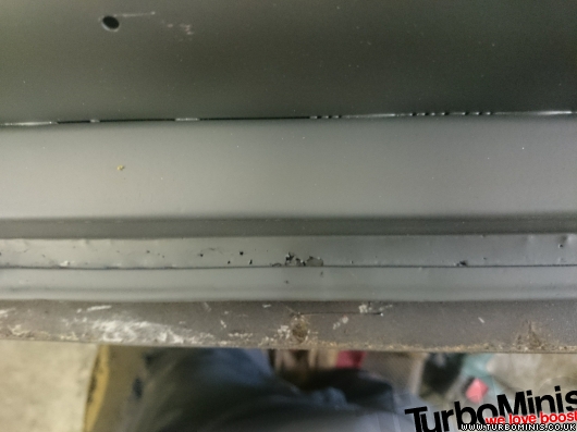

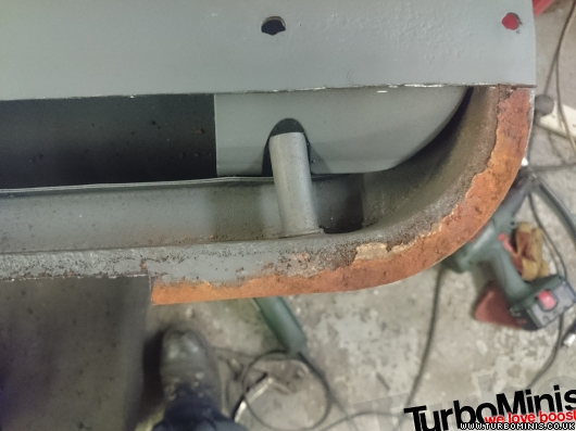

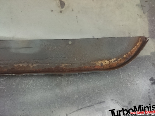

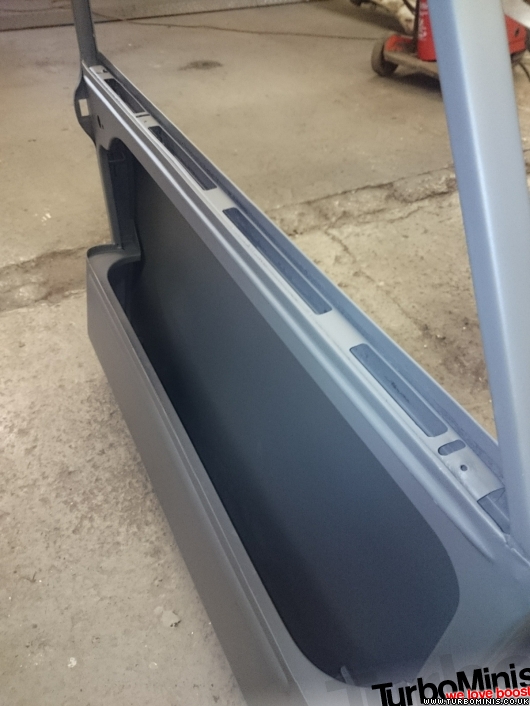

When I started gap at the bottom of the door I noticed more rust in the seam so the doors went back to be dipped again. Came back with a few small holes so I decided to take the door bottoms off so I could make some repairs, glad I did as they were very thin. In hind sight I probably should of just put new skins on.
With the frame repaired i made the door skin bottom, decided to joggle the joint and plug weld to avoid distortion. Seen this done on the quarter panel bottoms so thought it would be ok on the door as well, anyone see any issues with this?

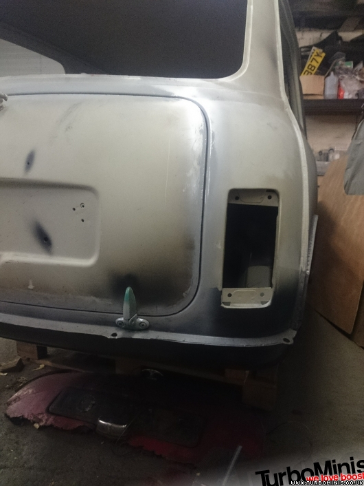

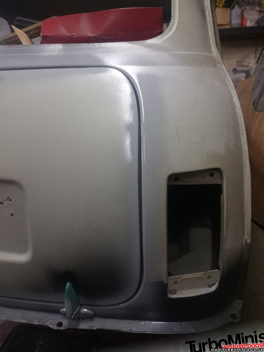

Stoke-on-Trent

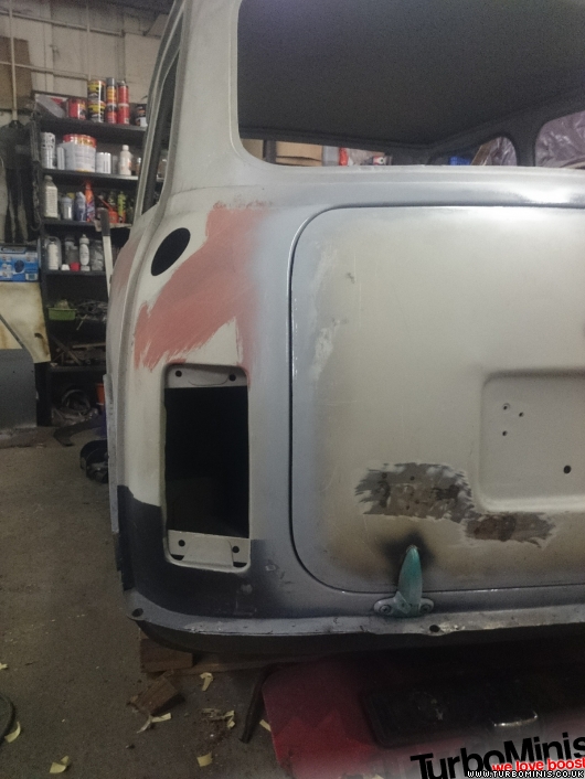

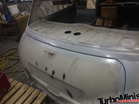

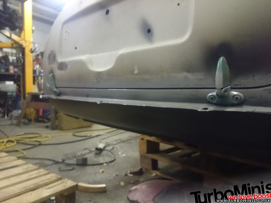

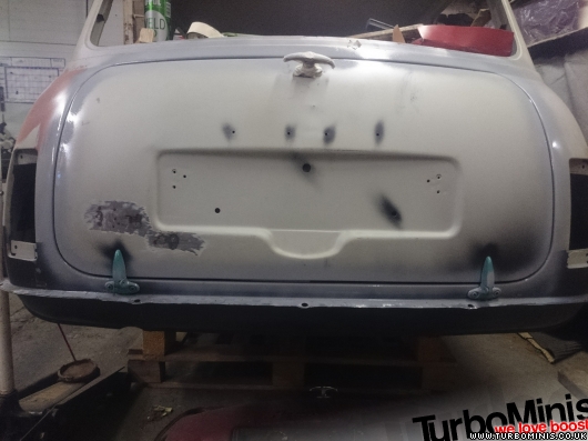

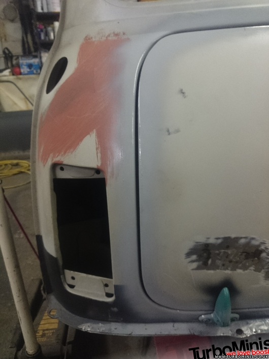

Been working on the bootlid recently, it required a bit of brute force to twist it slightly so that all the corners seal fully on the rubber. Then i started to even out all the gaps as they were all too big, could fit my fingers in the bottom.
Before
After
The bottom gap now looks a bit tight in the middle so will double check that tomorrow, might just be the light. Shouldn't be much more welding now
