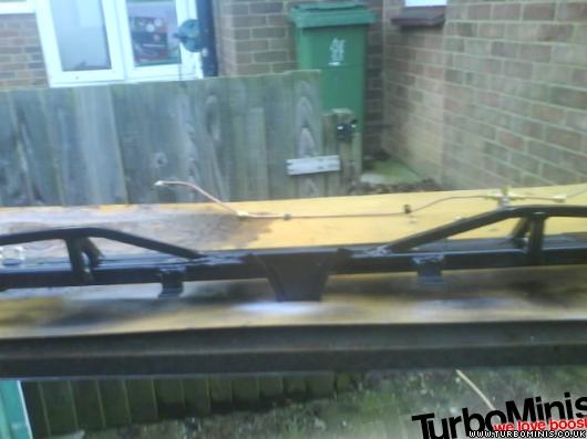

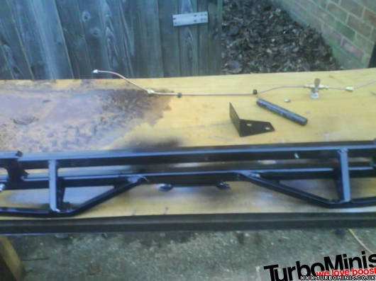

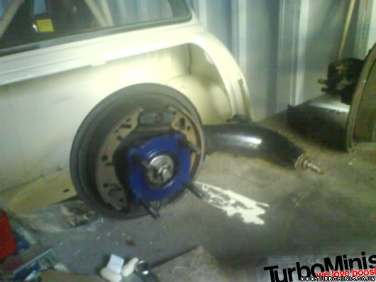

A bit more progress made over the past few weeks. Ive got the raduis arms built up and fitted my new hubs. :)
And yes I did get a bit excited when I opened the box with my hubs in! *hehe!*
Then modified my shuddersfield beam so the exhaust can sit in its normal location. Its pretty much ready for bolting on now!

the hubs look awesome, what a bargin. its gotta be a lot lighter now the knobs have been chopped off lol
Haha, you can feel the weight difference! :)

A few more progress pics...After everything is back on im quite happy that I can now pick the back end of the car up, especially as I struggled to raise the suspension before! *happy*
Strengthened the L shaped brackets....
Beam fitted back on...
Looks abit odd without a rear valance! I need to try and make my diffuser fill the space but at the same time not look too fast and furious...any ideas?
