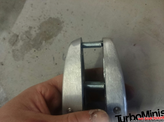

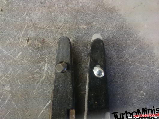

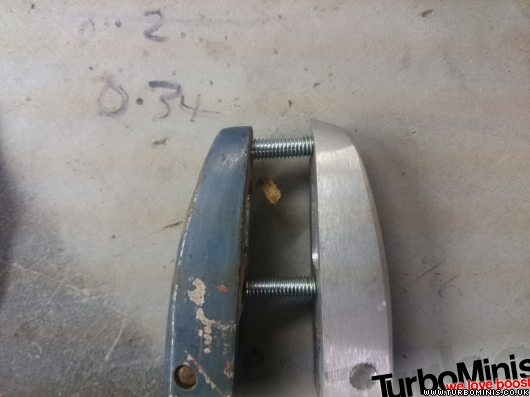

Another small job sorted. I bought a new set of alloy door hinges and they are a lot tighter than the first set, but the profile of them isn't quite the same as the originals, they are too long and pointed.
The gasket shows how much longer they are.
So I filed them as best I could to look like the originals. Heres how they look now compared to how they were

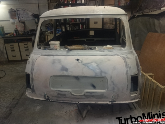

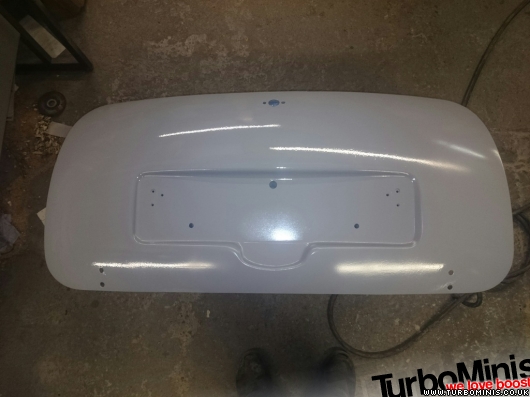

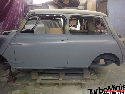

Time for an update. Made a start on the bodywork last month, not done this before so it's taken a while to get the hang of it. Started on the rear and I'm just working my round it. Pulled out as many dents as I could on the bootlid before the filler went on.
Gave it a coat of high build after this with a guide coat, couple of places needed a bit more filler after it was flatted back. This is the second coat of high build which i finished flatting tonight.
Looks ok but not sure how it will look with the topcoat on, time will tell. Moving onto the side next

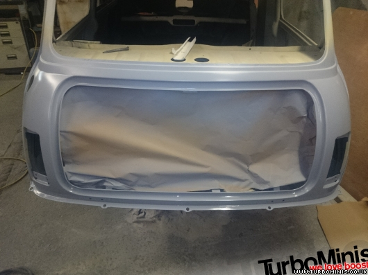

Still carrying on with the boring stuff so not an exciting update. Finished the filler on the passenger side up to the swage line. Put the high build on last night. Still need to weld the drip rails on so will sort the top half once that's done

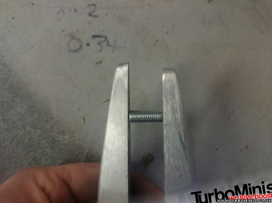

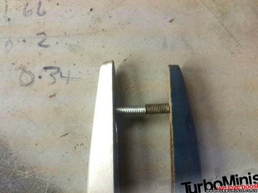

I fount this with the alloy hinges
Callum
450 Posts
Member #: 10396
Stoke-on-Trent
Glad I wasn't the only one then, minispares told me no one else has had issues with them
I have a new set to redo in the next days..
I only seen it when I was like you fitted the gasket. Thought that don't look right.

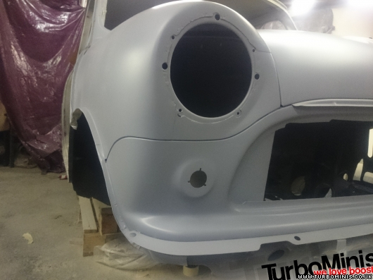

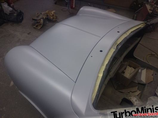

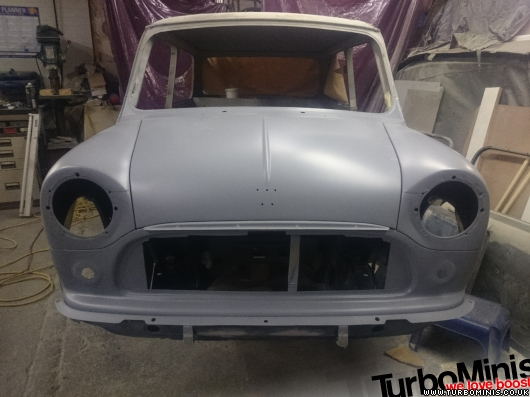

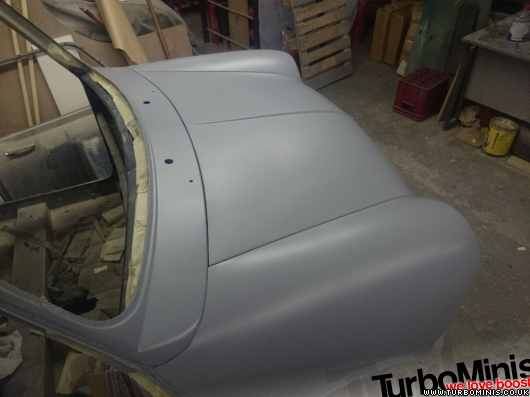

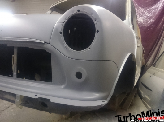

Not had much time recently, busy with work and a weeks snowboarding but the front end is finished now. Epoxy primer and high build went on yesterday, made a start on the drivers side today.
Edited by Callum on 23rd Jul, 2017.

looking good mate

Ooooof... does look good!!

Those panel gaps are perfect!
Thanks. Nearly everyone that's seen it so far said I have gone too far with the gaps because 'its only an old mini and they were shit from factory'

That just makes it even more impressive, I do suffer from panel gap envy though as my car is really rough in that department.

I hate to say it now, but aren't the blanked wiper holes supposed to be the 2nd and 4th (from left to right in your photos) not the 1st and 4th?
That's a very good point Ben,
Callum
450 Posts
Member #: 10396
Stoke-on-Trent
I don't think so mate, pretty sure it's the outer two holes that need blanking. I will double check with the original scuttle though.
Rammie2000
1751 Posts
Member #: 10190
belgium
If it has the wiper system like my mk 1 its very narrow and can indeed be the outer holes.
jonny f
2096 Posts
Member #: 9894
Dorking
Mk1 have equally spaced wipers don't they?
Although this is a mk2, not sure what wiper it would have originally!
Callum
450 Posts
Member #: 10396
Stoke-on-Trent
Cheers rammie and Jonny, it's the same wiper system as a mk1 so going off what you both say it's correct. I was worried I had cocked it up then.
