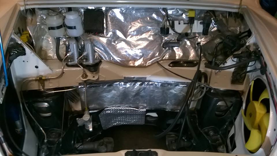

Here's what I did...... I used the generic remote reservoir master cylinders as the wastegate actuator was hitting the standard clutch master cylinder plastic reservoir, and the tandem master cylinder was getting in the way of the boost pipe.
You could mount these reservoirs any other place out the way. Like I said before, there isn't much difference between the dual circuit or the single circuit as all the braking is on the front, so if you still only lost the front circuit, the rear is doing pretty much nothing anyway.

Bit of a struggle but it worked! Can't see any reason why it can't work like this once I do new brake lines
proper job !
thumbs up!
That's interesting! I swear blind when I tried it that the brake master fouled the clutch master, but it was three years ago and a lots happened since. Something deffo didn't work for me, but I still have the original bulkhead.
Looks like it'll work. Easy fix!
That certainly helps things.
Did you manage to do it Joes way?

Yup. Avoided the dreaded pins job!!! Was on the limit of travel to clear the locating bolts but both made it. I think all the hard lines should fit without making new ones too *smiley*
