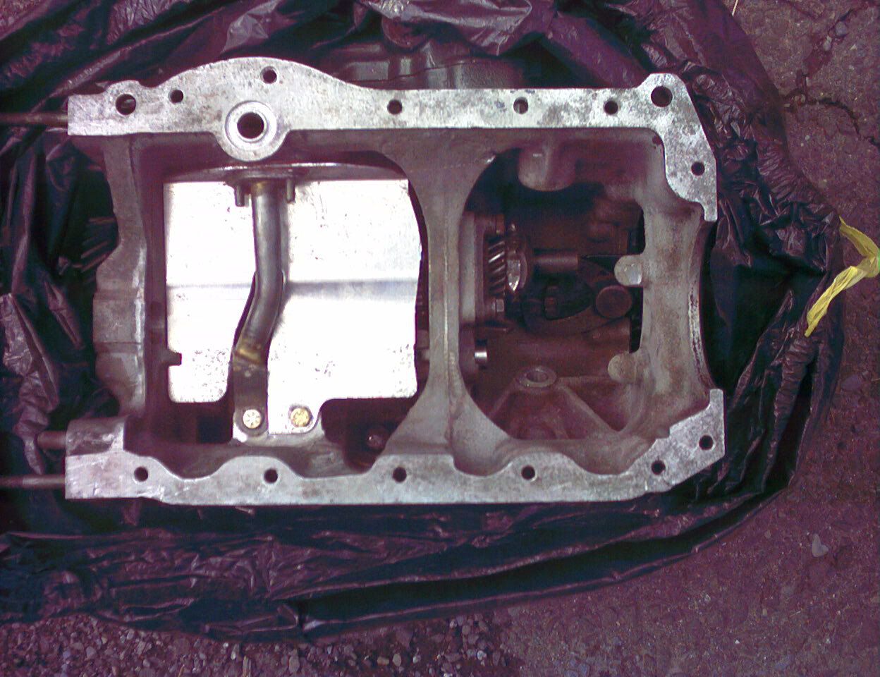

I have made on for myself, that is pretty similar to the minimania style and fits a remote box. I have mounted that by drilling and tapping two holes, one in each corner of the box on the same side as the mainshaft. Then I have mounted it to the bolt fastening the CPU. Thats all and the aluminium is pretty thin (1.2 mm comes to mind), still it has been okay for the last two years in my 1191 cc engine.
Its made after Marcel Chichacs (sp?) drawing.
edited for picture:
picture:
Edited by miniminor63 on 25th Oct, 2006.

That's what's so genious. Simple and effective. Why have a fancy overenineered plate down there? It works.

I agree on that, I can not see a point with a plate covering the whole box really, eventhough I have made mine like that....
