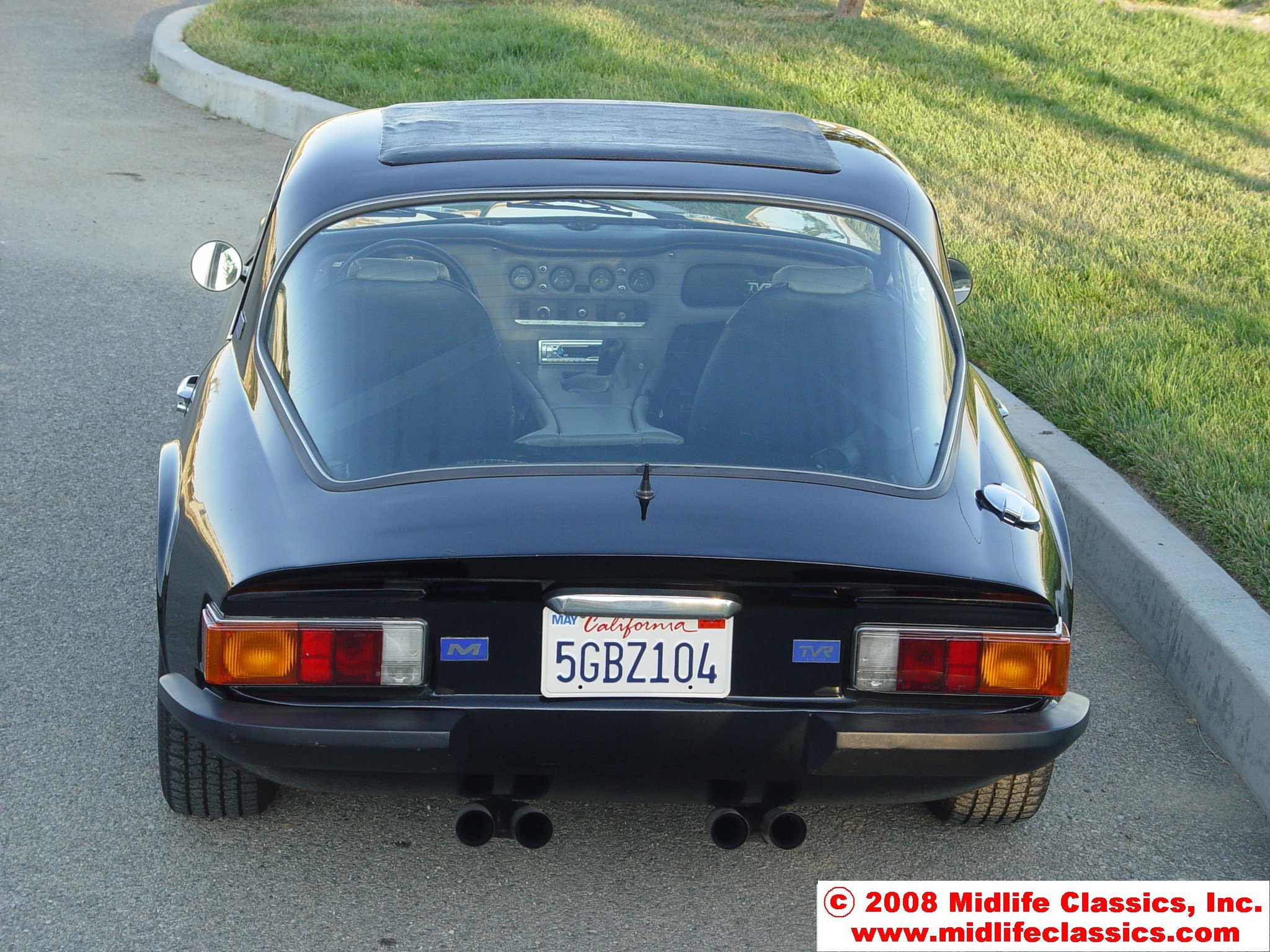

thanks paul , it would originally have looked a bit like this before i built the arches and smoothed it off ..i cant find a pic of a 72 m series , mine had those 3 row cortina lights .
oh pooh pics changed ,TRY THIS ONE
