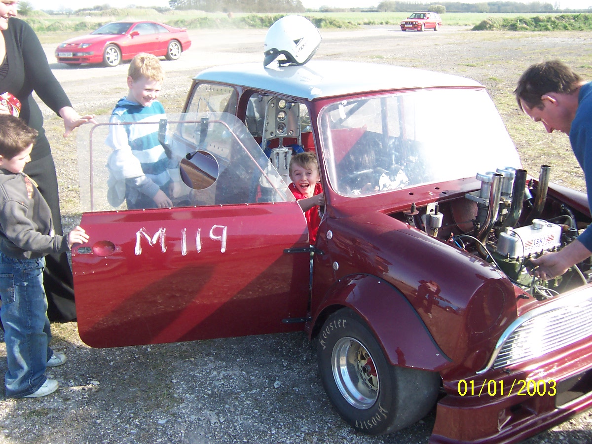

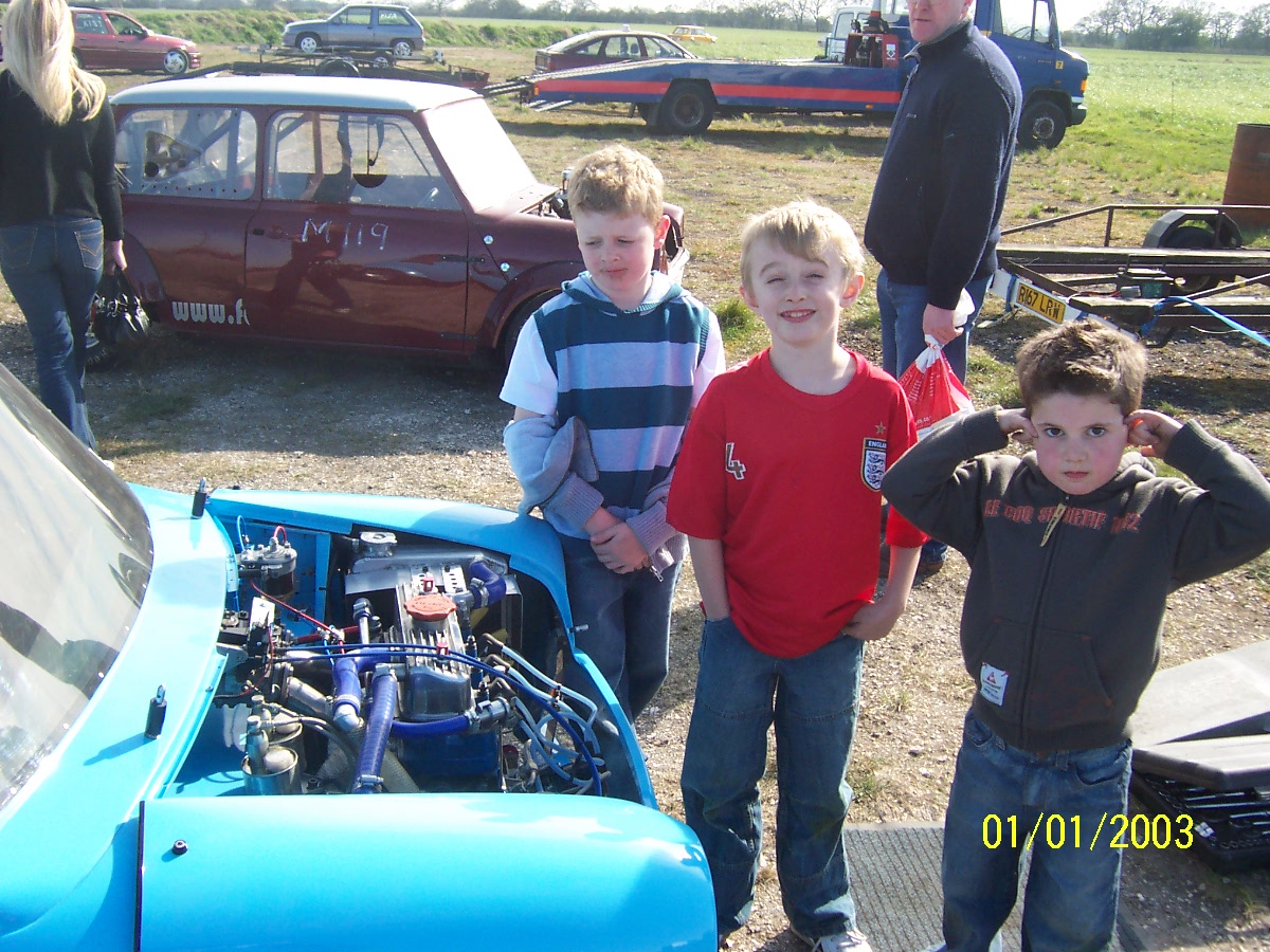

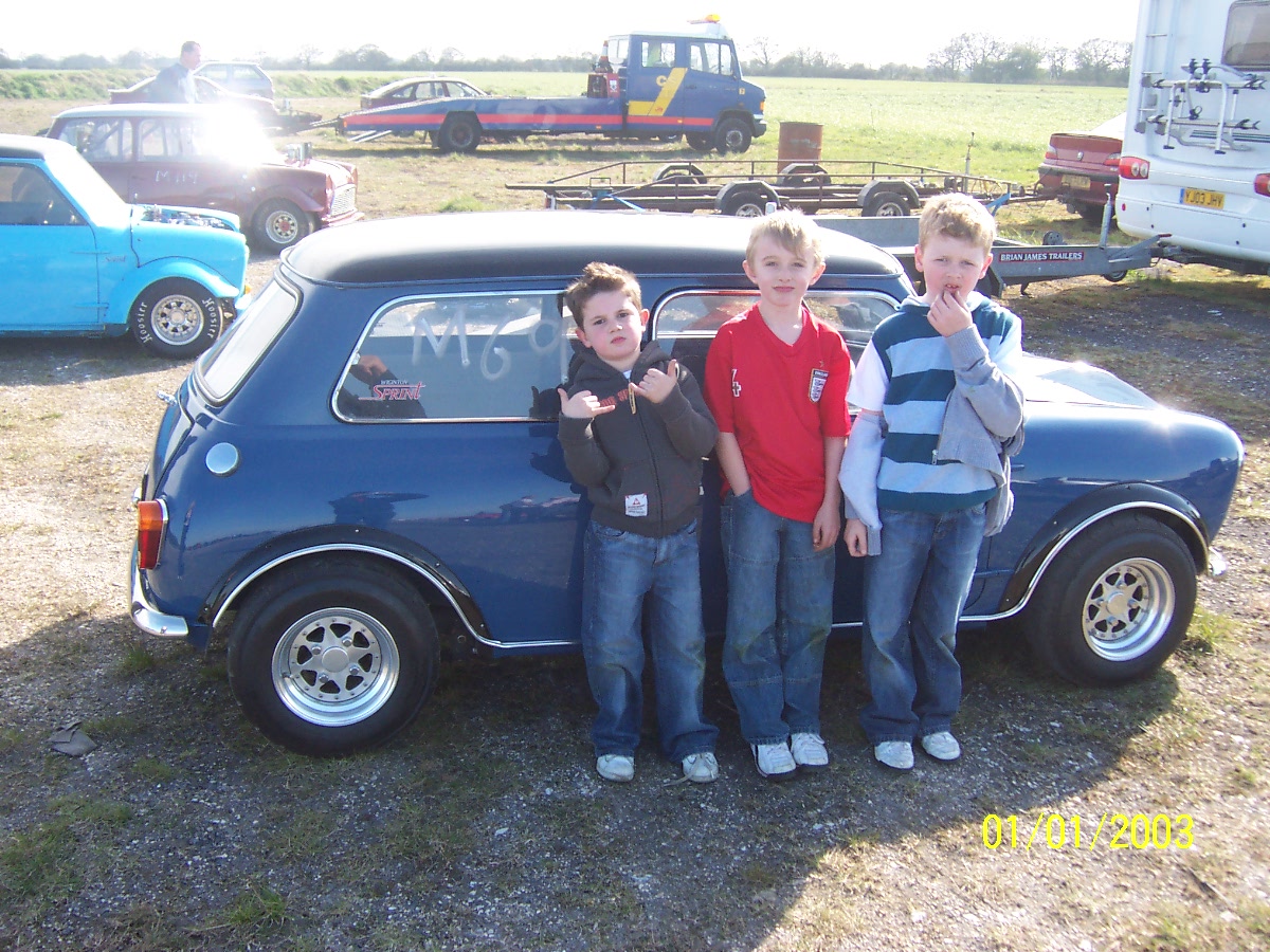

Regarding Minis I have attached three photos of what I considered the best performing, best engineered and best prepared. (sorry about the sprogs in the pics)
