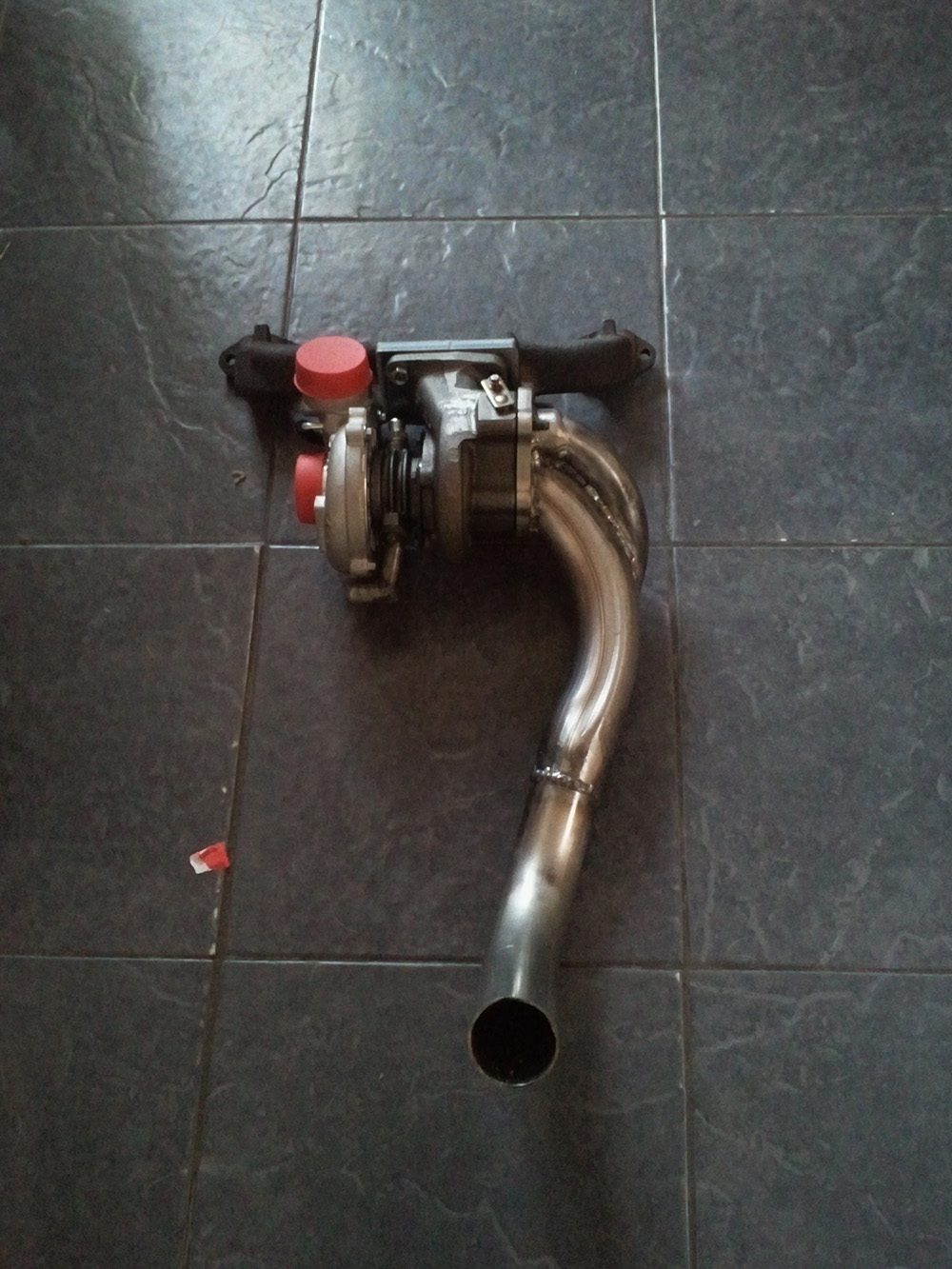

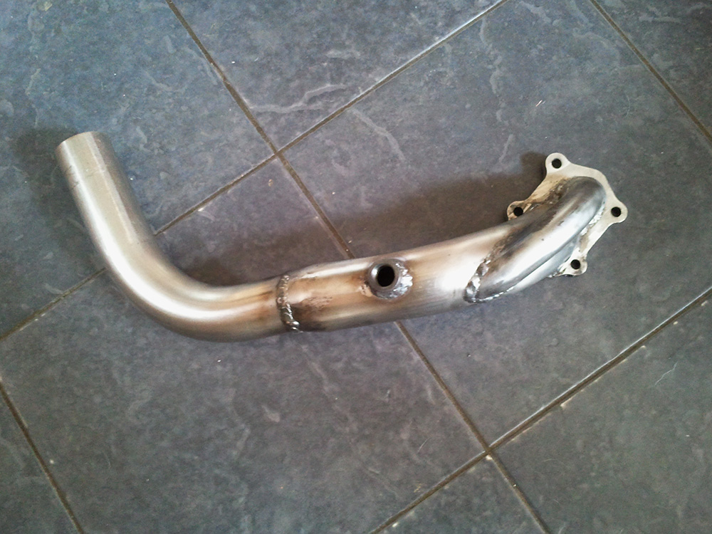

I'm now intending to weld in my boss on the downpipe, does anyone have a picture of where theirs went? Don't fancy putting it in the elbow to be honest so going for the downpipe. I haven't got a setup on a car to mock it to so I can't see where is a definite no etc!

no but mine is where the bracket goes to the gear box just after it. Which is in the centre of the bend as it goes into the tunnel
Craig
Craig
mine's just after the bend underneath the car,fits fine,
the one thing id recomend on these manifolds is cutting out a section of the downpipe and fitting a stainless flexi as they have no give unlike a metty one.....

Thanks for all the replies, Rod S, does yours give accurate reasons from that distance? As Pedro said underneath (and I have heard before) that is should be mounted closer to the engine?
I'd rather weld the boss into the link pipe rather than the manifold to be honest!

I tend to believe the bosch motorsport info more than the others. Basically the rule is as I thought. Run it as hot as possible within it's prescribed limits. So dependant on your max EGT, which varies a lot dependant on your engine spec it can be close, or further away from the turbo. No simple answer as usual.
