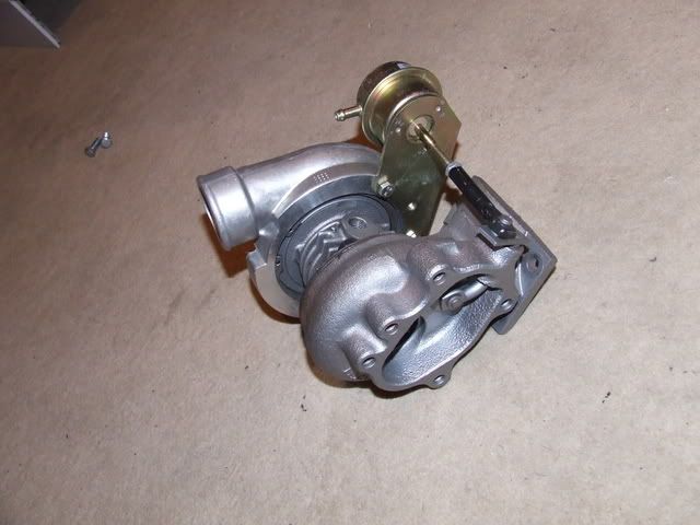

i'm pretty sure that the turbo keans got is the same AR wise as mine but without the finned core. No idea what his is off either though, lol.

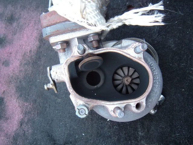

One last check then - take a picture of the flange that the downpipe would go onto - showing the bolt pattern and turbine blades.

this is about the best one i've got at the minute. hopefully be sorting the oil feed at the weekend so i'll grab a proper pic then.

here's the exhaust side of it then. just waiting for kean to get here with his verniers and i'll measure the diamter of the wheel.
Well, if it's is 11-blades, then it is a T2 or T25...
The 'downpipe' bolt pattern is definately for a T2 though...
If you measure the OD of the turbine - 47mm is T2, and i think it's somet like 53mm or so for a T25.
This'd be interesting, if only to see if it is a T2 / T25 hyrid, or other...
Although the the 11-blades and bolt pattern make me think T2

should soon find out then.
as an aside, just found that the oil feed is M12 std (1.5?) not the 1.25 fine thread. Now i've just got turn a normal m12 bolt into a banjo and with any luck it should work.
