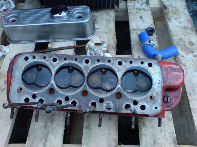

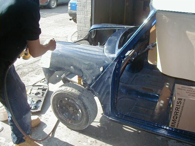

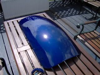

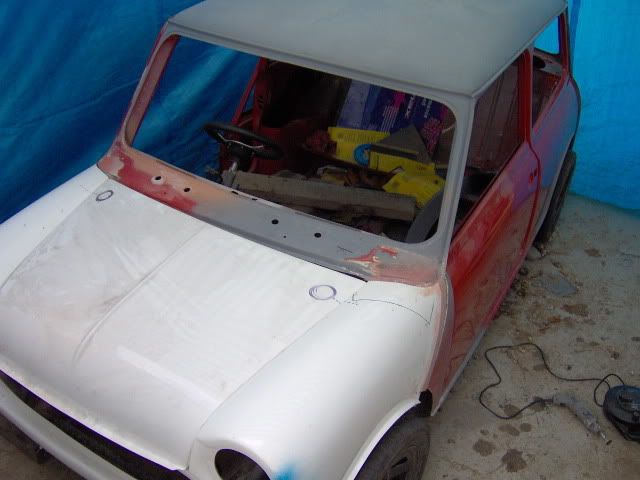

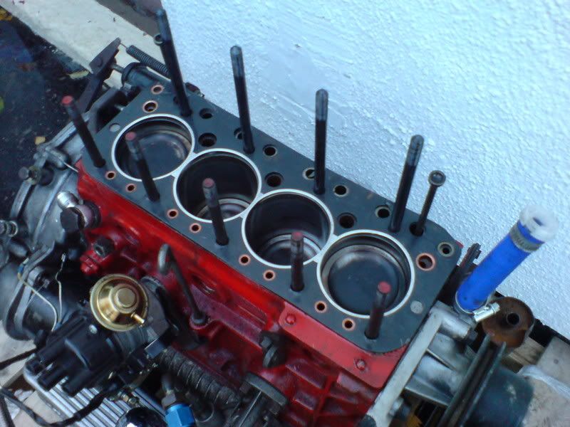

Right the next few pics are a sort of timeline of from start to where I am now. Saves a lot of you trying to scramble through tmf. Warning lots of pics!
that about it. Told you there were a lot of pics!

4309 Posts
Thats a very nice car, a real pain about the neighbors roof, was it just a case of skillful panel beating to fix the roof?

aye some welding, pulling and panel beating was required to both the roof and rear quarter. ended up that i had to fork out for the work, but thats life. the ic is from a 200sx, i think an s14.
