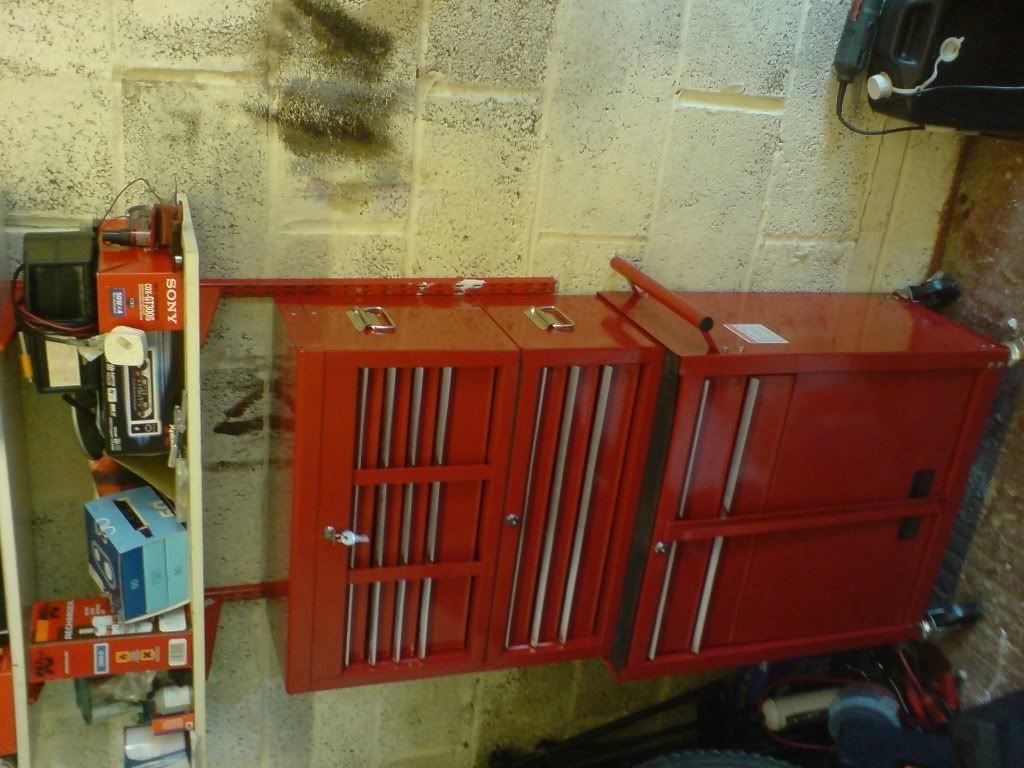

cheers, a bit ot, but i got fed up yesterday with my tools being all over the garage in different shitty plastic boxes, so i got this..
much better! now all my tools are safely locked up in one place!
Dan :)
