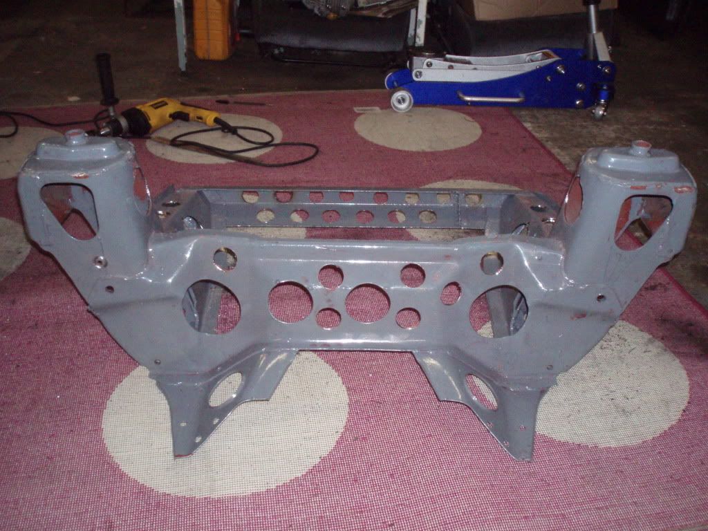

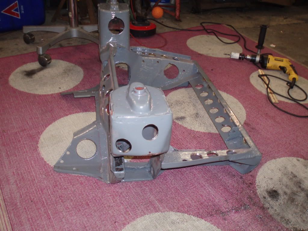

Well I had an afternoon free this week.
And here are my results.
What do you think.?
Sorry for a photos being a bit out of focus. My hands were still a bit shaky after all that drilling.
Also seam welded tower tops and front mountings were the tie bars fit.
Si
P.S. Not weighed it yet mind. But it feels a fair bit lighter. *happy*

and i thought mine was looking a bit swiss!

looke a top job, i'm impressed,

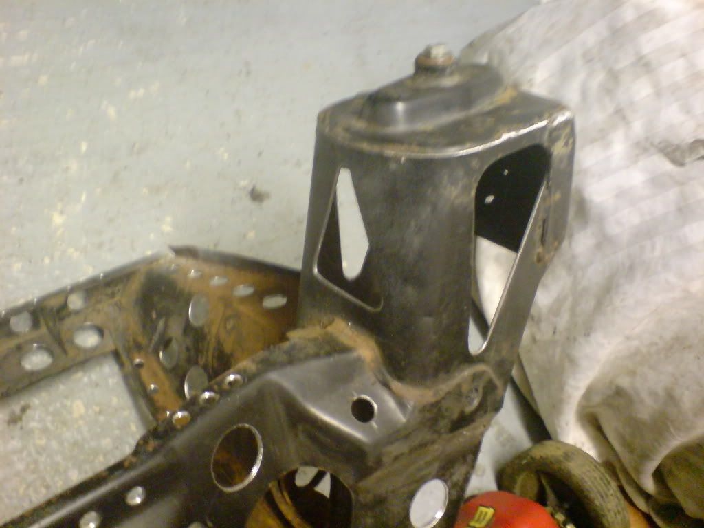

I love the way you have made the holes in the towers bigger, very neat. I had to look twice to see what you had done. I need to do something like this at some point.

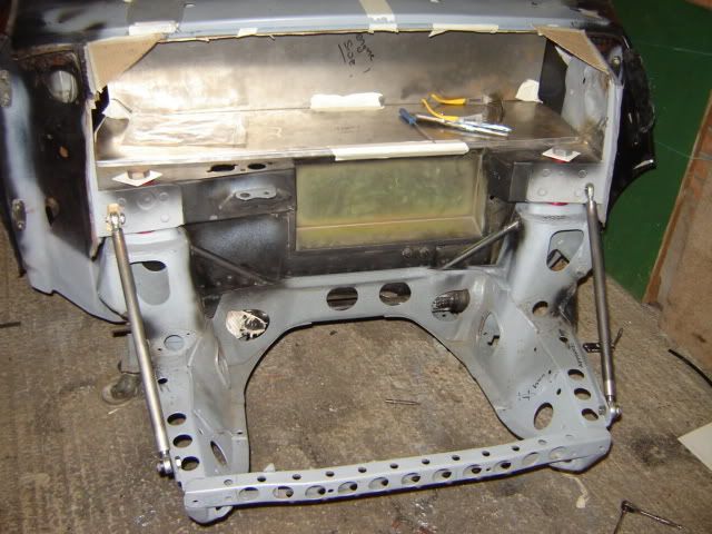

really theres alot that can be lost from the front frame, lots of holes & seam weld it, add some triangulation bits here n there, may have a bash at this
permission to steal some of these ideas *surprised*D ??????? good work there chaps

awesome!!ive been looking for some pics to go by,il be doing this soon!
any body have rear pics??

Ben H- Yeah, I gave it a whole lot of looking at before I got stuck in. worked out quite nice.
I tried to leave all the double skin areas alone. But thought everything else was fair game. Kept everything in symmetry to,to try and help with any stress which might occur.
If I ever was to convert to coilovers, you could probably take a bit more out of the towers, I think.
Matty- It's at the shot blasters at the mo. When it gets back i'll do a weigh in. And I have a clean standard subframe to compare.
clubminiflip - Help yourself mate. Thats whats this forum all about. Is it not.?

it looks very good but how much lighter is it?
do yourself a favour and enlarge the driveshaft holes too

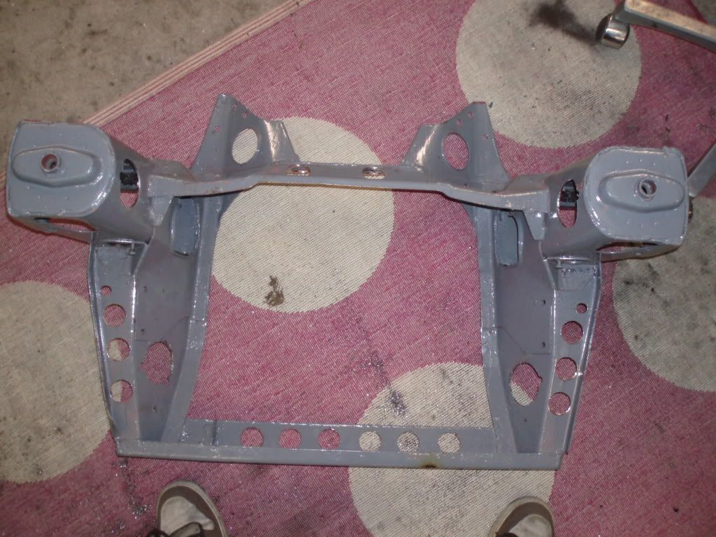

Sorry I never got round to weighing it in the end.
But, It was much lighter compared to the standard one that came of off.
Sorry for not a more accurate measurement.
But all I can say is it was worth the effort.

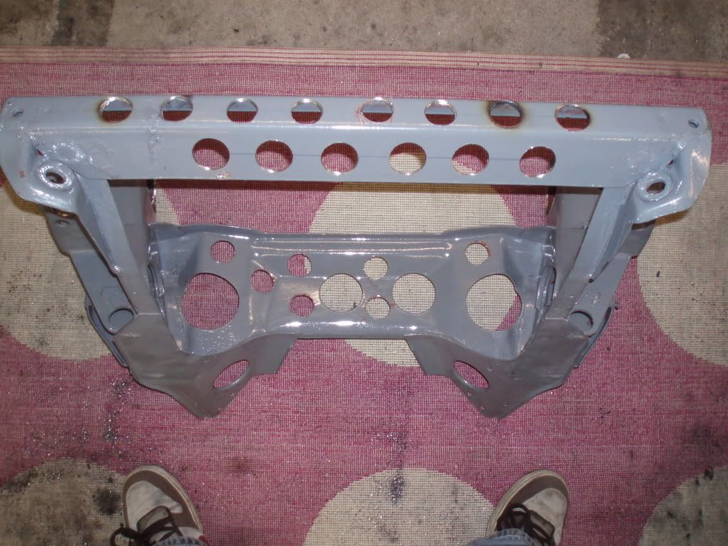

Looking at it again in the pic's. I could have easily taken even more out of it I recon..?
O well the next one will have. *wink*

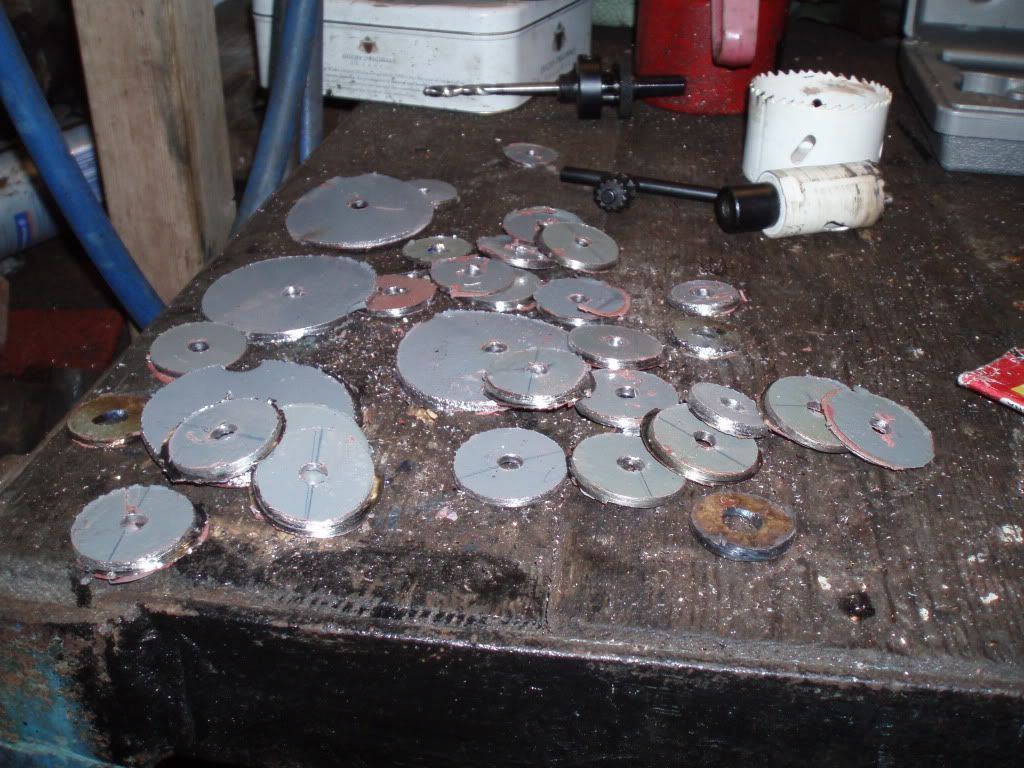

had a bit of a sesh with the holesaw today, kept it quite conservative as im not after every ounce just yet:

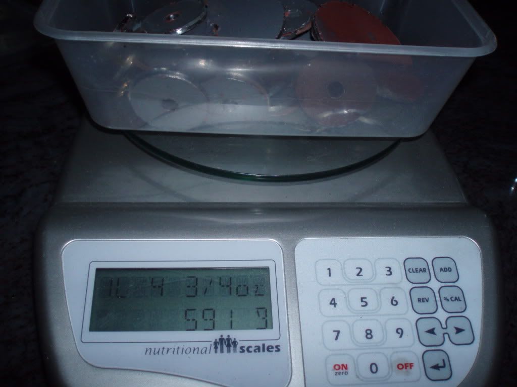

didnt have any scales handy at the garage, but collected all the bits as a rough guide:
591g's, so prob just over 600g's removed
looking good!
actually i'm suprised it was that little.
cheers, me too, i was hoping it would be about 2 stone haha
i would have guesed just over a kilo.

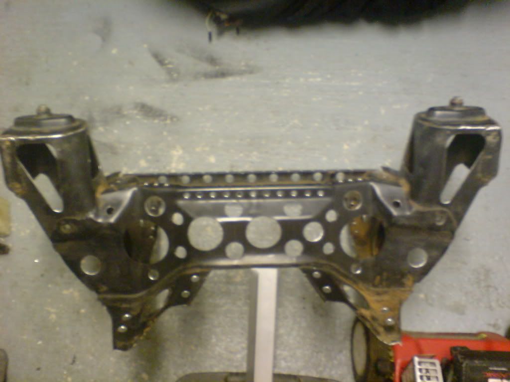

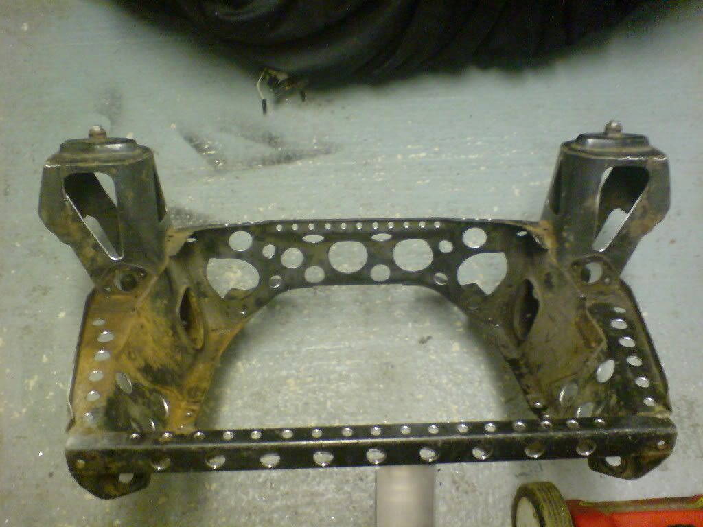

I got just under 3kg off mine.....keep going guys
Paul
That's scary Paul! I guess there are no pics.....
No pics james. I run it for 4 years like that - no issues. Its not on the car anymore though, Ive gone 6.5kg lighter still.
Paul
Keith Timpson
87 Posts
Member #: 3104
Paul, so a total of 9.5kg lighter than a stock front frame, thats got to be titanium then?
