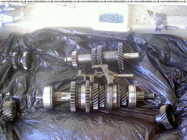

Anyhow..i was going to make a new post. what sort off gearing is this ?
I was told this isn't a A+ BOX ? THEY ON ONE, or they right... what sort of box is this.. cheers :)
it took me a while to work out haow to post them too....
what you need to do is go to he album where you have uploaded the pic then clic on the pic to open it so its big, then right click and select properties, and copy the link on the properties page, paste this into the message and put [/img] at the end of the link and [img] at the start.
to me it looks like a A series box ( pre A+) the slightly flat tops to the gear teeth give it away, also the idler drop gear will have a 5/8" shaft rather than the A+ 3/4" shaft.
dont panic though, nothing wrong with the A gearbox, in fact some reckon its better.

I may be mistaken but looking at the picture above I would call it an A+ gearset...
LOL,
I jus had a look at a couple of boxes in the garage, I have an A+ box that looks just like the above one,
I'm sure I remember the tops of the gears being much more pointy on the A+ gears, Guess I must be getting old!!

So if that comfirmed then,
I have A+ Box then ? *tongue*
icklemini
100 Posts
Member #: 745
Northampton
A+ box...

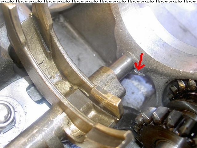

On 2nd of Aug, 2007 at 09:55am Vegard said:
No it isn't. It also looks as there might be a crack in the casing, but I cannot see because the picture is so shite.
Why not let the autofocus settle before taking pictures????
Your right m8, it has a crack in the casing.. what a tosser..
Could it be welded, or that mean new casing....
When it rains it rains :(
Cheers lads
new case
welding may or may not last, but would you risk it?
PS: saves trying to get the selector shaft out, that would have been a bugger

It's only cracked abit where the shaft goes into... it can still work, surley they wouldnt be alot of pressure on there ?
new case it alot of dosh ? *indifferent*

you *sure* its a crack and not a casting flash mark?
A+ have a notch in the middle of every tooth

Here is a pic http://www.turbominis.co.uk/_photos/random...os/678/3961.jpg
as i was placing the new rod in, thats when i noticed it. the crack goes in about 5mm. can i get it welded, or will it be ok ?
cheers
As that shaft does not slide in the casing I wouln't be worried about welding that. A good aluminium weld is just as good as the rest of out shite casings.
Just to confirm, that is definately an A+ gearset.
