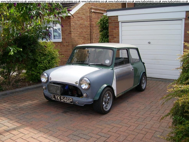

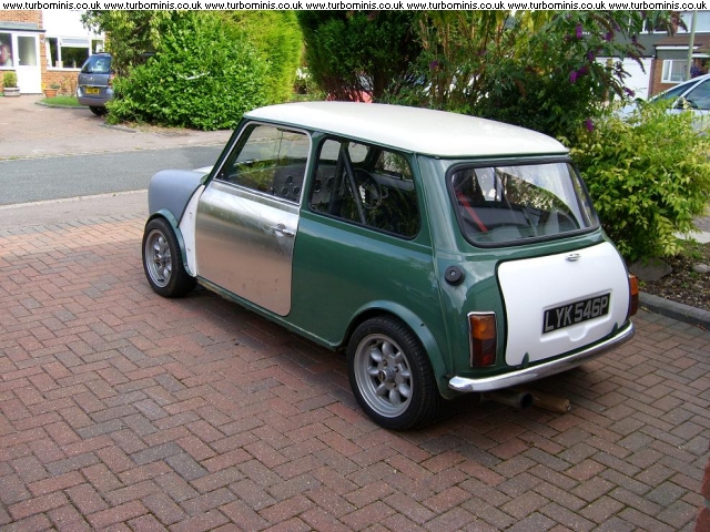

yeah im really impressed with them. the quality imo is pretty good. the outer skin fits pretty well and with some kind of door card to cover where it has been chopped on the inside and it would look really smart. its certainly something you could do yourself though if u had the time/patience and a decent set of doors to start with but as an off the shelf item they seem really good.
right car is finished now (although slightly multi coloured but paint comes later!). its been a long week but im pretty happy with it at the moment. there is still abit of work that could be done to improve the fit of everything but this can be done over the winter.
the lexan sliding windows for the doors weighed in at 1.4kg for each door so in total on the doors i have saved nearly 14kg a side, which isnt too bad atall.
other things removed today:
front bumper: 2kg
passenger seat: 10.6kg
passenger roll cage door bar: 2.8kg
aluminium floor plates (in footwells instead of matts): 2kg (each!)
fire exstinguiser: 1kg
can of oil in rear pocket: 4kg
chrome fuel cap cover: 0.6kg
i got bored at this point at stopped short of taking the heater out and decided to call it a day!
so total weight saving....... 78.8kg
quite happy with that, short of my 100kg target but that may have been abit optimistic! no more rusty panels anywhere on the outside now aswell which is a bonus!

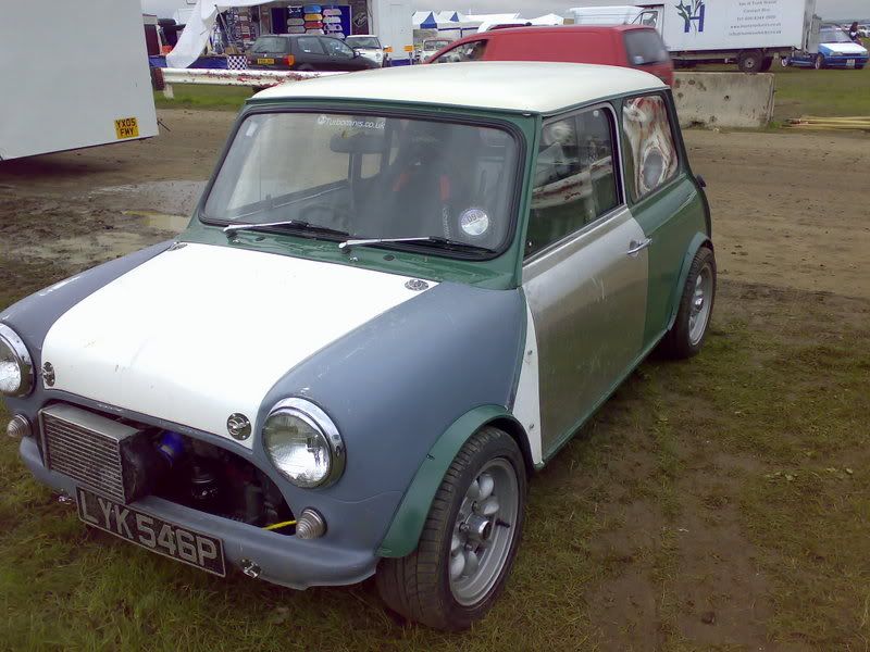

saw your car at mitp wes, very impressive, goes some too. How well did you do?
133.5 bhp 123 lb torque 116mph @6640rpm 9.5psi
