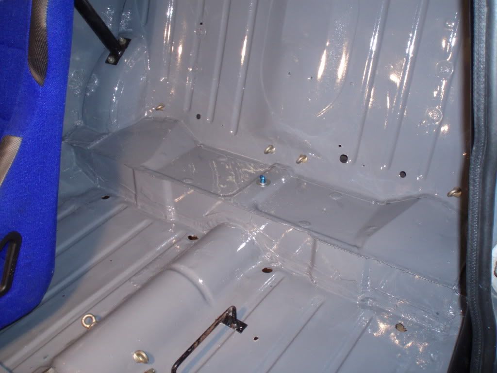

Right, lent my tank to a mate to have it copied, said he would have it back to me in 2 days and its been a week...groan...so not been able to get much done carb/engine wise, so got stuck into the bodywork/interior.
Got all the exposed inside seams all tacked or fully welded, repaired a hole in the floor, and given it a grey-licious lick of por 15 (dont laugh at my welding haha)
Its makes a hell of a difference having the inside all nice and clean for a change.

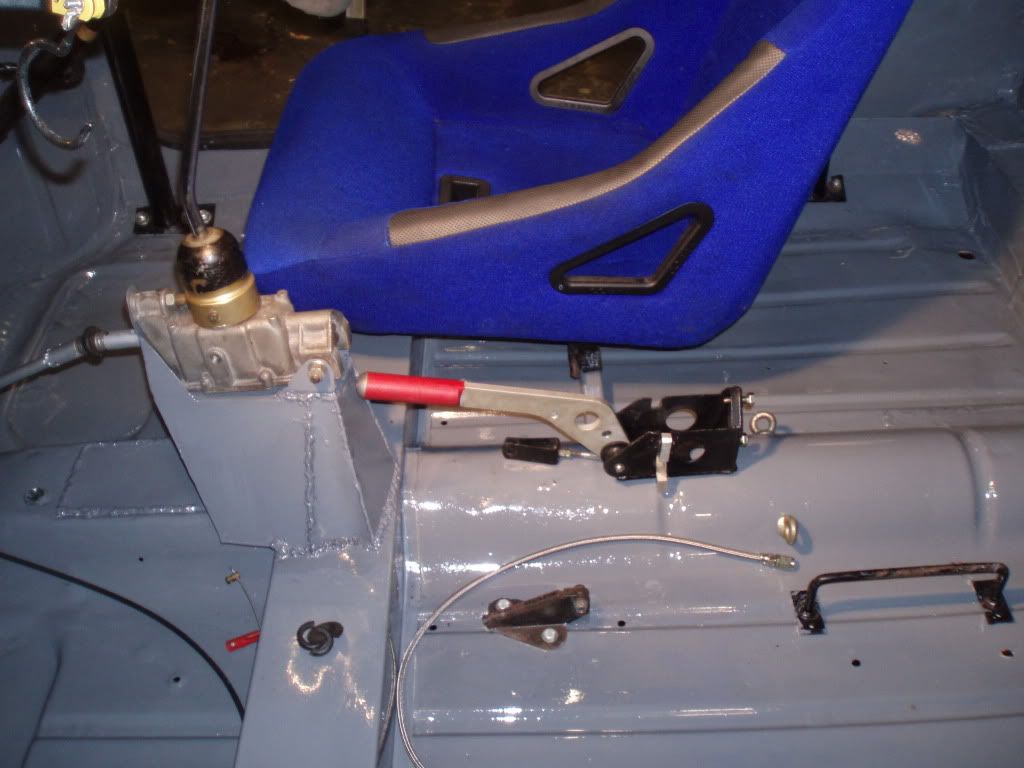

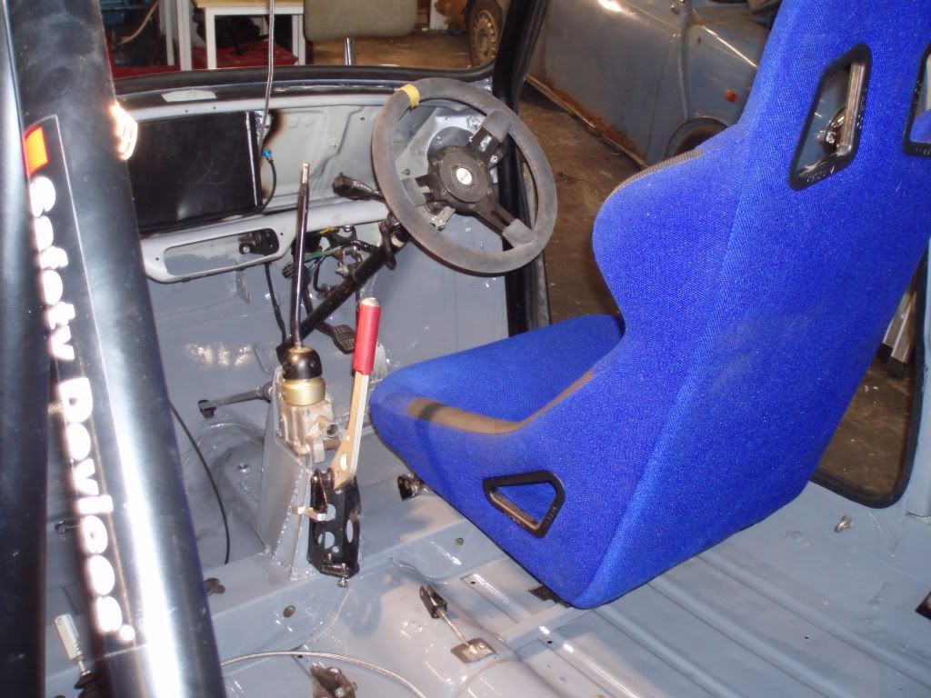

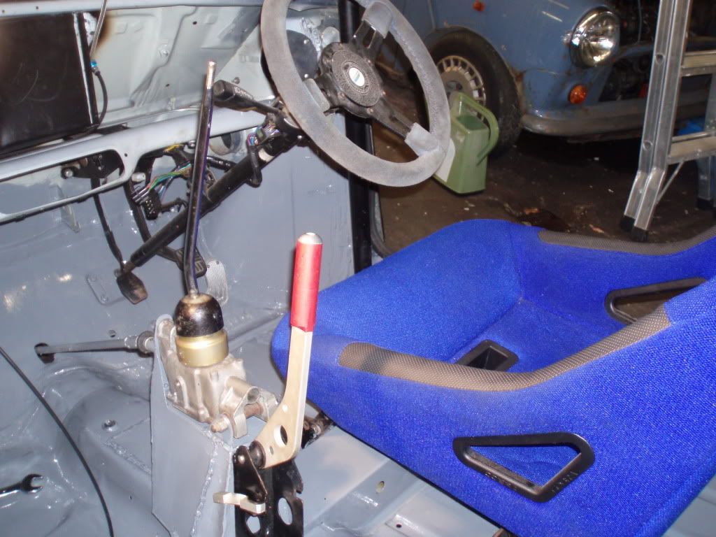

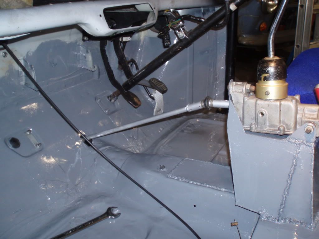

Now ive got a hydraullic hammy, im not sure where to mount it, in the usual place:
or on the back of the gear mount..
Not sure how much travel these hydraullic things need, and I will only get a comfortable inch of movement with it mounted vertically before my arm/elbow hits the bucket seat, do they need much throw?
Cant wait to give it a good pasting!

Joey, In the second picture down, it is worth fitting a plate to join the B post to the sill. As you can see there is a gap which is normally supported by the bin, which you have removed.
A couple of small plates will put the stength back.

wow! how high is that gear change !
I would think you can get away with the handbrake vertical,
I havent used one but as its hydraylic i would assume that you can adjust it so that its very muchlike a brake pedal, ie no much movement as there is no linkage to speak off.
anyway, it wouldn't be the end of the worlt to move it.

the gear linkage is a little on the high side right next to the steering wheel, so might ditch the kad q/s for a slightly cut down std stick, the throw between gears at the minute is ridiculously small
i decided to put the handbrake in the conventional place as when i was sat in there it just fel tmore natural, even it it is a mile away from the gears LOL

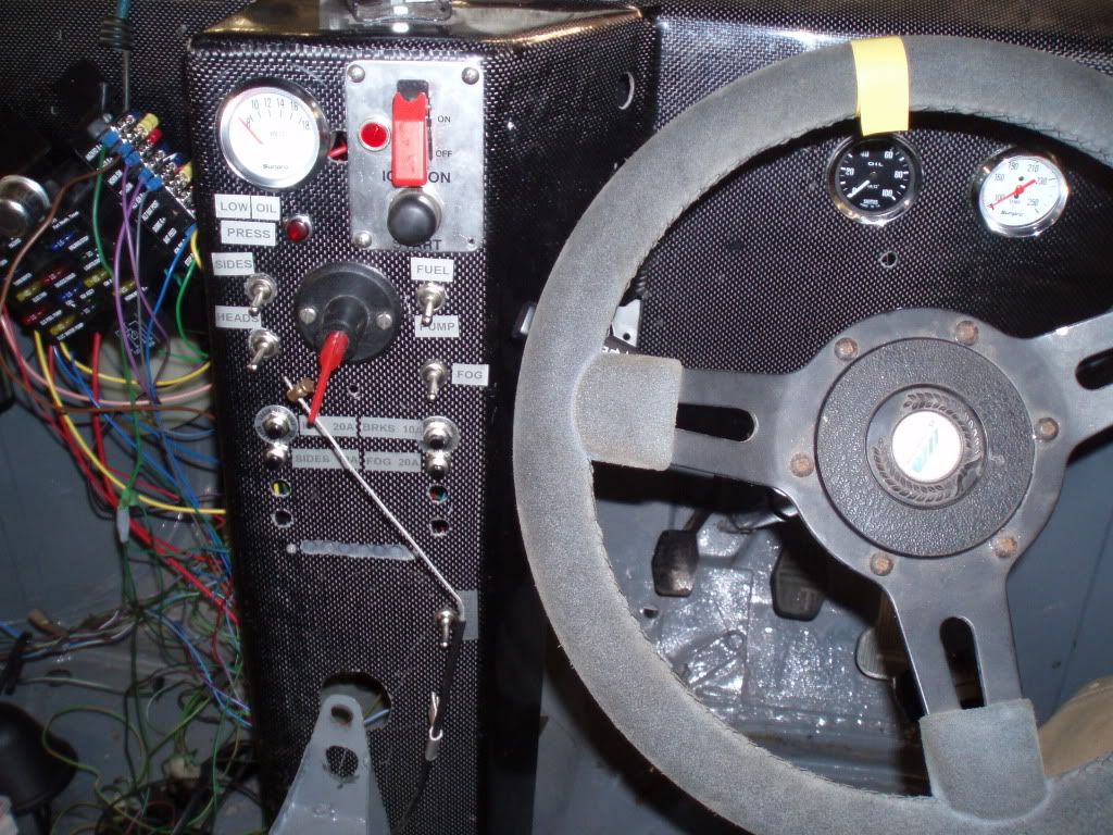

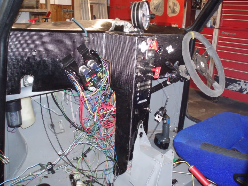

its been sat wanting some wires thrown at it, and with wiring being my most dreaded past time, ive quite happily let it sit there for 2 years haha
anyway the other week i had a bit of spare cash, and decided to use it to get this bad boy on the road, bought a load of wiring bits and bobs, and since then been mulling over how to set about
throughout yesterday and today ive managed to wire up pretty much everything to get it road legal (bar hazards grrrr) its genuinely been the most productive 2 days of my life, and ive learnt a massive deal, and actually found out i really enjoy wiring lol
first i took the original loom, completely unwrapped it and separated it all out ont he floor, mapped what i needed, what i didnt etc, then replicate what was left up to measure
the painless wiring box i bought off iains mig came in very handy and it makes the majority of the loom 'plug n play' although the horn confused me no end and i spent a good hour figuring out that the horn sw needs to go to earth rather than live, but got there in the end
as it stands now, it starts on the button, all the stalk functions work, power is corrctly going to the sidelights and gauges, the dip circuit is working, main beam etc, so im a happy man, most of the loom is running through loverly pop out circuit breakers too :)
all that currently remains of the original loom is the steering column stalks, and the whole of the rear lighting is the origina;, ive just spliced it into the new loom behind the passenger dash
ill post some pics up once ive found my camera

made a bit more progress tonight, added a load of extra earths and untangled the loom a bit
before:
after:
once ive gone though all the connections making sure they are insulated and wont short ill wang all the wires up behind the dash out of the way

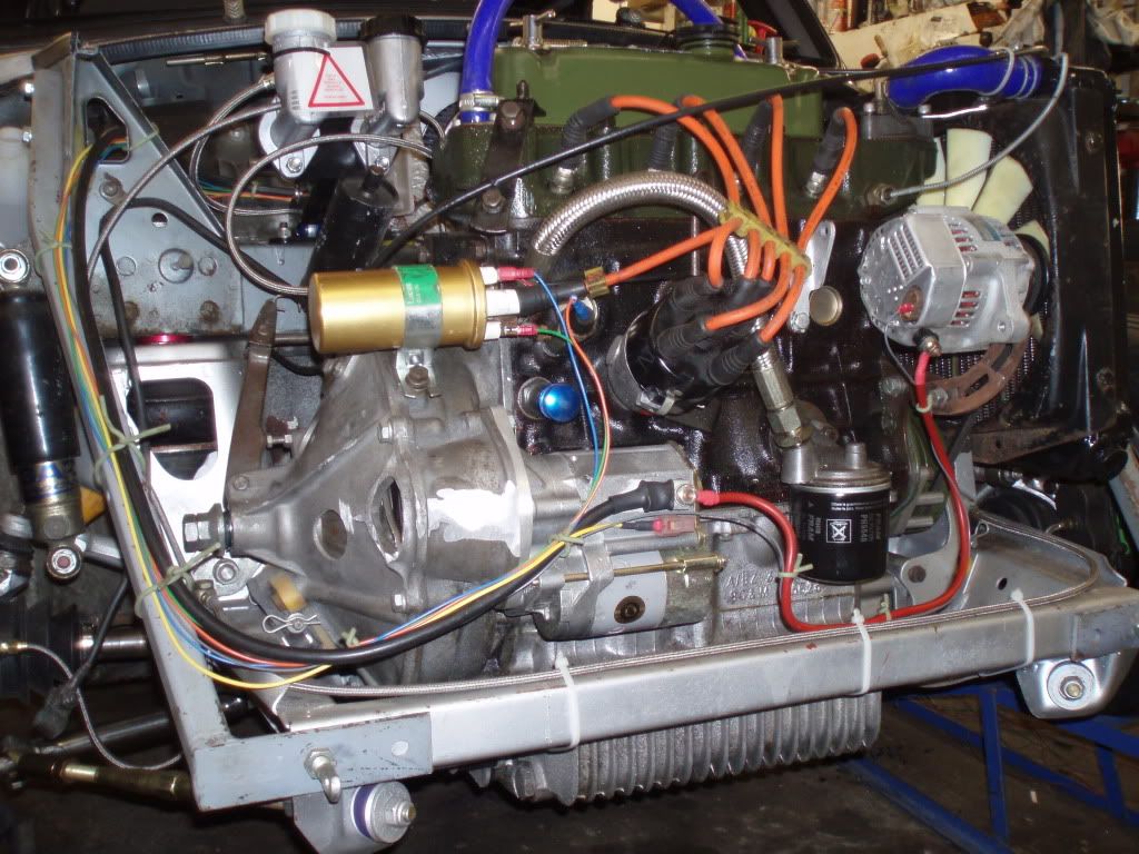

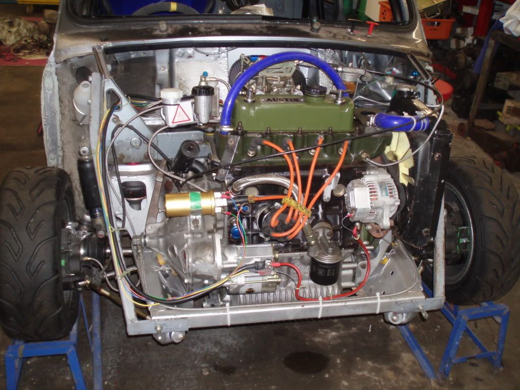

got some more up to date pics of the beast:
my nice new tank all plumbed in:
roung and ready dash:
