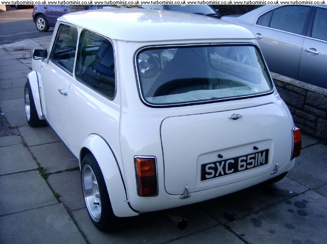

So, out of interest ..... how much has it cost you so far? I bet it's less than my fav spray gun!!!!!
It just goes to show what can be achieved if you try hard enough ... goo work fella!!
just the underside,interior, boot and engine bay to do ...... cheaper and more fun than gym membership .... look on the bright side ... LOL

Good effort. A friend showed me the same thing on retro rides, a guy did a volv 240 estate in brown and stuck some wood effect vinyl on the side. looked pretty good from what i remember. was really detailed on the paint mix and sanding and which rollers to use.

this is looking mint, and that 240 in the link is fantabulouso!

very impressed, looks great. Think of the cash you've saved :)

lol @ roger I know, should have done the interior as well couldn't bring myself to tackle it though, just cover it with carpet for the time being I think!
It wouldn't have happened if I'd had to pay to get it sprayed probably would've been sold for peanuts on ebay by now, stumbling across that link when I did was a real bit of luck. Lets see;

How did you get on with the scuttle to wing part in getting it all smooth?
Got any pictures of that bit?

With difficulty, lol. Can't say I'm all that happy with it at all. I'd tried sanding it in a way that left the seam visible but it didn't look right in the end I lost patience and just built it up with filler then smoothed it off. The only way to do it really is fill, sand, get some paint down see how it looks then rub back and repeat. I think its probably passable when you stand back and view the car as a whole and its a little more forgiving with it being white. I know its gonna bug me though. *angry*

well done top job with good results

That is a good result. loads of work but nice outcome.

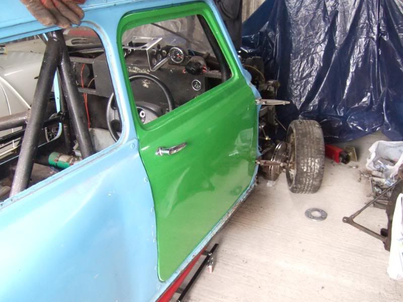

Probably work quite well, I've been getting some good results with green rustoleum on my mates car:
