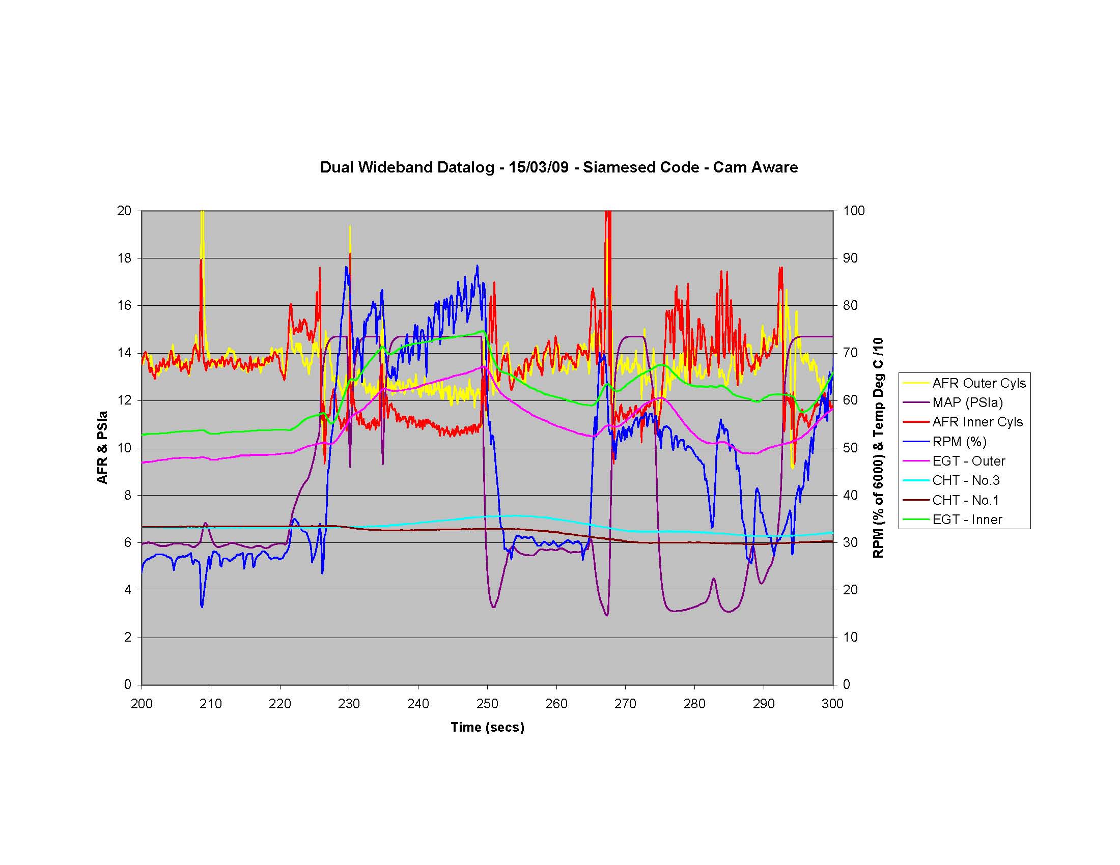

This is a log of data from a test I took in 2009:
Actual range is in the region 500-800 Deg C under load.
In the end, we worked out a way of using dual widebands upstream of the turbo, so there was no real need for the EGT monitoring.
The tests did confirm that the inner cylinder will always read a lot higher. This is due to it giving the average from 2 exhaust pulses, whereas the outer only have one. This was also subsequently confirmed by simulation.
As TT said, the probe needs to be as close to the valve as possible.
