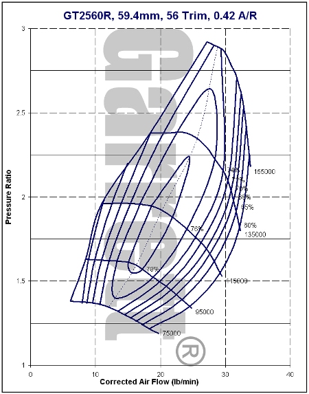

Well, this looks to me, like the best ever opportunity to de-bunk the myth of what exactly the Focus RS turbocharger specs are...
Why don't you grab a pair of digital calipers, and a camera, and take some pics of what the compressor and turbine wheels look like.
I understood that this was a very limited run turbocharger, that was developed specifically for Ford - witness interesting features like the unique turbine housing, and the compressor housing backplate with a larger diameter than the unit found on normal 2560's (at least two i've had my hands on from the garrett catalogue had the internal circlip like on T25's).
If you don't have measuring sticks, then someone on here will no doubt assist you...
