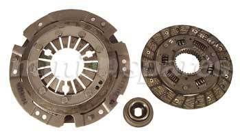

I actually have two or three differnt design in my garage now. The MS one liiks like this:
And was rubbish.
The one I have now used looked totally different and the spring part was much thicker gauge metal. It was embossed with 'VELO'. I have another one the same, so I'll get a photo and do some measurements, won't get chance tonight though.
This is what the goodun looks like
wil, i can't see the rubbbish one, please help i need to see it to no i'm not running one!
http://www.minispares.com/images/products/350/GCK151AF.jpg
that doesn't work on my pc either Dave, maybe it's my end.

Here you go then:
Tim Rowe
"Is est totus perfectus per fumi quod speculum"
GTM Coupe Turbo
cheers Tim, yes that looks different.
So now you can avoid running a verto Matt, hahaha.
