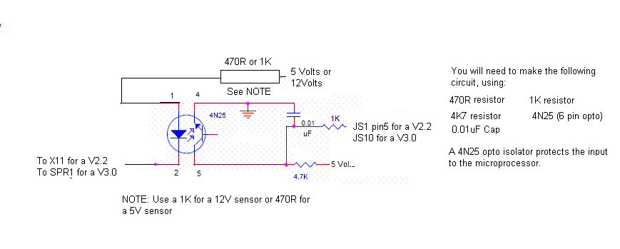

However, it is simpler to use the circuit as Jean suggested above, which I think was my plan A anyway. I can use the existing opto sensor circuit for most of it, just need to feed in 5v off the board through a 470R resistor, connect XG1 to SPR1 and OptoOut to JS7.

The hall switch not having an actual output (unless you add a pull-up resistor) is just a way of life with electronic components, designed to leave as many options open as possible.
Essentailly the circuit Jean suggests from the manual provides the pull-up through the led part of the opt-isolator.

Ive used 5v off the proto board through the 470R resistor as above.
I can measure the 5v at the sensor wire when it is disconnected. So I know that the ECU mods are working OK.
It seems to need a stronger signal.
Do you think it would get a better signal if I went for 12v and a 1K resistor?
Also I have removed C30 and dont have C12 fitted. Would fitting C12 help?

5V with 470R is pretty much the same as 12V with 1K.
I always avoid 12V in case it gets anywhere near the CPU (instant death) but in this case the opto-isolator is the protection against that.
C12 should only be required for a noisy signal (ie, points) a Hall switch or Opto-switch are nice clean digital signals.
Also, the opto-isolator requires a very small current to switch it, the input part is just an LED inside a case....
What I would suggest, as you have C12 out, is take a couple of wires from C12 position out to an LED, C12 position is in parallel with the LED inside the isolator, and crank the engine over - the LED should flash once per cam revolution (or go out once per revolution if yours is backwards to mine) but will prove if your signal is strong enough.

I've hooked the input direct to pin 1 of the opto-isolator bypassing R12. I wonder if the 470R alone is enough.
So you have a seperate pull-up resistor (as per Jean's suggestion).
If so, even easier to test. Just connect an LED between where you've hooked to pin one, and ground (and crank the engine). You need to confirm whether the LED part of the opto-isolator is being "flashed".

Not if the Mainboard is built as designed, the opto-isolator is another open collector device, voltage pulled up by R13 to 5V (digital 1) and pulled down to ground, 0V, (digital 0) when the LED part of it is triggered. That digital 0 or 1 goes straight to the CPU "pin" 7 or 10.
All you are seeking to do with that opto-isolator is turn it on/off with your hall switch.

I've just looked at the spec sheets of the opto-isolator and the hall switch (was going to do a quick current/resistance calculation) and noticed a subtle, but significant, difference between the Hall switch and the opto-switch I'll be using.
I mentioned earlier that one of the features of the opto-switch is it has four wires (the led part of it is totally seperate from the switch part of it) whereas the Hall switch has three (power, ground and output). Thus I can feed my LED with whatever voltage I like (so long as I get the right value resistor to limit the current), BUT the Hall switch is specifcally a 12V device.
Data sheet shows extreme voltage ranges of 4.5V to 24V but nominal 12V.
So if you are powering it at 5V, whilst the 470R resistor will keep the open collector voltage up enough to operate U3, the Hall switch internals may not be operating reliably.
I fear I may have misled you with my diagram as my opto-switch will work down at 1.7V (the forward voltage drop of the LED), hence my preference for 5V.

I'm just using the sensor to ground the signal wire to power the LED side of the opto-isolator from the 5v. I think *oh well*
If you are doing what I think you are doing, I think you may have the current the wrong way around...

The LED is the wrong way around.
For that suggested circuit, U3 pin 1 (LED anode) is fed with the 5V through a current limiting resistor and your hall switch output should then be connected to pin 2 so when it pulls to ground, the LED lights.

OK, I mis-interpreted what you said about "input direct to pin 1"
You have the 5V (through limiting resistor) to pin 1 and Hall output (potential ground) to pin 2.
The only reason I can think that it's not working is that the Hall output (open collector) is not being pulled up by this arrangement.
Normally you would have a pull-up resistor direct from the power to the open collector, this arrangement relies on the pull-up resistor in series with the U3 LED, and LEDs have a very high resistance when they are not conducting, so your Hall output may not be coming up to 5V without a direct pull-up resistor, ie, giving a clean 0V but not a clean 5V.

I also looked up the U3 datasheet and did a quick sum, particularly in light of the MS-Extra suggestion of a 1.3k resistor.
Data sheet for U3 (opto-isolator)
LED (input) part only
forward voltage 1.2V typical, 1.5V max at 10 mA (fairly typical for any LED)
absolute max forward current 80mA
Thus to switch it on the resistor must be capable of passing 10mA but must limit to less than 80mA
Aim for 10mA
V=IR R=V/I R=(12-1.2)/0.01 = 1080 ohms (closest 1k)
or R=(5-1.2)/.01 = 380 ohms - that is the original value of R12
Can't understand why they say 1k3 in their second suggestion (although they do add the note "Note that some users have reported that 1K to 2K Ohms is too high, and a value as low as 330 Ohms may be need for R12 - experiment in your installation to find what works."
On my original calculation (where I said 470R) I had forgotten to deduct the 1.2V from the 5V.

It isn't whether the 4.2V is high enough, its how it compares to Vcc (the 5V inside the MS where you have picked up the supply for your resistor). Basically it should float at the exact same voltage as Vcc, otherwise current is flowing and it may be enough for the LED bit of the Opto-isolator to be on when it should be off.
Remember it is the 0V at the Hall switch that turns the LED on in your circuit.
If Vcc is a genuine 5V and your Hall switch is only coming up to 4.2V, you have 0.8V where you should have zero.
LEDs run at 1.2V forward drop nominally so it shouldn't come on (esp. as part of the 0.8V will be lost across the resistor) but something's not right.

Is the opto-isolator chip soldered in or in a socket? If it's in a socket, unplug it and an LED at C12 (or even just pushed into the pin1 & 2 location on the socket) is a valid test - otherwise, with them in parallel it's only a 50/50 probability of whether it will tell you anything.
I'll think of a way around that in a minute.....
Sorry.....
EDIT - OK, take the LED and solder another 470R resistor to its anode (long lead, opposite flat). Put the cathode into the C12 hole that's nearest C30 and the other end of the resistor to Vcc (5V) at the proto area. Then you have a direct mimic of your circuit to the opto-isolator and they will both do the same (no current sharing issues).

Just took some voltage measurements across the ECU.
Open gap on the Hall switch
VCC - 4.9v
Pin1 U3 - 1.2v
Pin2 U3 - 0v
Pin5 U3 - 0v
SPR1 - 0v
Vane in gap
VCC - 4.9v
Pin1 U3 - 4.9v
Pin2 U3 - 4.2v
Pin5 U3 - 4.9v
SPR1 - 4.2v
So it looks like the hall switch is working OK as the output of U3 (Pin5) is switching between 0 and 5v ish.
I think I will park this until Jean has had a look at the code.
Now where did I put that K100 head?
I've just put the resistor and LED between VCC and the C12 pin hole.
It flashes at half the frequency of the ignition output LEDs so the signal is clean and consistant at engine speeds.
Yes output switching correctly, you say 0 and 5V ish (as if 4.9 is wrong), it's actually right because it's switching between 0v and Vcc.
However, a note of caution....
Your open gap voltages are spot on, Hall (SPR1) pulls to zero so LED inside U3 goes on, current limiting resistor sets the specified 1.2V forward drop over the LED (pin1 - pin2).
The closed gap readings are not so good because SPR1 (and pin2) isn't coming up to 4.9V but only 4.2V so there is 0.7V across the LED instead of 0V. Although this is too low for it to stay on (ie, it is less than 1.2V which is why the output is working correctly) it isn't ideal. I think this is because of biasing the Hall switch open collector through the LED bit of U3, which has a very high internal resistance when not conducting.
There is a possibility it may not switch so cleanly once the switching rate is up with a running engine.
Sorry to be slightly pessimistic (it's in my nature...) but the pin 5 readings are certainly good enough reason to wait and see what Jean says about the code.
