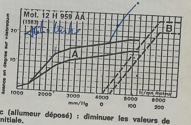

to clarify on this map load is in kpa?
20= 80 under atm (0.8 bar vaccum), 100 is atm and 180 is 80 above, so 0.8 bar/12 psi of pressure
Yes, Looks about right..

as said by Robert big tolerance,
the numbers I gave earlier were mesured on to different dizzys by harry, so certainly the best numbers to use *wink*

Good stuff that Fab, thanks... first time I have seen real figures for this dizzy. Here it is with the Kpa as well. I am amazed at how fast the vacuum advance comes in...
Maybe this stuff should go in FAQ/Knowledge?
