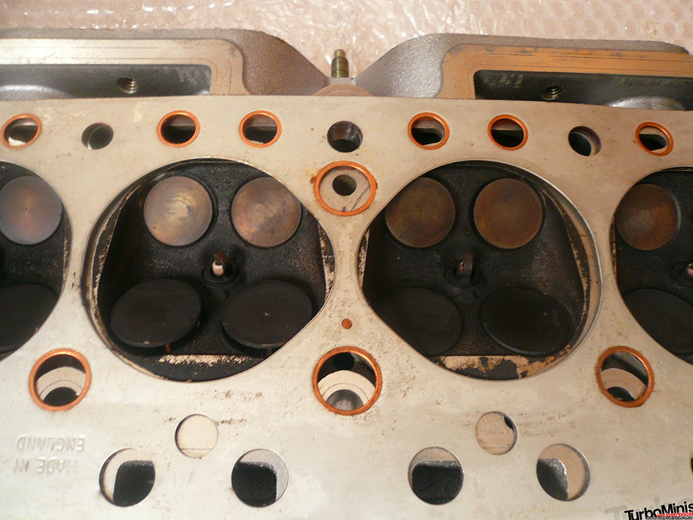

New pics :
Head confronted to a small bore head gasket
Centre stud lined up, we can see that the other studs location is only close (much worse than spot on I guess)
I have to work out that but for a proper dry deck, I assume one needs water inlet on one side and outlet on the other side so it could be a good opportunity to reverse the cam sprocket side and appears do-able before anything put to pieces thought

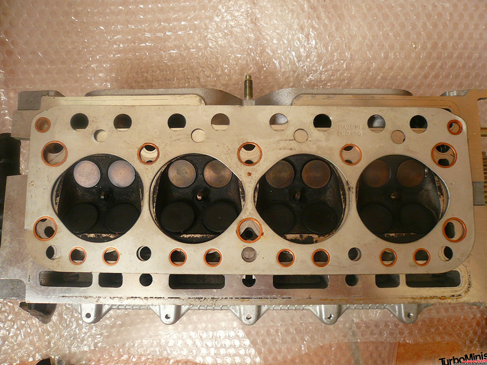

Reverse cam scenario head + gasket picture :
These scenario is better because exhaust ends up at the back so not in the middle of oil pick ups, oil filter, starter motor, intercooler and rad ...

You would be best to dry deck it and re-drill a few water passages between the cylinders to line up with water galleries in the block (if possible).
Looking at the top picture you could probably blank off the big slots in the head and re-drill to meet the push rod holes.
Difficult to tell where you could put an external water feed or oil feed without having it in front off me. All part of the fun and games working these things out. Lol

Looks like it would need a 1275 head gasket? The valves will kiss otherwise?

Scruffy : It is meant to go on a 1275
Matty : no idea about cam timing adjustment, I'll let you know when I put it to pieces.
Dry decking : the idea of redrilling some waterways sounds much better to me !
Sh*t is water from the block seem to be quite well lined up with oil in the head and vice versa ...
What I am really concerned about is an eventual oil feed because the upper part of the head is quite busy with rockers all over the place ...
