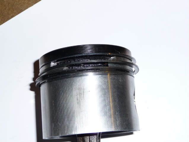

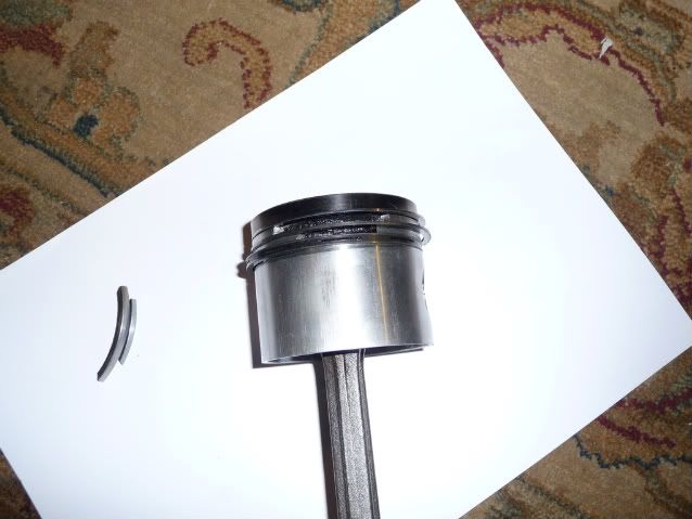

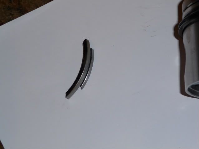

took some photos of damage , orderded some accralites , cant wait to get back on the road
Show us thew pics then!
Just for the record Æ have NEVER received a MEGA piston whose damage was material or production related. They are always destroyed because of fuelling/ignition. Send them to Minispares North to have them checked. If you don't you sort of admit that it's your own fault.

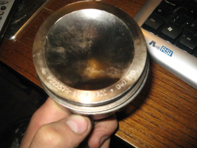

although on the photos the piston top look really black there not i will get a photo of the top

Here we go again... and once again - can you PLEASE return the pistons to MSC so they can have them inspected. The only way they are ever going to find out if there is a problem - and so perhaps curtail anybody else having issues with pistons bought in that period is if they can identify the problem. I posted this same request months agop after a similar thread was posted. result - no pistons turned up. So - ALL those out there with failed MSC Mega pistons - return them and the problem can be identified. Or else - like somebody else has already posted, there are those that wil lassume they were not returned because of a guilt complex. Do EVERYBODY running Mega pistons in turbo motors a favour and get those damaged pistons back to MSC.

here is a copy of the report we received back from federal mougal concerning the one and only set of 22357-40 megas that have ever been sent back to us (by a user on this forum)

Reference the above-mentioned pistons returned via Mr. David Taylor with a complaint of land breakage after being fitted to a Mini ‘A’ series turbocharged engine.
Visual examination confirms land breakage between the top and second compression rings on both pistons with one piston also sustaining second to third ring land fracture. The piston with the double land fracture has run with a full fracture, evident by the presence of carbon across the fracture faces, suggesting these sections of the lands had totally detached during operation and had been trapped between the pistons rings. The second piston reveals a clean fracture with heavy indentations present on the second to third ring land, possibly suggesting the section of land had been partially fractured and forced out once removed from the engine. This piston also reveals carbon staining at the rear of the ring groove and erosion of the aluminum on the topside of the groove commonly a cause of excess fuel (see photograph).
These observations along with the angle of fracture, as per photograph, are classic examples of land fractures caused by detonation.
Enclosed is our service bulletin SB2105 which shows examples of how fractures occur.
