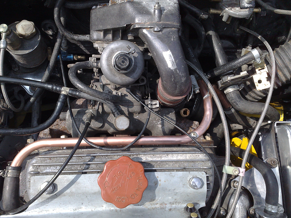

Hope this helps I made a pipe that links the heater take off above No.4 into the bottom hose of the rad. The bottom hose comes from an SPI if memory serves so has two return lines this allows me to close my heater tap and still allow the circulation of water from around No.4 water jacket.
