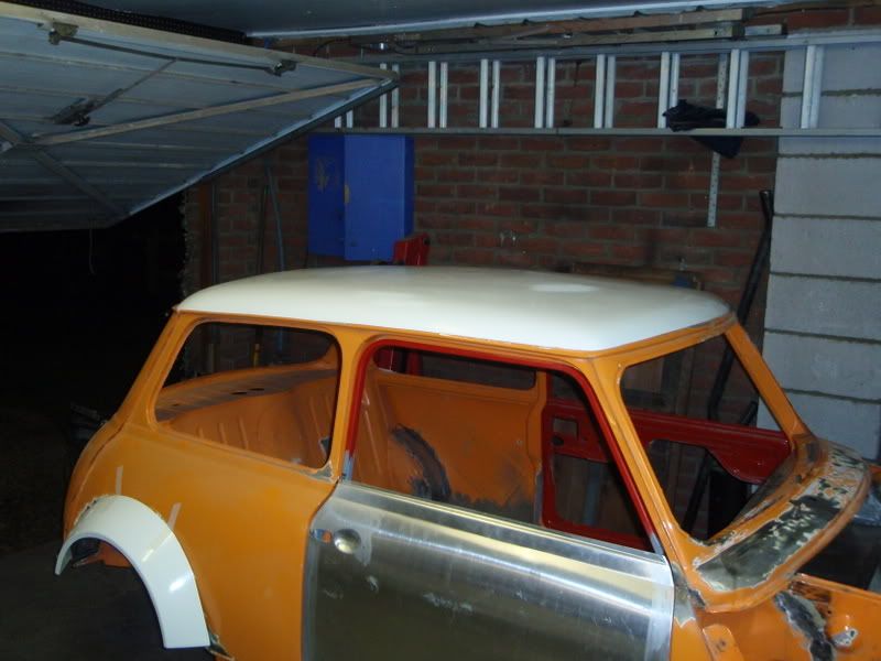

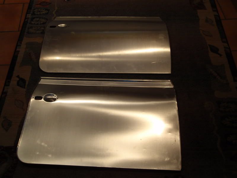

This morning started of with a drive to dsn classics to pick up a pair of alloy door skins they got in specially for me, a windscreen and a load of seals:
Have fitted one skin and have to say i'm extremely impressed with them, considering there only £27 each and non genuine, they fit perfectly and only weigh 1.5kgs.

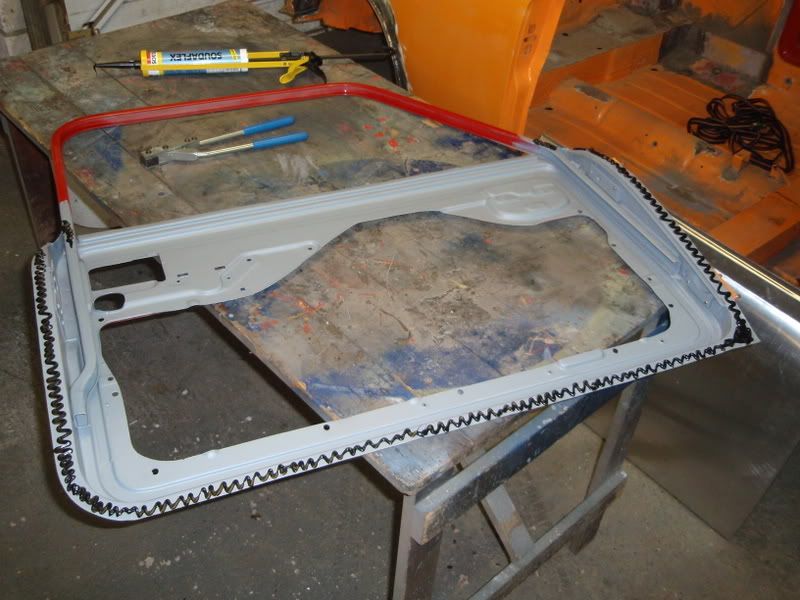

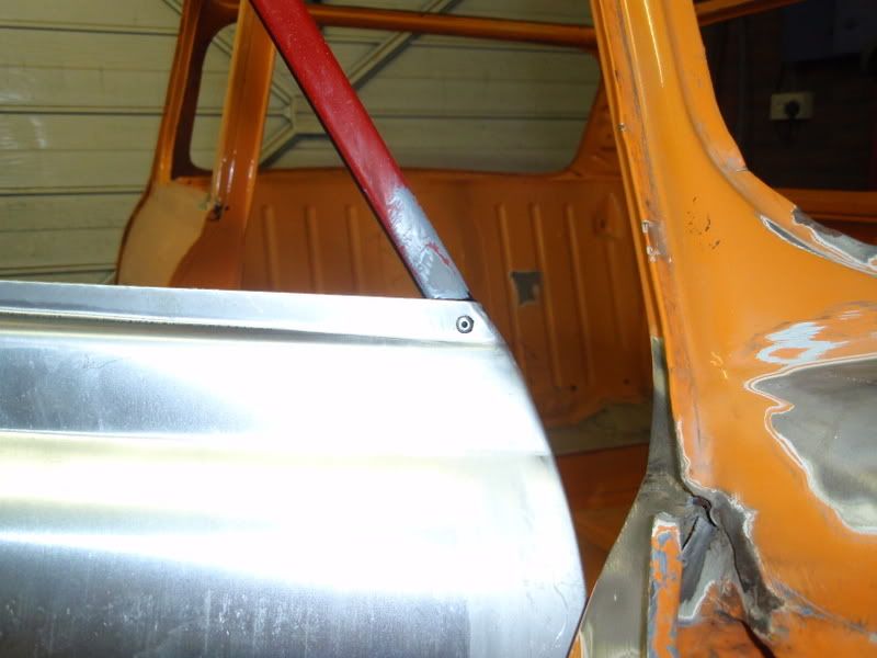

Door frame with bonding agent applied:

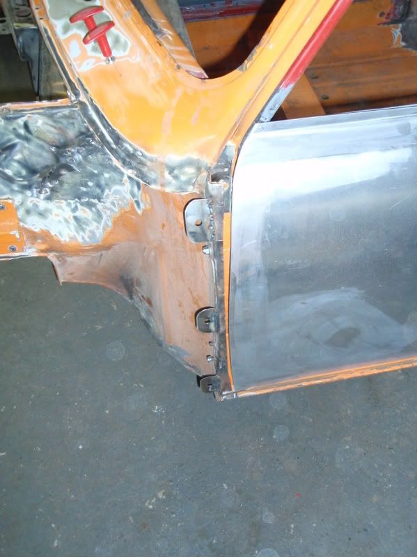

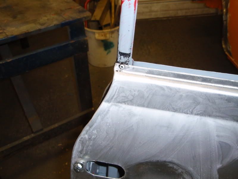

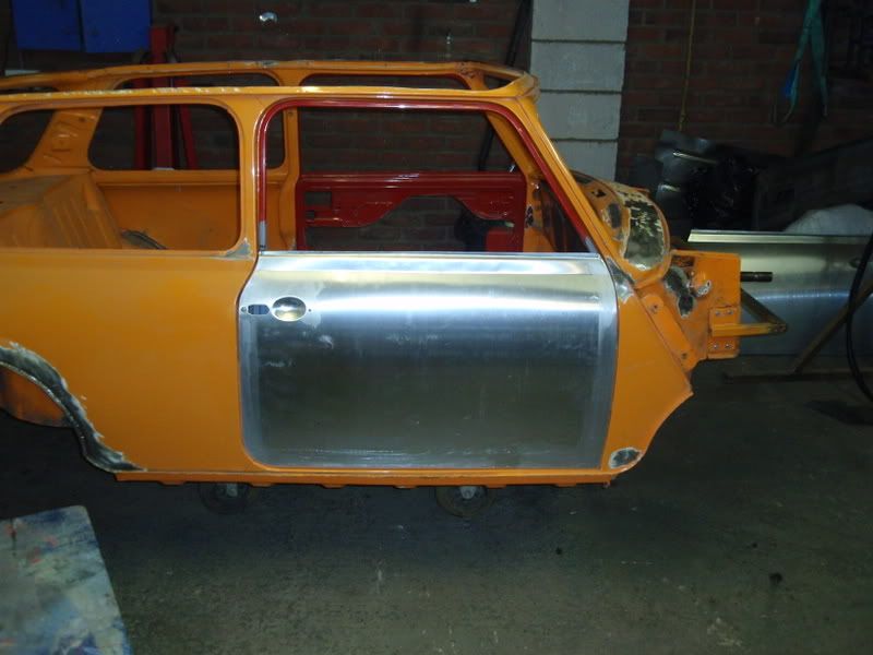

Skin fitted and edges crimped round, and a couple of pop rivets at the top:
Very impressed with the fit of these:

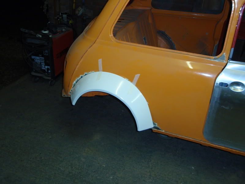

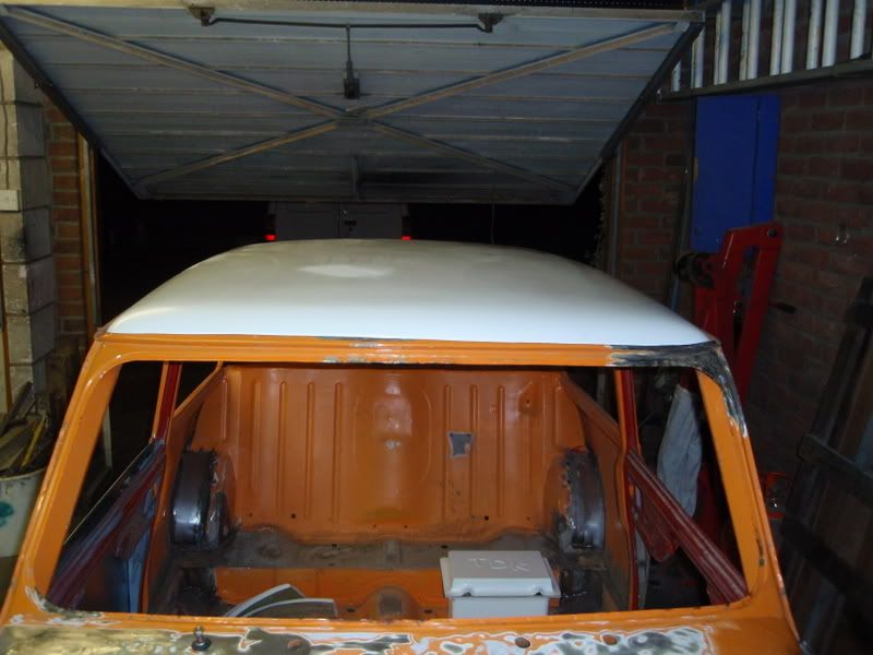

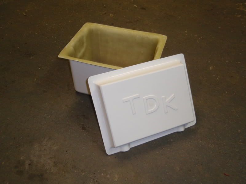

Then this evening I've been to meet up with Dave Kimberley (TDK Racing) to pick up the first of the fibreglass bits.
Set of miglia arches:
Battery box:
And my favourite the roof skin:

What did you use to stick the door skins on? Is it just panel seal or something special for the alloy? I use panel seal last time and they are still attached.

Here kittykitty.
I think im going to buy one of those batery boxes now..

Yeah just a generic high strength sealant, its a cheap rip off of silkaflex, but works just as well.

Question: How much of your roof did you leave attached to bond on the FG one?
Also what did you stick it on with? You make it sound too easy !!!!
really liking those door skins.
how much do your doors weigh now?
i was orignally thinking fiberglass but dont want them leaking because im going to be using it quite alot so this coulc be the way forwards.....without the expense of street fighters of course!

Theres about 1.5" round the back and sides, and about 3" at the front. Its not stuck on yet its just resting there, will be using some stuff similar to silkaflex.

Yeah i was really impressed with them, there a fantastic fit, and a bargain price of £27 each from DSN classics, you can get them direct from the supplier (www.magnumcarpanels.co.uk) a little cheaper but you have to collect.
I went this route as your hear nothing but bad stories about f/g doors.
Haven't weighed them yet, still gonna trim a bit more of the insides away i think.

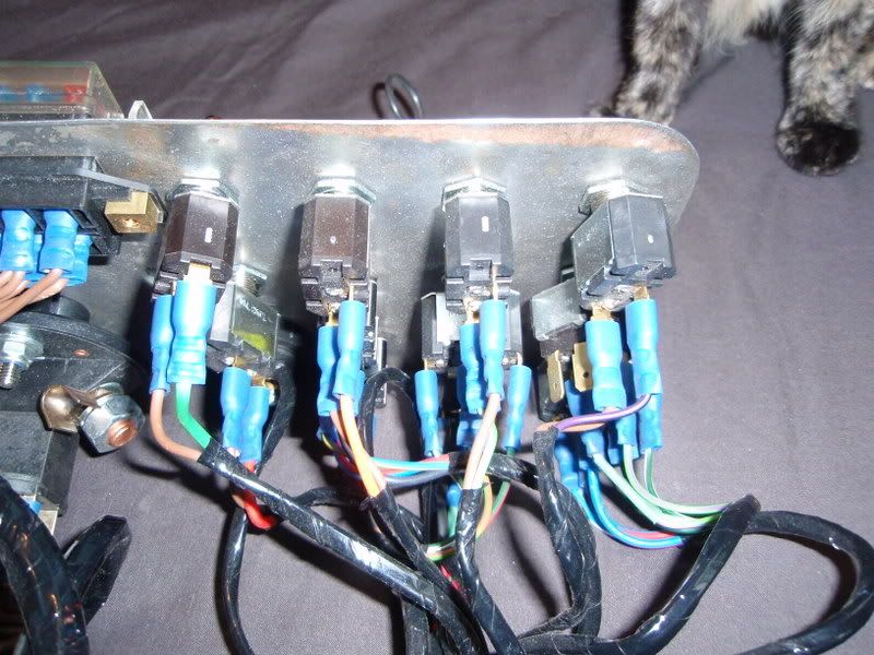

Its looking good. Does that battery box take a normal mini sized battery?? also do you have any pictures of the back of your switch panel?
advantage998
458 Posts
Member #: 1840
Kings Lynn, Norfolk
Pics of switch panel as requested:
All of the switches, fues box and cut off switch came from a local Durite supplier. All of the cabling from vehicle wiring products.

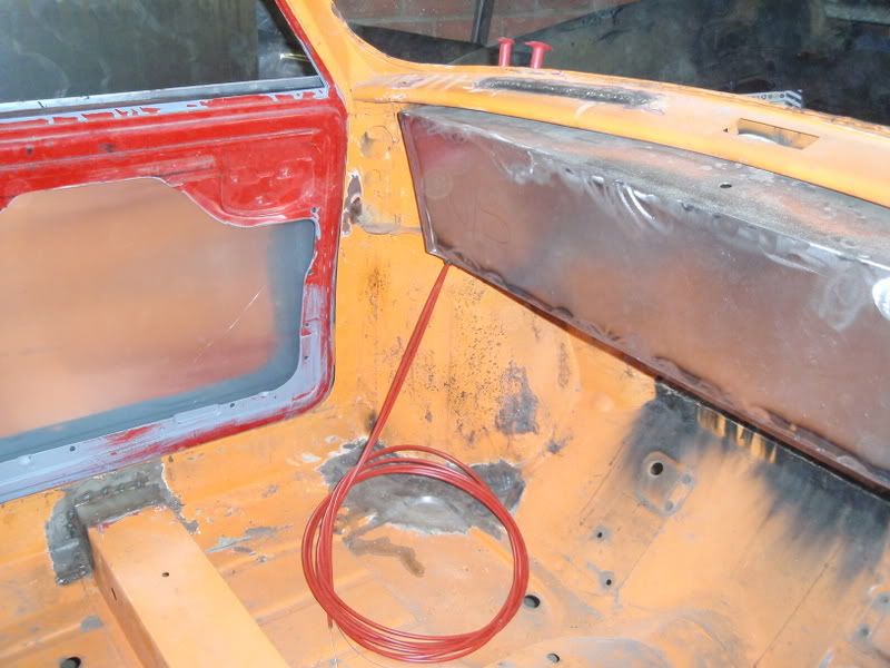

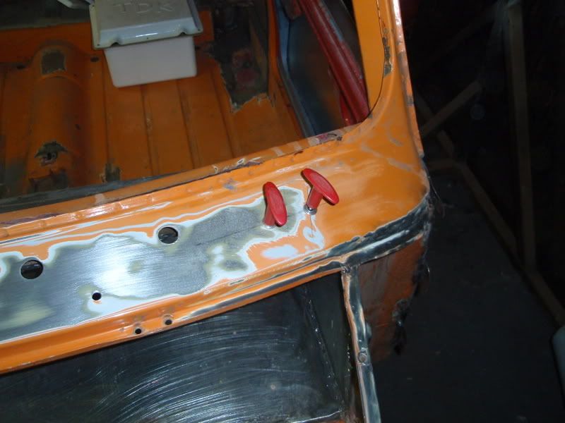

Got my pull cables for the battery cut off and extinguisher fitted, miles to long for what i need but better to be safe than sorry:
Chopped off the a panels ready for the front end which has them built in, got the brackets welded on for the dzus fasteners:

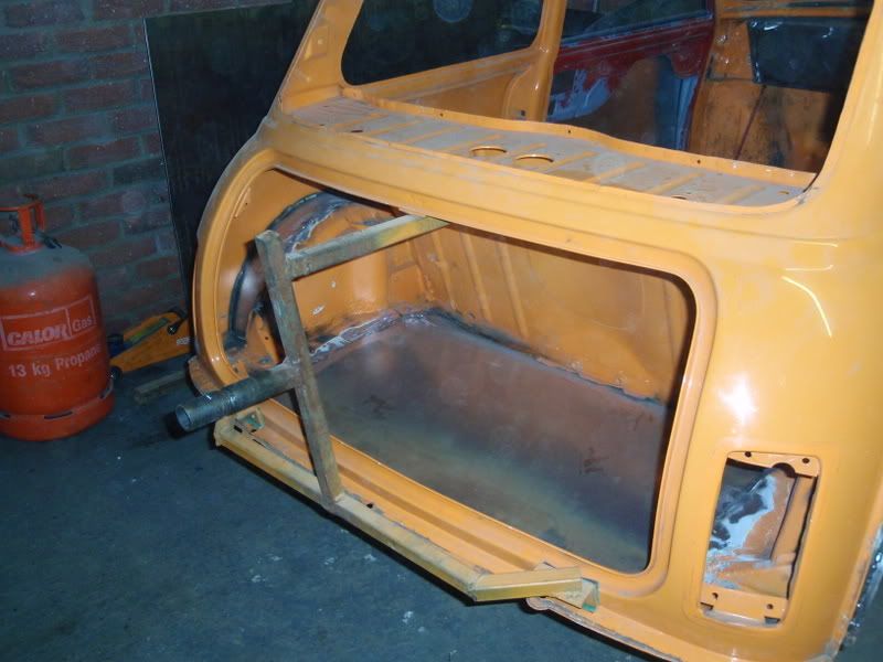

Boot floor fabricated and welded in place:

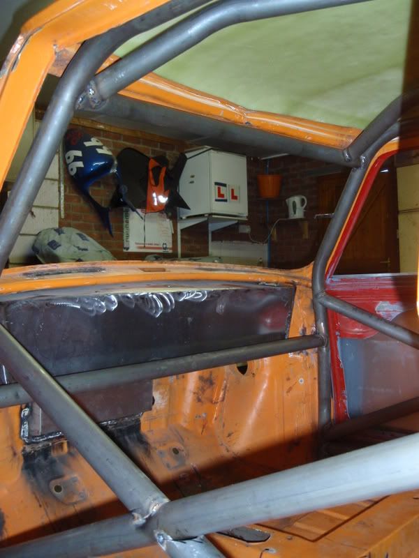

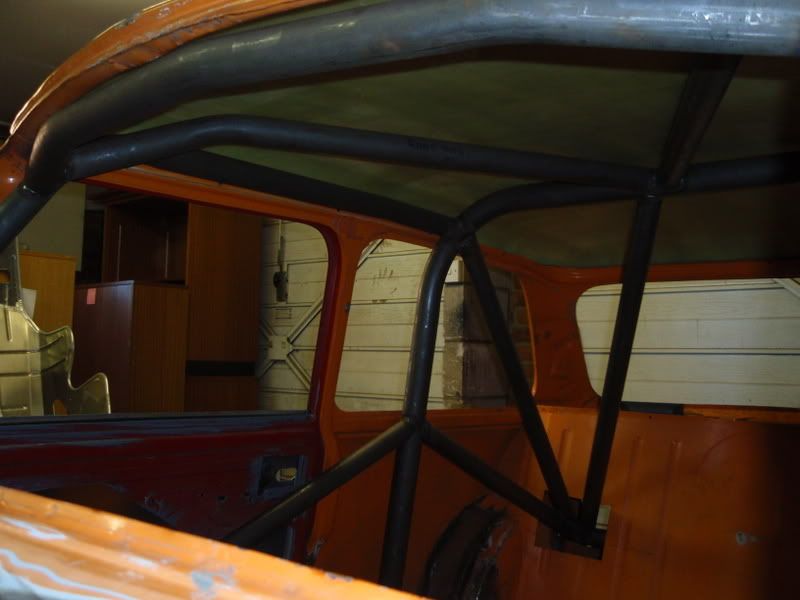

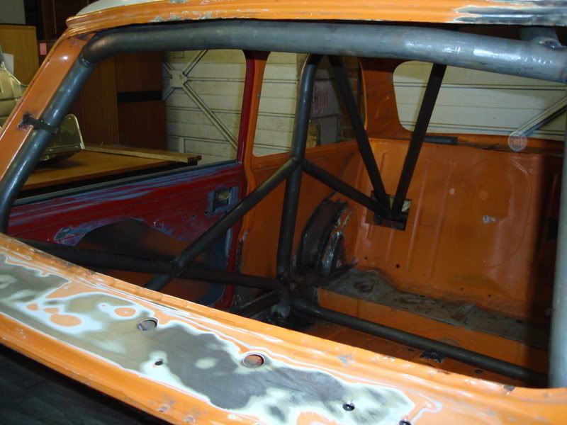

Well got the cage picked up friday and its progressing well.
Its been a bitch of a job but is quite satisfying seeing it come together from a pile of tubes.

Would you mind telling me what all the switches are for? I am planing my new dash and I just want to make sure I'm not forgetting anything.

Umm strugling to remember myself now, umm working from left to right from the top: Start button, ignition, headlights, main beam, fuel pump, fog light, indicators, hazzards, radiator fan/water pump, wipers, washers, horn.
