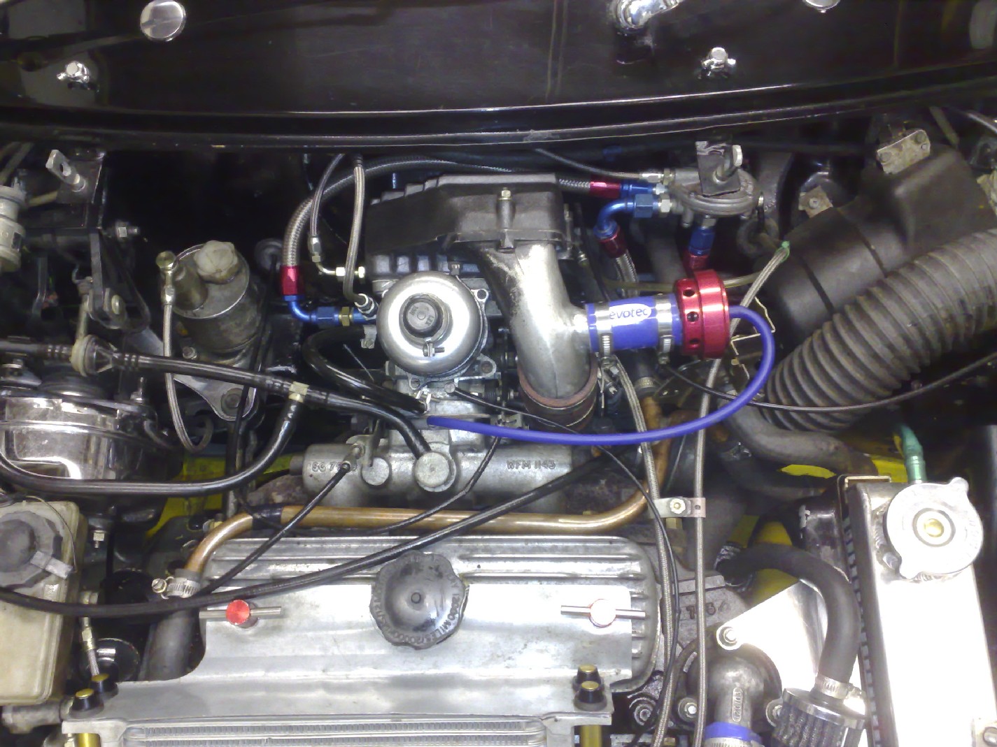

You have no efficent way of removing the hot water from around number 4 cylinder. I run a copper pipe from the heater tap take off across the back of the rocker cover into the bottom hose of the rad so I have a constant circulation of coolant.
With regards to this, how have you plumbed it back in to your bottom hose?
I'm using a front mounted radiator and have not yet got any of the hoses, I need to make an adapter for the bottom hose, to which the feed from the header tank will be connected to, will I need to do the same for the heater tap take off?
I've been pondering about this for a while, wasn't sure if I really needed to keep the flow going past number 4 but I'd rather be safe than sorry!!

The bottom hose for the rad has 2 return lines in it. I believe I took it from an SPI I was breaking could even have meen an MPI. But it allowed me to retain full control of my heater matrix and allow full unrestricted flow from around number 4 piston I had to fabricate the copper pipe and braze an extra piece on so I can run the system as I wanted hope the pic is clear.
You can see the two return lines coming out just behind the rad to the left of the cap. The copper pipe feeds into the lower pipe and the heater return feeds into the upper pipe wher I have positioned a later type heater tap.

Back in 2003 I melted No.4 piston! Sinc I have run like this No problems with melting pistons and I am running more boost for more of the time.
