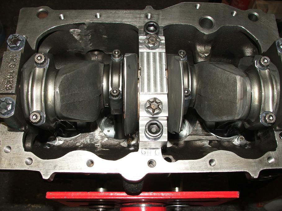

Paul S: I experienced the same problem from APT. THe solution is to use 12.9 cap head bolts on the two outer ones... It works!

Shit...better get some 6 stripe...Is it a simple replacement? Dont want to leave anything to chance...
I wanted to ask also, iv torqued the mains caps to 68lb/ft as per the engine builder DVD, but my haynes specifies 63lb/ft. Which is right and what torque do you use?
1310cc TWINK - T Conversion
just go with the 68lb/ft as its already done. wouldnt have thought it would make much/any difference.
loking good!
yep the bolts are straight replacement, just double check the length and thread toype when you swap them lol

Hi, I read that thread on mains bolts, lengthy! But informative.
Sprocket I noticed your post on 'place bolts' the 6 slotted bolts on the mains... the factory bolts... I have kept these, are these up to the job? Even though they are a few years old?
Do ARP supply the bolts and nuts for the 4 bolt main cap? Im due to order some head studs so may as well do it at the same time and save on delivery costs - Rod S you say your having problem fitting the ARP bolts - does this mean the set you ordered are incompatible - is that because the block had been tapped from a UNC to UNF. Are blocks UNC in standard form?
You can still buy the standard factory A+ bolts from minispares for about £2.50 each. Why re use old bolts that have been stressed for 60k miles perhaps when you can still get new ones and they wont break the budget.
save a few quid on the head studs as well and use standard studs turned down on the lathe *wink*
they are ALL more than up to the job :) I hope they are as they are what I am using :)

Hi just found the mains bolts on minispares will deffo buy some of these...
Just to double check, am I ok removing these mains bolts and simply replacing them? As iv already fully tightened them. Also can I replace the bolts without taking conrods and pistons out i.e without starting from scratch?
Dont know if theres a set routine to follow?
yes to both, youll obviously have to re torque everything, but changing the bolts shouldnt effect anything
Just check that the standard mains bolts are the correct length for the four bolt centre main.
Very good point!! I forgot about that!
I had my four bolt cap machined so it was the same hight as the standard cap where the bolt head lands *wink*
I had considered using the shorter 998 mains bolt for the two extra bolts, but they are just a little too long. A hardened washer under the head may have done the job, but I opted for M12 cap heads instead, cheap and cheerful *happy*

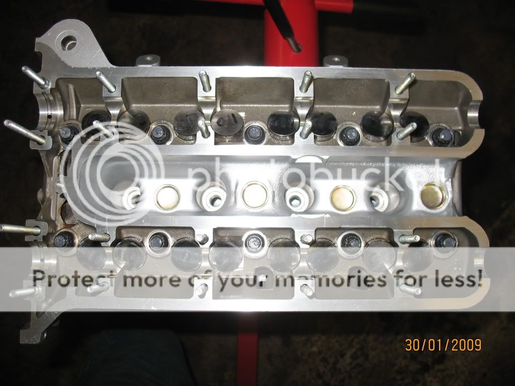

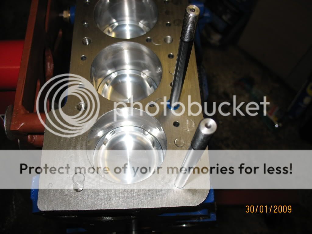

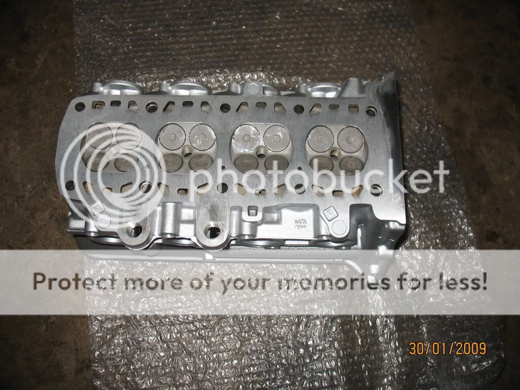

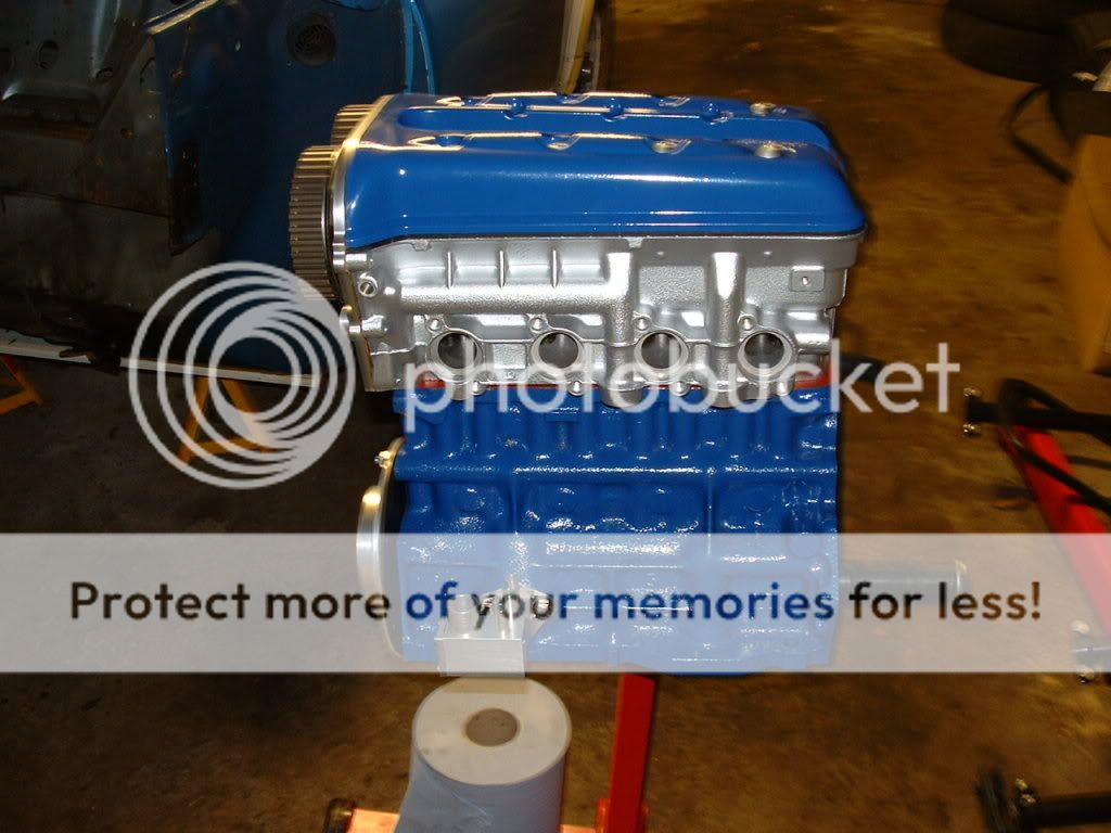

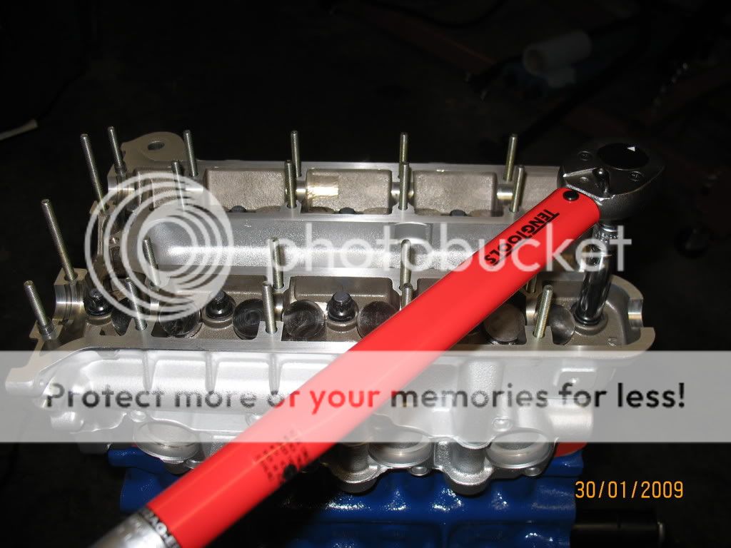

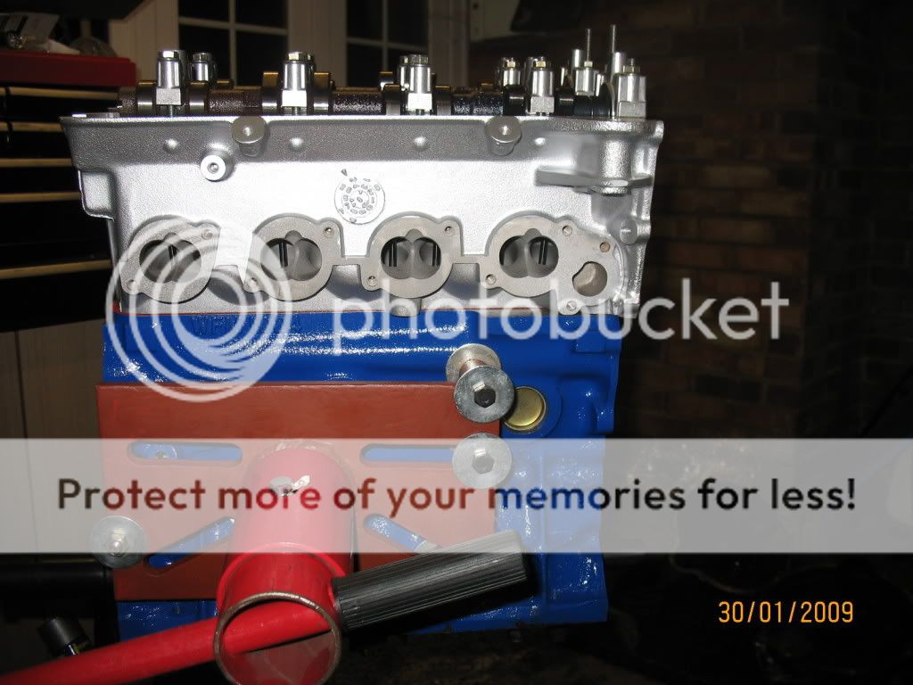

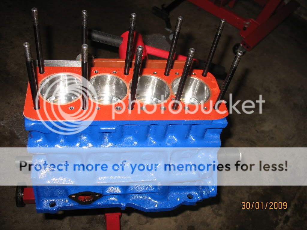

Hello all,
Progress has been VERY slow recently, but have a few pictures of the work so far. I decided to remove the head, order a new gasket and grind the head studs down further. An absolute back track but didnt want to take any chances.
Just a couple of questions - which quaife would you consider a better, tougher unit, the swiftune or MEDs? or are they about the same?
Also what final drive would you recommend? The car will not be an everyday car, just for weekend/ track days. Its being built for all out speed! So really dont care about comfort, noise, practicaility etc! I hope to be running 200hp at the wheels what final drive would you go for...i would like a balance between top end and acceleration i.e. dont want a low top speed as I probably wont get the traction ? What would you recommend?
Thanks,
Chris.
200hp at the wheels should be easy with a turbo, what boost to you plan to run?
Final drive depends on wheel size, what are you using?

Im going to be running 13 inch wheels.
I was hoping to go higher than 200hp tbh, im plannng on running 15psi : )
Thanks for your comments.
Chris.
I'd look at a 3.1 final drive.
What is your compression ratio? You should be able to run more boost than that with injection.
