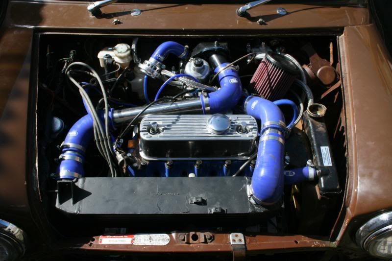

Well not much more to report other than the list of things to do is whittled down and I think all I need is a charged battery (and no doubt the starter solenoid will need a tonk) to turn it over.

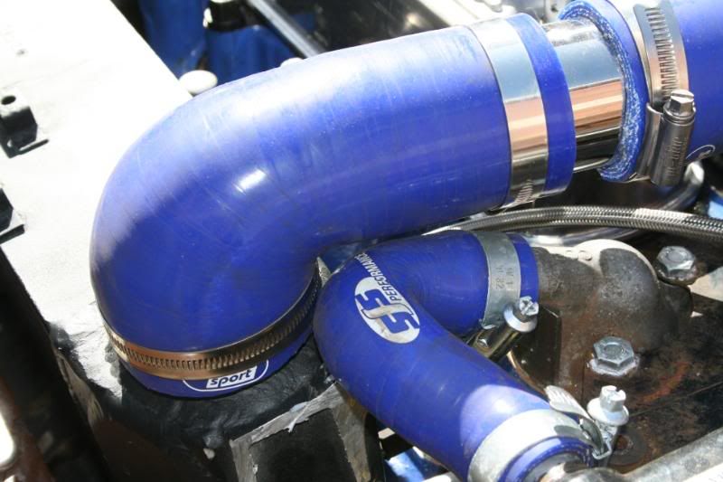

Sadly I have surcome to puting a few holes in the bonnet for the IC, but I think I will like them when they're done.
The bonnet almost closes but the IC hose is a little high, I think if I chop out a bit of the bonnet bracing it'll close.

Not very exciting for anyone other than me, but I have the oil pressure up and it's cranking over OK. The fuel pump is wizzing away too so my wiring skills aren't too bad. Next step is get a fresh battery in it, flash a base map to the MJ and see what happens. :)

Well it runs! Kind of! There is a small fueling issue, it won't idle without full choke even when warm. I have had the carb off and striped down again (I rebuilt it with a kit a few months ago), and the float level is fine, filter is clear, float needle is clear, infact it all checked out OK so I don't know. It just seems to be not getting enough fuel.
Anyway just need to get some brake lines made up, bleed the brakes and try drive it up and down the driveway (it's on a SORN). There is an exhaust leak somewhere, I need to plumb in my breathers, re-position the washer bottle and fab another braket for the downpipe then it's RR, tax and MOT time! More pics soon.

Good stuff. Have you checked the fuel pressure?
Jay#2
2500 Posts
Member #: 648
Northern Ireland (ex AUS)
A valid point, no not yet. I take it this can still affect it at idle? I have a pressure tester on order, when that arrives I'll sort that out.

Its certainly worth checking. Although it may just need richening up on the screw.
