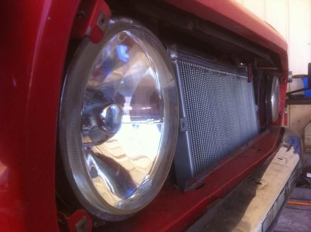

a nice thin heat exchanger at 1" thick 12" tall and 24" wide this is a tight fit in a club man front and ive "squared up" the body to give a nice fit witch cant be seen with the grill in place!
i have since blown some holes in the sheet metal between rad and bumper behind the grill so as not to be seen but give more air on the lower section of rad

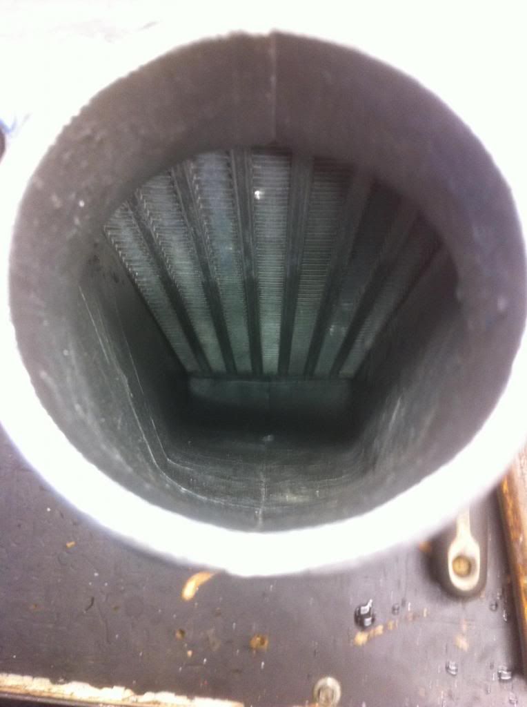

the cooler has a proper air to water core not some cheep ass air to air job that restricts flow!
the core is 11"x9"x3.5" plenty for my use this thing has literally next to zero pressure drop

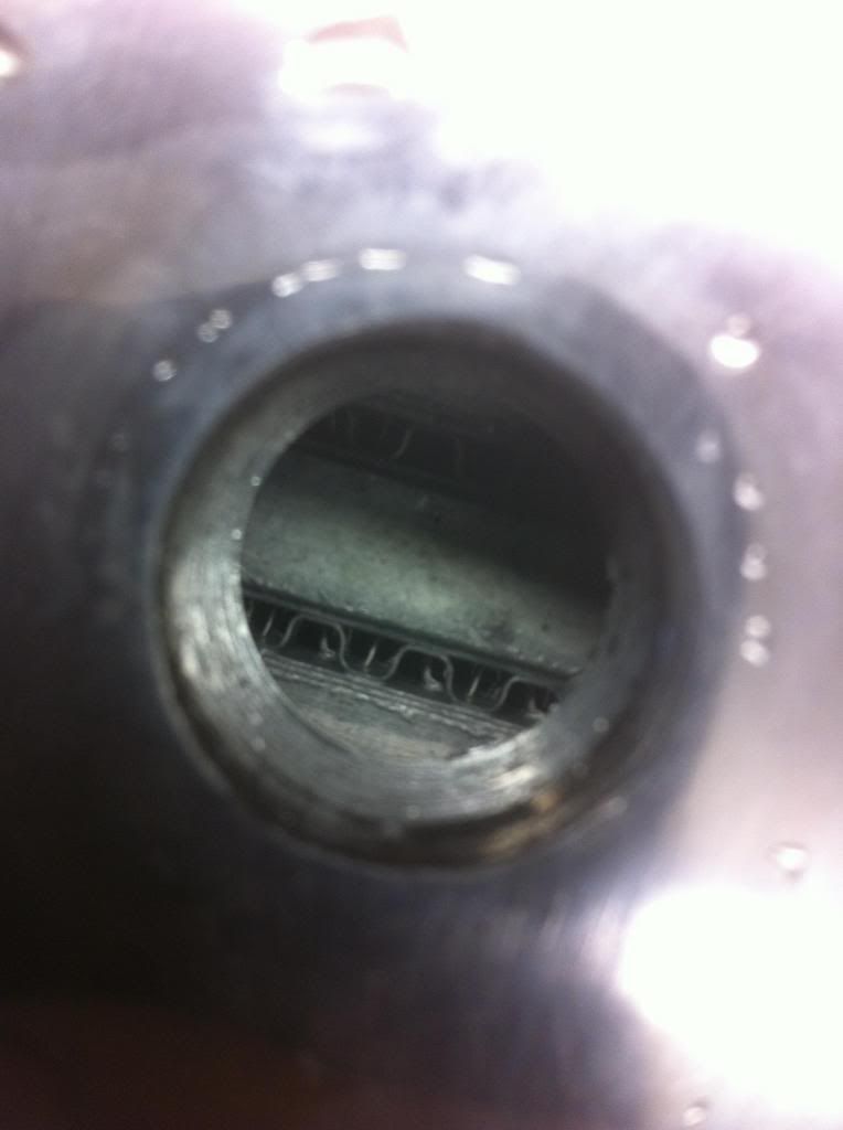

you can see that the water passages are much smaller than the air ones this is to keep losses at a minimum
also can see the fin pack in the coolant side is staggered and well bonded to help out with heat exchange

i have sealed both rad cores together with about an inch air gap ive done this to force the air to flow throw both and hopefully maintain a cold air gap vs recalculate hot air and transfer into the IC.. i may have to run the thermo fan all the time to keep this random idea in motion...
