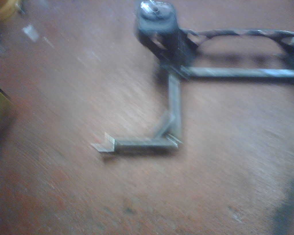

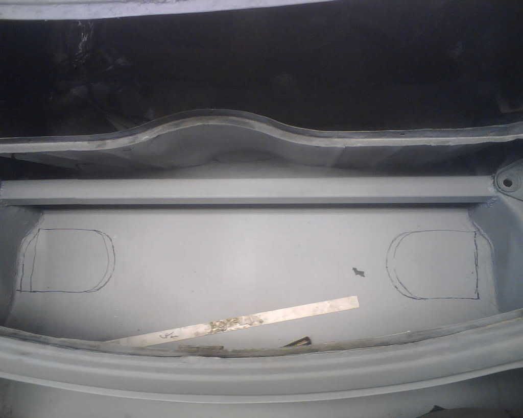

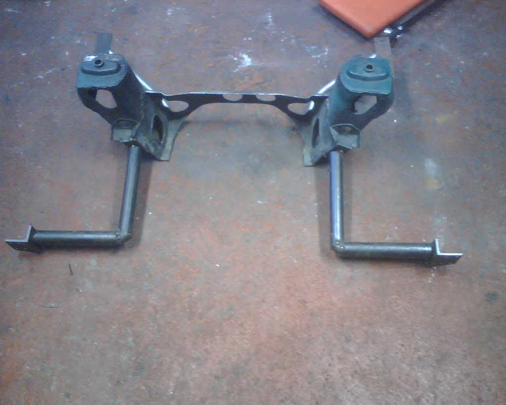

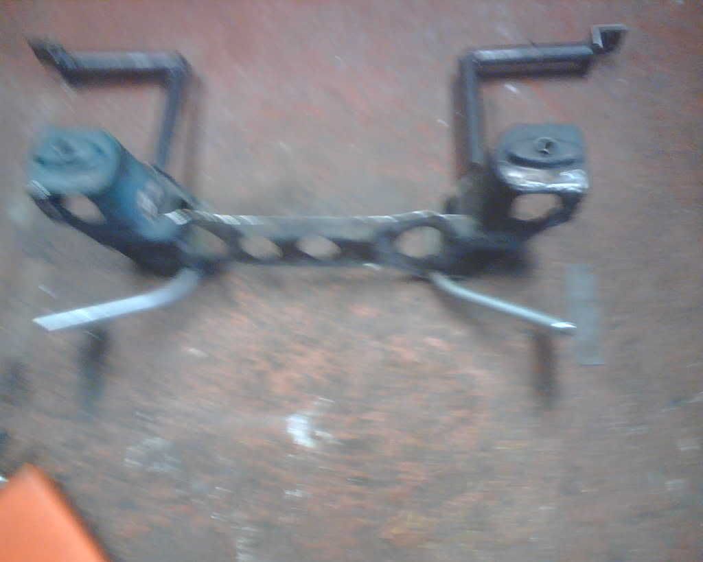

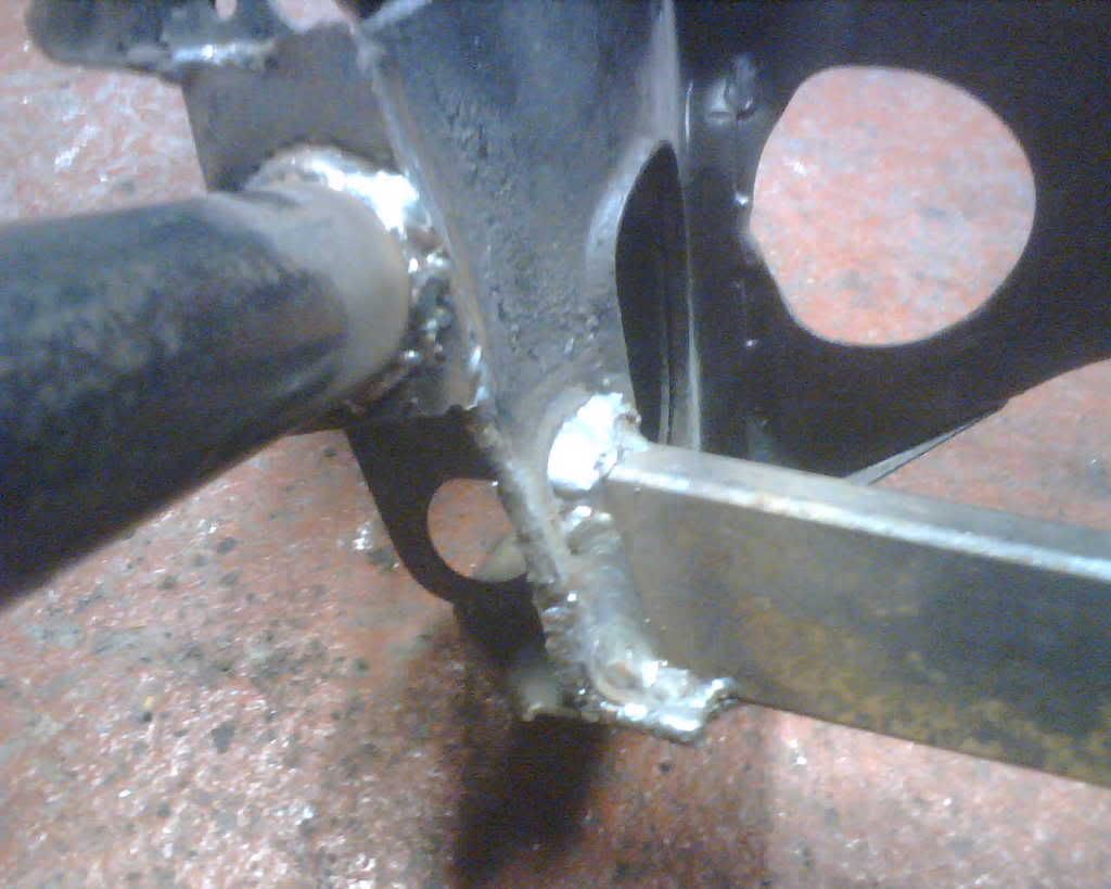

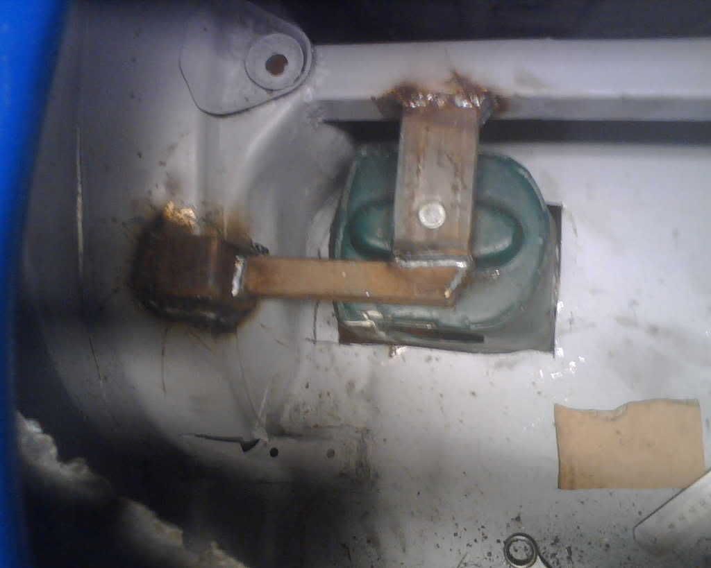

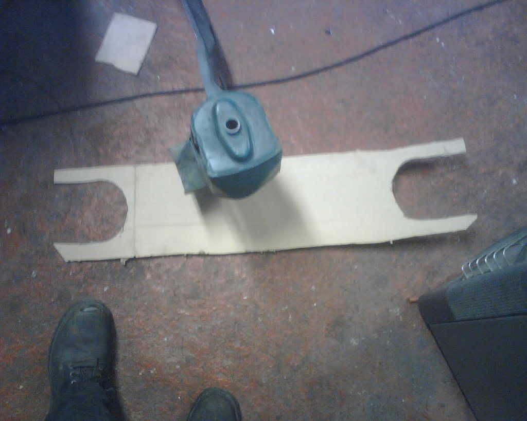

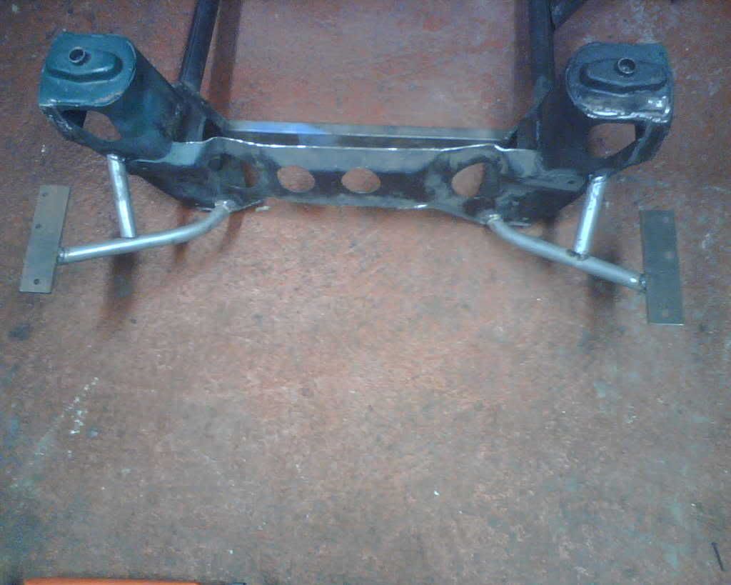

Well with the Race season now in full swing over here Im am geting far less time at this than I would like that coupled with the fact that I ran out of gas for the welder and the stupid spare bottle has a leak so it was two empty, ment I got far less done than hoped today but a few pic of the progress today.
basic mock up was done on the car
then I started to add bracing

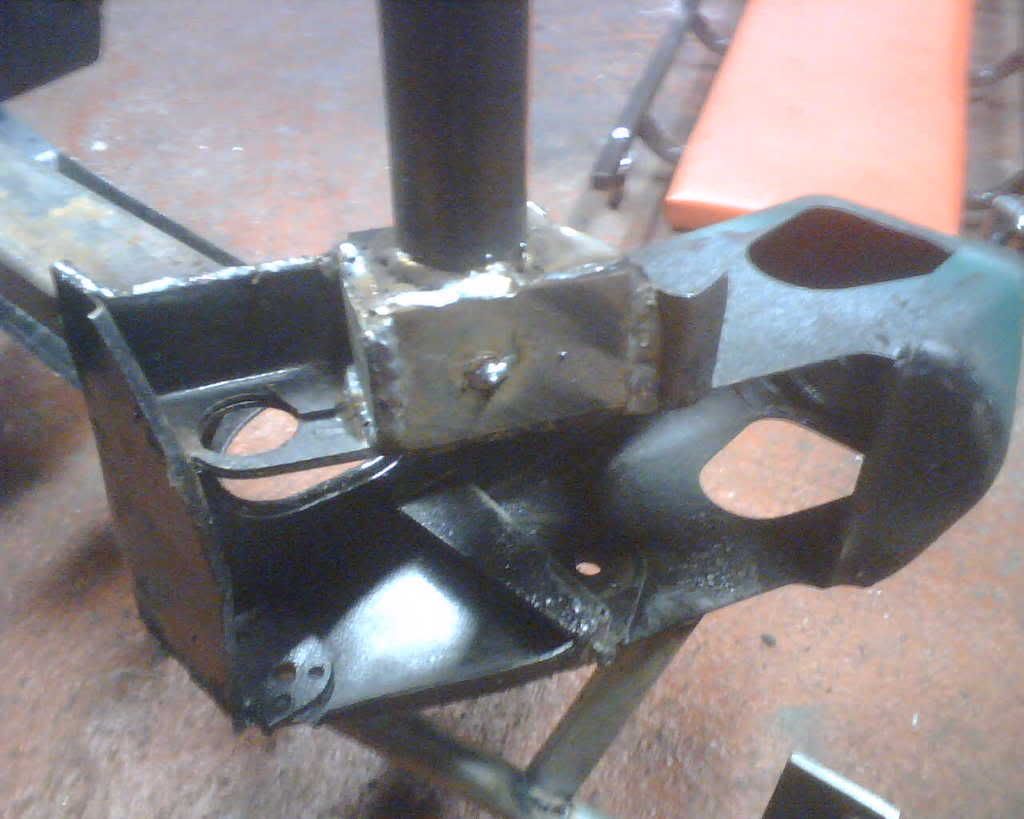

A few more pic from the boot
how it all started
sorry about some of the pic I had to get a new camra and Im not up to speed with it yet :(

Neat idea Paul - one or two things I'm sure you've thought about but haven't mentioned. Camber gain - running the top arms at a high angle will make the camber gain aggresive/excessive, Migs get away with it because they ar ego karts - what a mig ride height would be like with this set up on the rear could be interesting! - toe change, again beneficail if set correctly and goes in hand with bump steer - looking forward to seeing how you get on in testing - you'll have to drill lots of holes in the donut to lose stiffenss from themto compensate for the lack of weight on the back.

Thanks John, I have been thinking hard about these things, Please feal free to elaborate on the top arm isue, I must confess Im far from Knowlegable on all the aspects of this idea, There will be a lot of trial and error in geting this I have been in talks with a local GTM coupe race driver as they have most these isues but on the front

Nearly all the welding is sorted on this I had some issues with the shock fowling the inner wing so had to re fab a new shock mount, I have just ordered some Fiesta Brakes,
