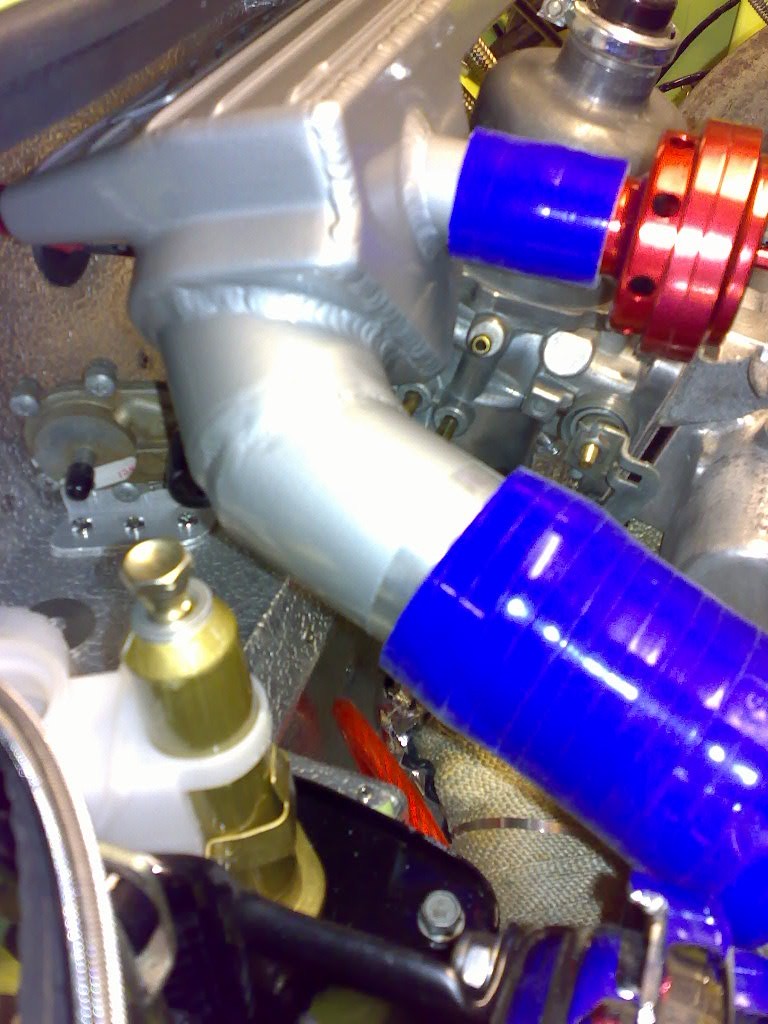

Bit like SidewaysGTM, I've had a reasonable amunt of success using MIG on ali. To my amazement really as I thought I'd give it a go one day.
Made quite a few smaller pieces for the van like the actuator bracket, mods to Maestro plenum, turbo oil feed take off from filter head, threaded boss and expansion tank stub into cast ali thermostat housing.
All seems ok with the weld quality as long as you dont mind doing a bit more cleaning up with a die grinder suitable for grinding ali - the burr is MUCH coarser - about 6-8 teeth as opposed to 20-25 of a typical steel burr - certainly more clean up than steel MIG welding. Anti spatter spray also works well on Ali
When I MIG ali, I use my standard 120A Clark Turbo MIG (fitted with Nylon liner and standard .8 mm copper tip) but replace the large Argoshield gas bottle with a small bottle of Argon from Halfords (about £8 the last time I was in the shop) and my 0.8mm steel wire comes out and is replaced with a small 0.8mm roll of Ali wire, again from Halfords (about £9).
All in, it cost me about £20 to get started which was fair game if it went Pete Tong. However, like I said, good success.
I turn up the wire speed to about 50% faster than I use on steel wire and start with a fairly low current, gradually increasing the current to give optimal penetration. You can tell when it's on song - sounds just like TIG.
I found pre-heat is essential by trial and error - it greatly improves weld quality.
Takes about 15 min to convert the welder and have a practice then I'm off.
Attached is a shot of a Maestro plenum which I've added a completely repositioned inlet pipe, a dump valve stub and an elbow into the inlet from the intercooler.
For some reason, it seems to work even better with the crap ali cast stuff that thermostat housings are made from.
If you wanna see the weld quality, the parts are in the engine bay on the van if you next catch me at a show.
Hope this helps.
Richard.
