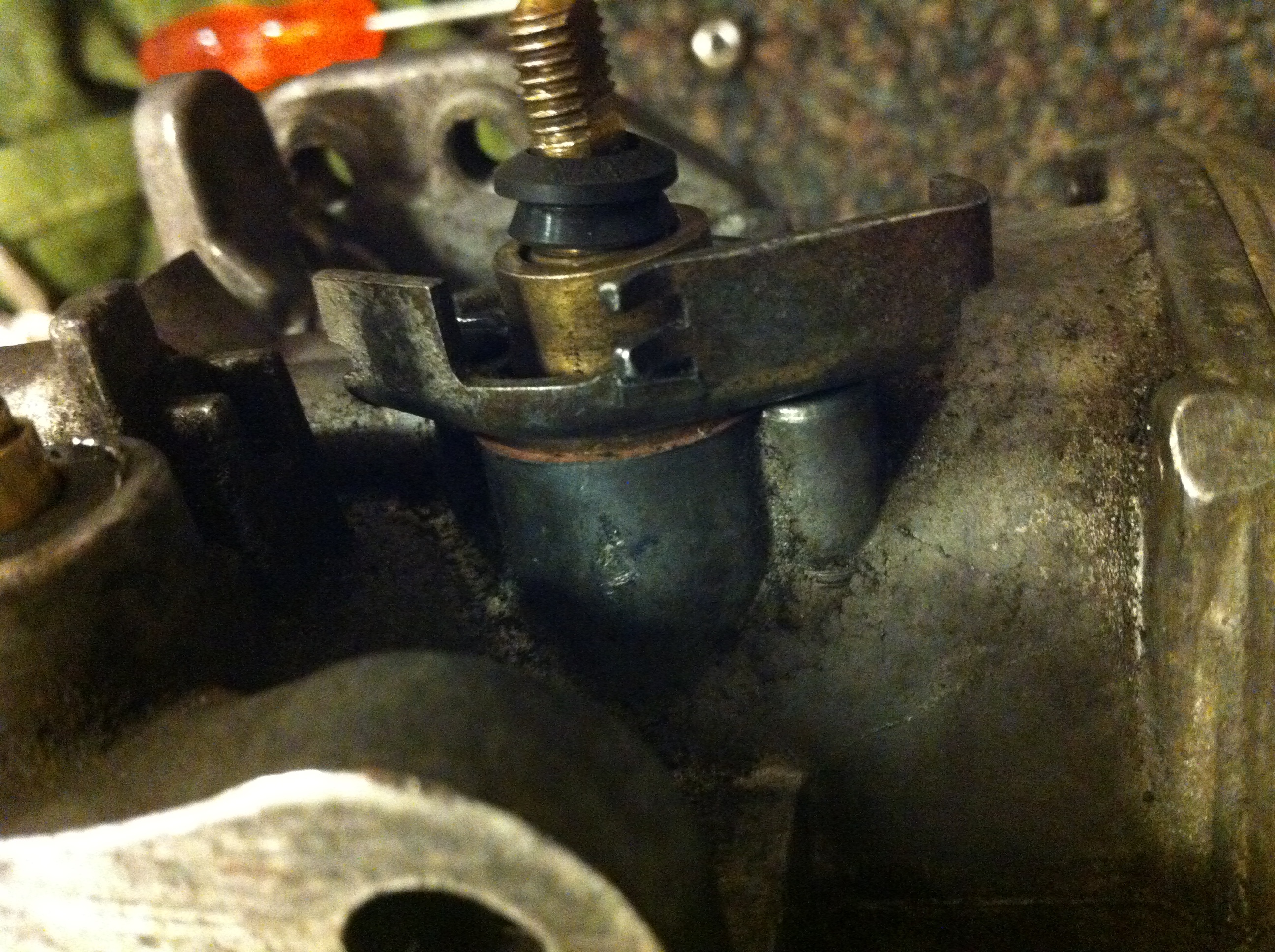

i have got some question that some of you might be able to help me with also some pics that may help others
first is this crack in the brass collar/sleeve thing for the choke mechanism going to affect the operation of it?
second the SU exploded diagram in the box/kit shows no seal between parts 37 and 38 so how is flue held in this valve thing? i take it seal 44 is what keeps flue getting out completely
is this port/barb right with a reduce thing in it?
some pics of setting the float

How do you mean when replacing the choke spindle seal with the lip inwards?
Is it the tapered end towards the carb?
Also is it meant to just push up to the spindle or actually squeezed inside?
Is the spindle meant to move in and out slightly?

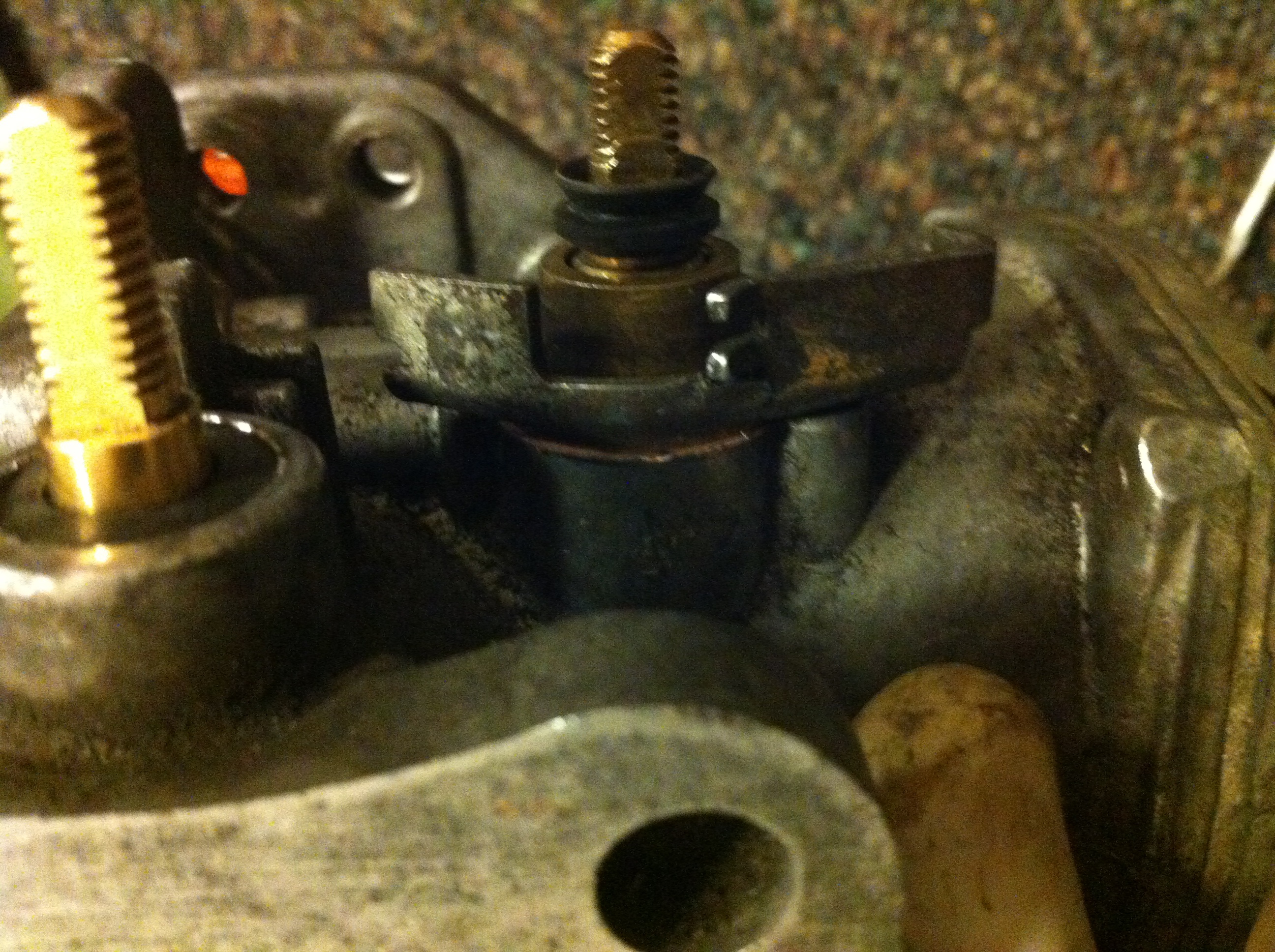

Liam1288
2 Posts
Member #: 10592
Just a pic of each way the seal can go as I'm not sure...
