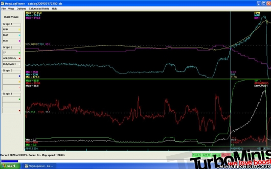

pulled from an old datalong, unfortunately its started raining so not been able to do a run! shows cruising on the motorway for a while then floring it. But after what you have said will check it with a thermocouple in the inlet piping, dont really want to be spouting shite on here :)
EDIT as its not so clear from top to bottom :
1st window:
RPM
MAP
IAT (or MAT in megasquirt)
2nd window:
TPS
AFR
Duty Cycle
Edited by evolotion on 25th May, 2009.

stevieturbo
3597 Posts
Member #: 655
Northern Ireland
When I sued a crap sensor like i described....temps appeared to stay cool on boost, then tended to rise shortly after, before falling again.
But when cruising they did reflect ambient, or around it. They were just incredibly slow to respond
