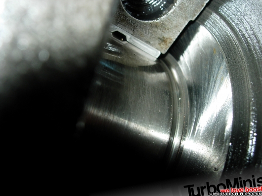

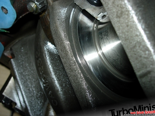

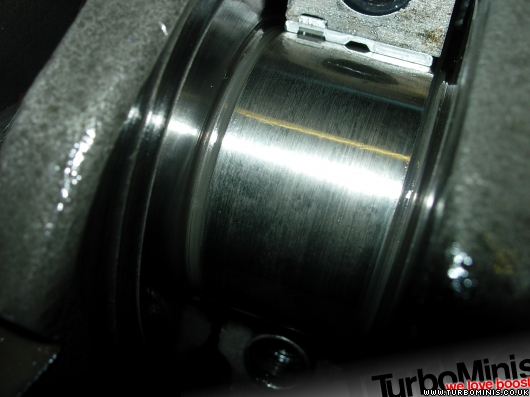

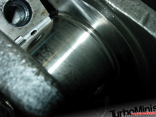

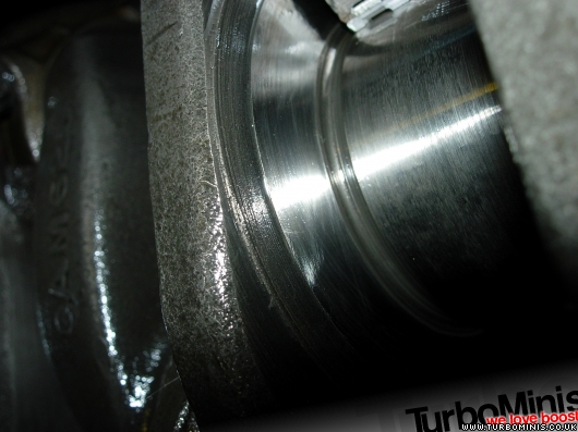

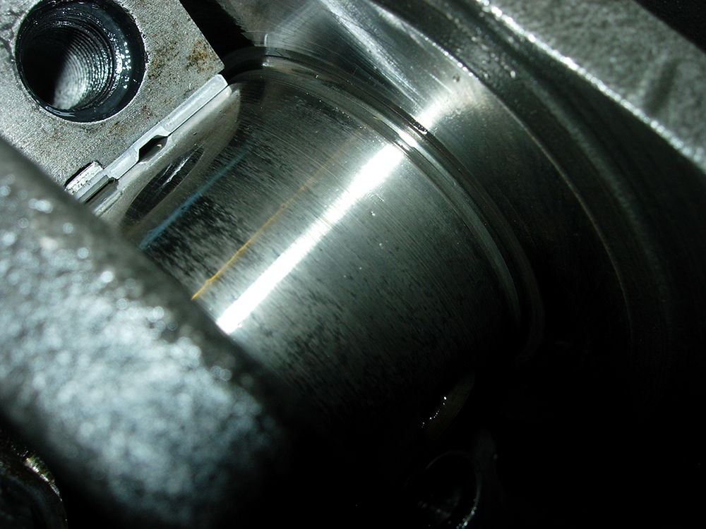

Cheers Vegard!! Yes I will make absolute sure of my measurements before buttoning it all back up again for sure.

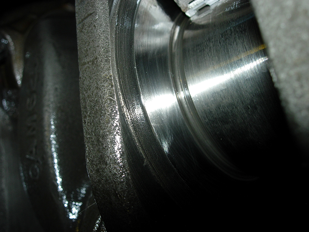

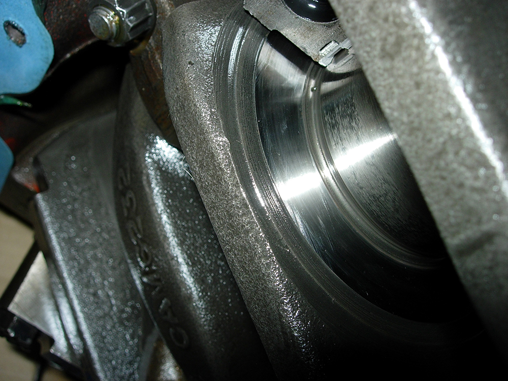

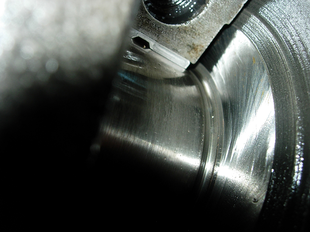

Joe- just ran out and got some pics of the crank, looks toit like a toiger to me:
(2nd half):
other side :

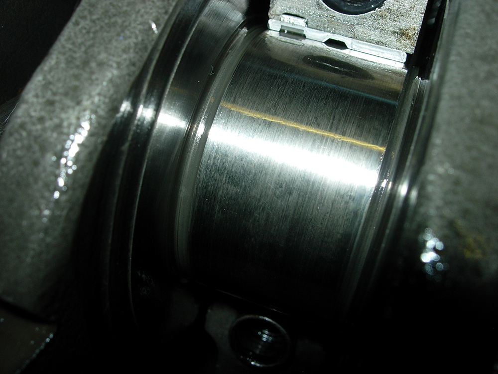

And the journal for ref:
They seem sweet to me! No highspots at all. I cant see what caused it other than too little an endfloat, unless it really was just bedding in like Tom mentioned earlier in this thread!!
Either way, its piece of mind I guess.
p.s, glad you like the camp plectrum, ressembles my playing *tongue*
That's toight as a toiger indeed.
yep, i'm going to go with the
"it was bedding in like Tom said"
well bumet that you took it all apart, but better safe than sorry eh.
