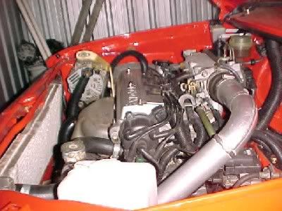

My engine sits further back than most, allowing room for the alternator, the inlet manifold has been shortened.

hi ben very nice car. do you mind me asking how you got the engine so far back at the gearbox end. ive got the the same conversion but my engine seems much further forward than yours becaus my gearbox casing would catch the steering rack.
if you have some pics it would be helpful?
thanks
p.s sorry for the thread hi-jack
edit= just noticed yours is a non turbo perhaps they have smaller gearbox?

The engine is rolled back towards the fire wall and doesn't sit straight up and down. The diff sits about 30mm from the steering rack were most conversions sit.
And it is a turbo engine uses a front mount cooler and radiator.

fanx for pic ben looks quality. your engine tilts backwards and mine tilts forwards lol gives me something to think about thanks again

On 29th Jul, 2009 best_stig said:
Im getting a subframe made, an identical one to the one i posted before. Guess that means ive got to run the alternator under the wing. Or get a really small alternator.
I have made a couple of other frames and both sit the engine a little further forward to use the standard manifold and require the alternator to sit under the guard or use a small alternator and cut the guard to make fit.

Spoke to an engineer about what I wanted to do, once it was finished he inspected and approved it was not real difficult as long as it is made properly.
A lot of the starlet frames I have seen I do not like they do not have enough support for the engine which just hangs off the suspension towers and they find when they start using them that they need to add support under the engine to tie in the front suspension mounting points. Otherwise the frame cracks and the car is unpredictable to drive under acceleration darts left to right.
