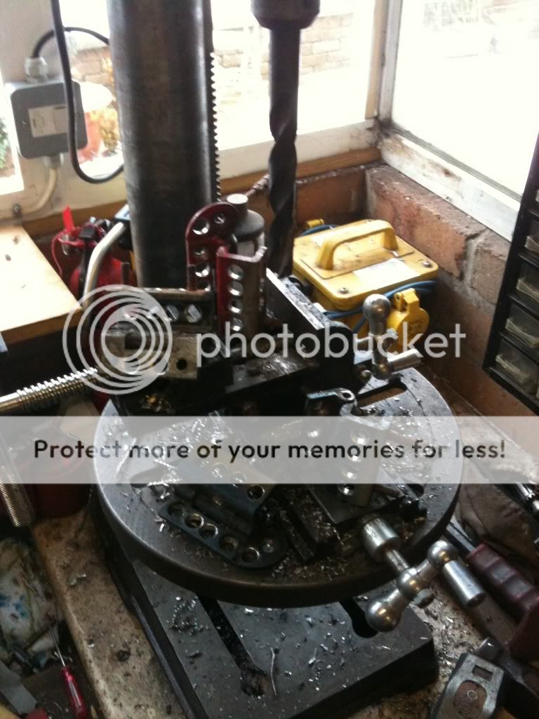

got perspex windows waiting to go in. I've seen a few peoples plastic doors. They looked shit and wouldn't do much in an accident
Those hinges are exactly the same as mine and mine passes fine. Tbh you struggle to even see to holes even if you're looking for them.
perfect. The pillar drill will be getting a work out in the near future then *smiley*
Proper pic for later on...
Advantage
1137 Posts
Member #: 1450
Near Paris - France
weight gain being ?
Rusty by nature
Gain? I'm not adding material....
Oh yeah, and you can get rid of the extra (3rd) bolt hole on the top hinges. *wink*
Lose loads more by joining up some of the holes to make slots. Looks more engineered too rather than just butchered
Paul - Any suggestions for fixing the skins to the frame at the tops? I've used pop rivets for now, but they protrude into the window runner a bit too much for my liking...
Holes can stay as is now, I'd probably end up bashing the new skins or cutting the lecky window thing in two...
I used aluminium countersunk pop rivets then held a steel dolly inside the window channel and peened it with a hammer to crush it flat enough for clearance
Perfect. Thanks.
