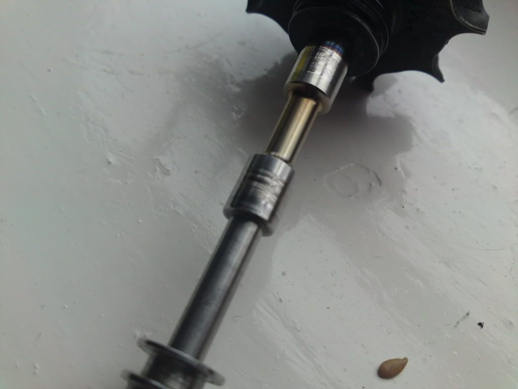

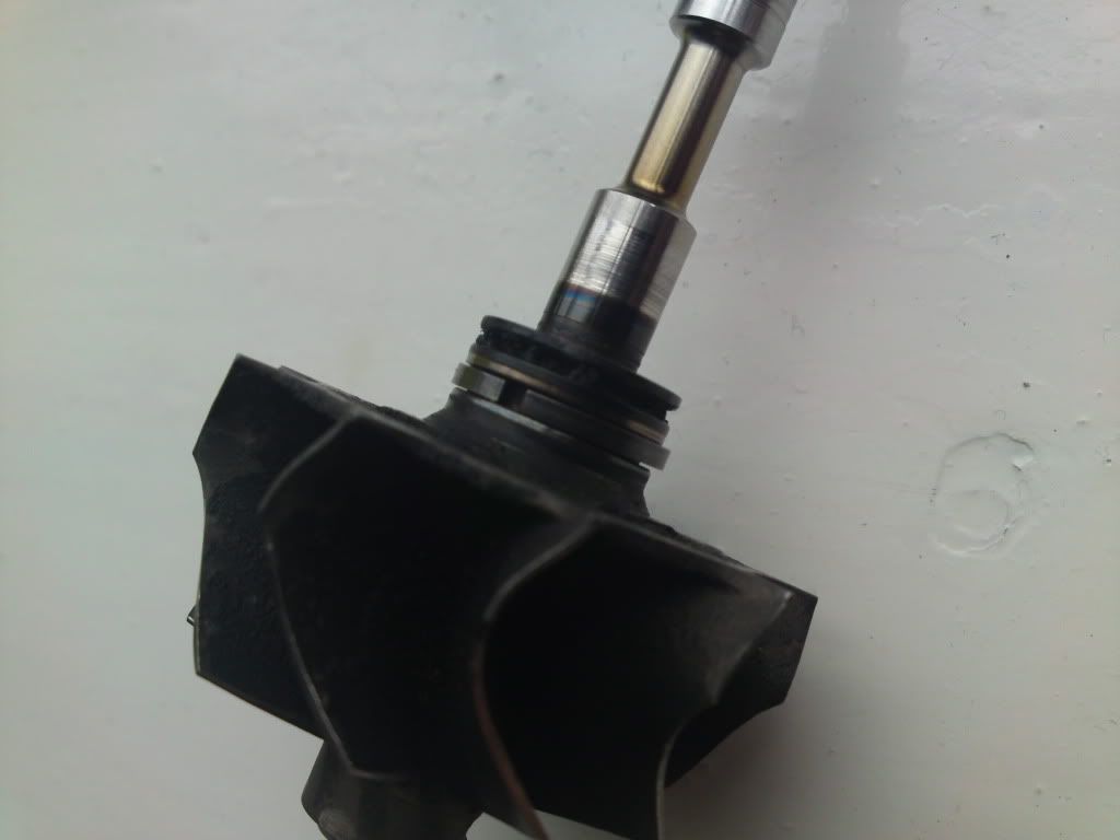

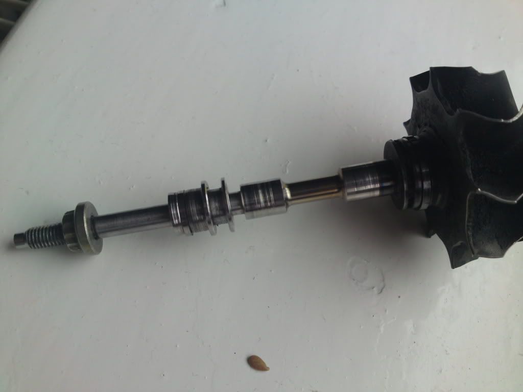

Bearing surfaces looks pretty worn.
Edited by theoneeyedlizard on 1st Aug, 2009.
What do the feel like if you run your finger nail along them?
To be honest matey, they might have to do, im not having it balanced neither, so long as it sees me out til the end of the season then thats all that matters.
Ill get one built through the winter, so long as the journals arent competely fucked ill have that off you.
The journal closest to the turbine isn't in too bad a state, but the centre one is pretty badly worn. You can definitely feel the grooves with a nail.
You are welcome to try it out by all means.
might be worth spinning it up in a cordless and putting some 1200 wet&dry with plenty of wet on it, it may polish op if that is mearing material on it?
