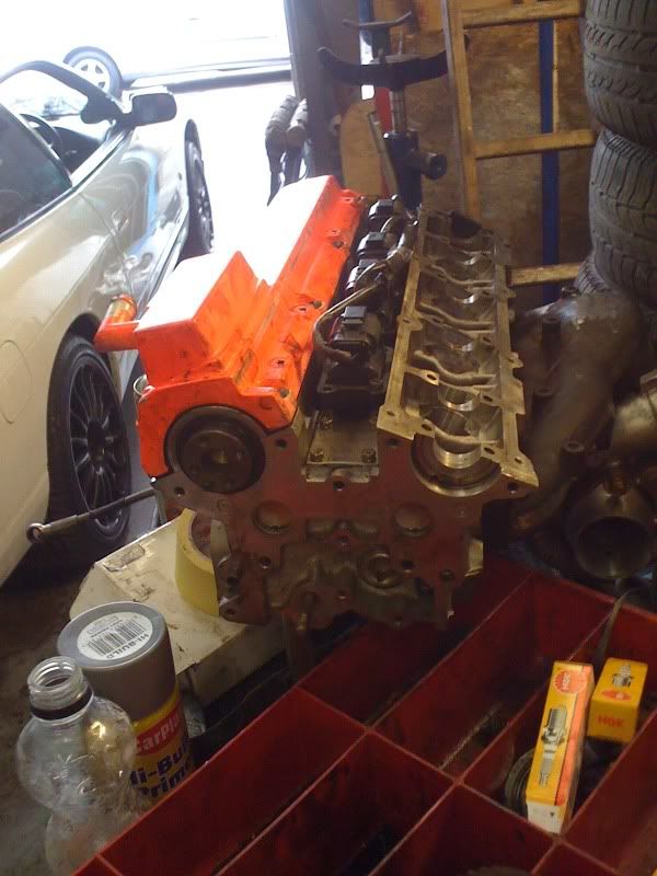

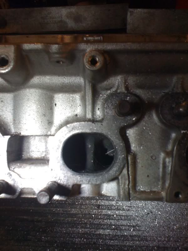

Well, i was hoping to be up and running this weekend but ive had some set-backs.
Got my new rods so i built the short motor up. Then found that the spare cranks pulley key is missing after polishing. No problem, I'll pop the one out of the old crank....PING! that hit the roof, lost!
Oh well, at leat i can build the engine up and get it in the car, then get a keyway to fit from the machine shop that polished the crank.

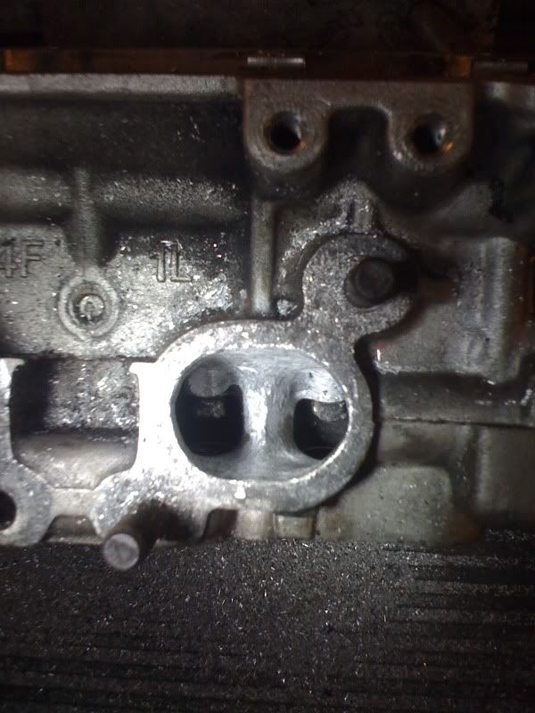

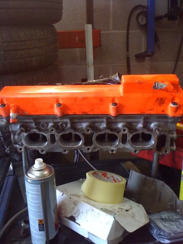

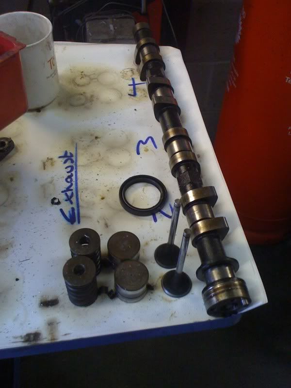

So i finished off porting the head, lapped the valves in, cleaned it all up and got rid of all of the swarf.
Built the head back up to find that i've managed to loose two spring seat washers! So i cant put the head back on! Which means im now as far as i can go with the engine untill i can get hold of nissan and get them to get me some spring seats and a keyway.

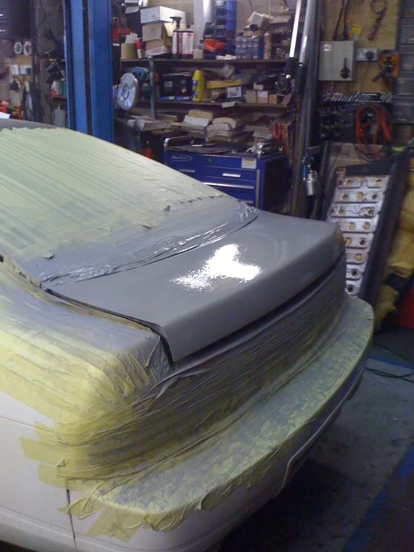

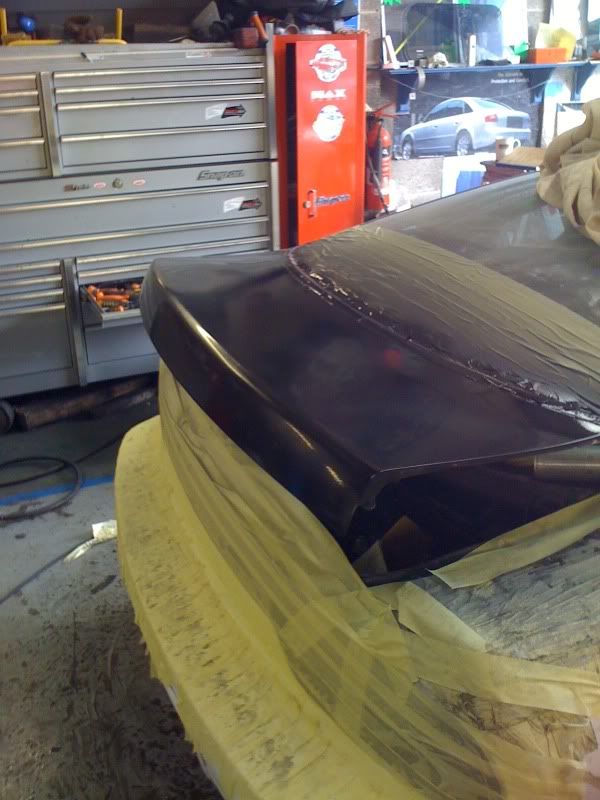

Time for the body work! The primer on the bootlid reacted in a small place and there where a few imperfections that i wasn't happy with (its only getting rattle canned but still!) so i dug them out and started again!
All went well this time round, no reactions this time!

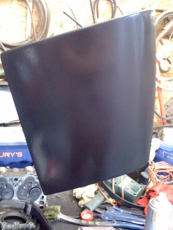

Also the R/H headlight cover had some surface rust on it so that was removed, bare metaled, rust treated and resprayed.
The last thing was the big ugly black number plate surround! Plastic primed and painted white.

Engine went in and was running by wednesday, (after a very embarrasing pipe work disaster than im not going to talk about) small oil leak from the sump (thye dont run a proper gasket) so a full rubber gasket is on order.

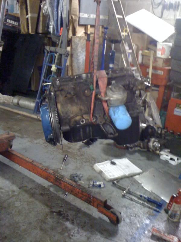

Then on the test run realised it was burning oil :( further inspection showed it was buring through number 4 only. Compression test first off showed low on number 4 (forgot a wet test as it was late). The next day i decided i would re-do the compression test and also do a wet-test....compression on 4 now the same as the rest, yet burning more oil than ever?!
So engine is coming back out!

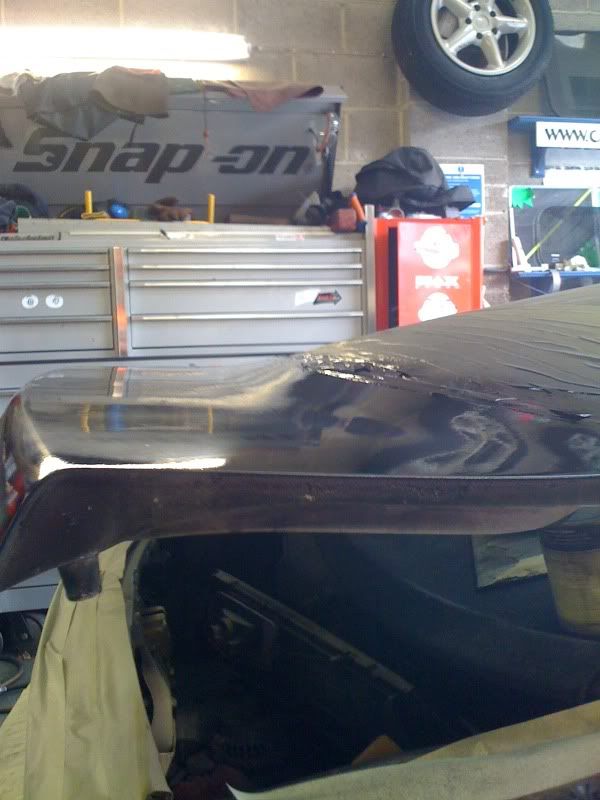

Onto the bodywork! Sprayed up the bootlid....the paint seperated from itself for some reason?! so that has been sanded back and ive started again! This time ditching the rattlers and using 2k!
So thats been primed, flatted right back again and now has its second coat of primer on.

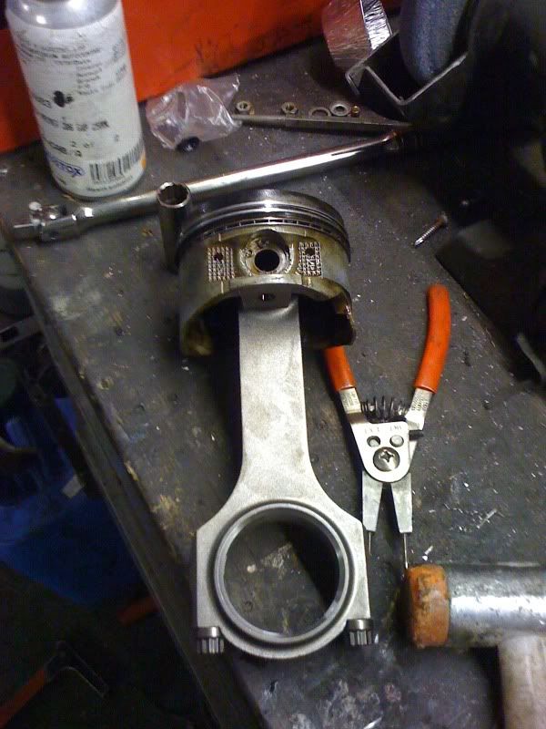

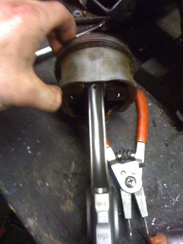

Well, for those who are interested, it spat number 4 oil control scraper.
Unsure whether it was me putting in it or what but oh well.
Its marked the bore and the piston has been chewing on something (probably the ring...)
The piston will clean up fine, the marks on the bore arent that bad and hopefully should hone out. Second opinion on that tomorrow.

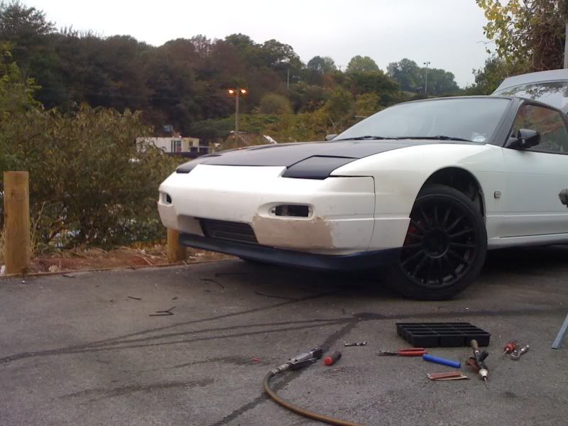

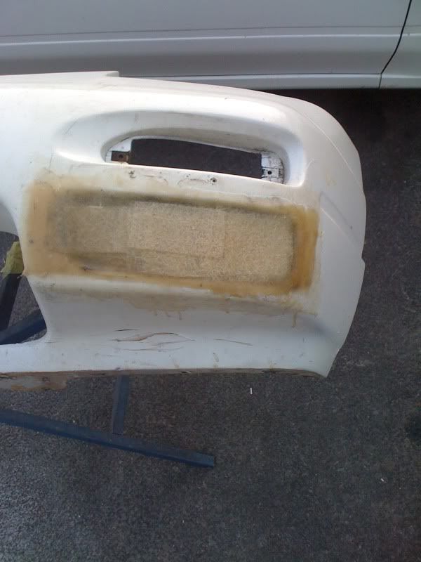

Front bumper has had the vents smoothed off (well finalising the process) and is getting a prefacelift splitter put on to suck it down to the road abit more. Hopefully will have it all prepped up by the end of the weekend.

Yet again only for it to react!

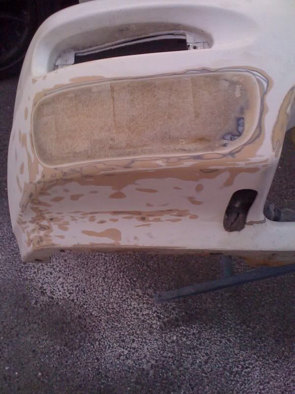

Bumper work!
Glassed over
Sanded down the fiberglass
Fiber filler
the fiber filler has been sanded now and the first layer of easy sand filler has been slapped on. The shape is already pretty much there so this layer should just be taking out/identifying the high spots and then it can get top stopped and the rest of the bumper prepped before prime and paint! wohoo (no reactions please!!!!!)

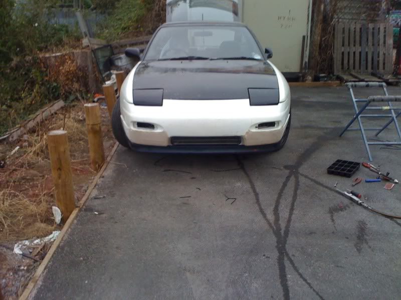

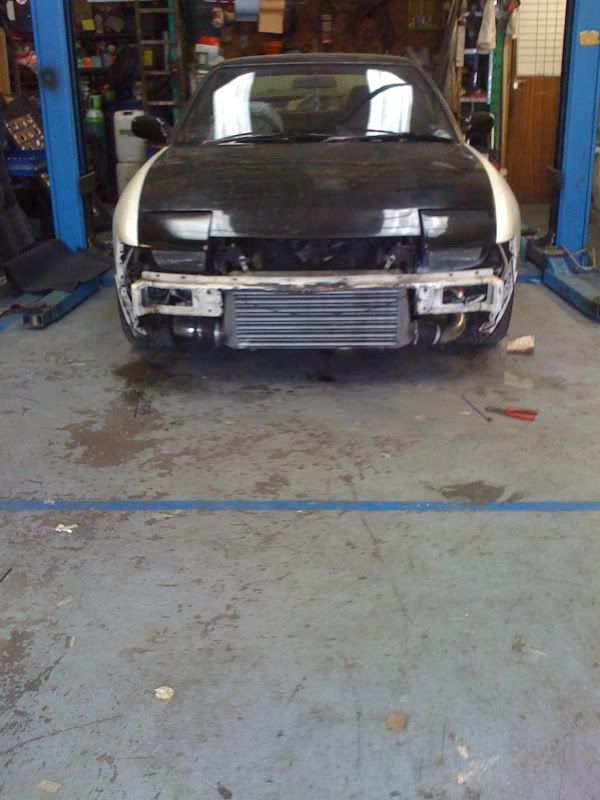

Roughly how the front end will look but with the splitter white after paint:
No engine = monster truck ride hieght!
Well, block has been honed, new rings fitted, full rubber sump gasket fitted to stop the leak, metal head gasket in place, head bolted on, and engine basically fully built.
Just cleaned up and painted some engine covers etc to tidy it all up and then it can all be fully built. It will be going in as soon as i can get the car on the ramp to work on.

Front bumper is nearly there, just final sanding of the top stop and then keying up the whole bumper ready to have the already prepared splitter fixed in place and then the whole thing primed and painted.
