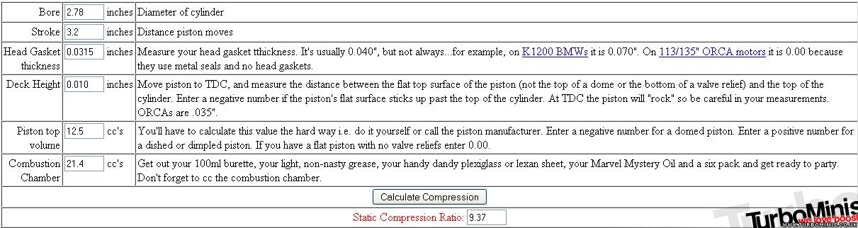

I'll measure a set when I get home. When that is said, a 21cc head and 12cc pistons will NOT make 9.4:1 CR in a standard engine.
http://www.turbominis.co.uk/forums/index.php?p=vt&tid=711
Use this if you want Vegard... Turbo piston is circa 12cc. At the very least, I'll say 11.5 to 12.5cc to avoid being finicky!
The way I work it for a turbo engine is
Bore 70.61mm
Stroke 81.23mm
Gasket Volume 3.80cc
Ring land Volume 0.5cc
Piston Volume 12.00cc
Head Chamber 21.4cc
Deck Volume 0cc
Giving a CR of 9.44:1
On a standard 1275 N/A Engine I work it as 6.5cc piston dish and 5.5cc deck height.
This also gives a CR of 9.44:1
Is this right or wrong?
0.5cc added for ring land volume
Spooners pistons were deffo N/A AE items, I've seen them.
That matches what I measured from my standard n/a 1275 A+.
