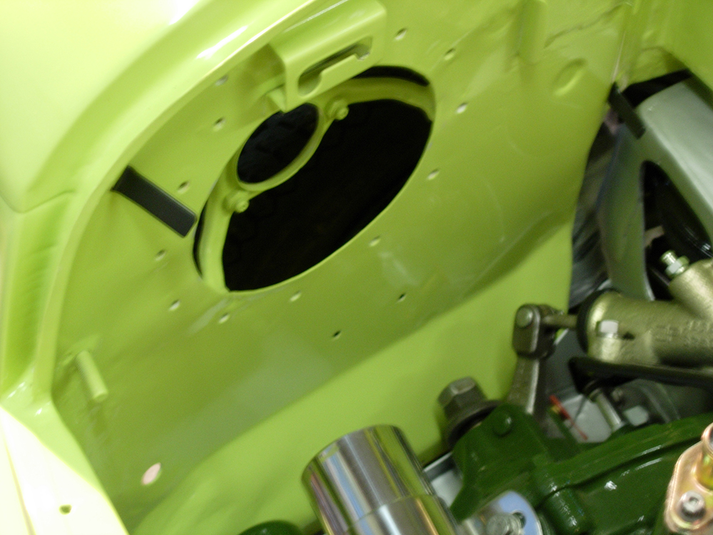

First off I made up a fan cowl and used a Honda VFR750 motorbike fan which I recessed into the drivers side inner wing. Cold air is piped from under the wheelarch over the top of the flywheel housing to the turbo and base of the carb.
I set this up to operate on a timer to operate for 5 mins after ignition switch off. The air whips out of this duct and as long as its moving over the turbo and float bowl up out of the rear bonnet vents, I've so far not needed to use a heat shield. I originally lagged the turbo and manifold with heat wrap but only have the manifold wrapped now due to overheating the turbo and blowing the seals - a costly mistake which I should have heeded advice on. You win some you lose some, its all a learning curve really. Needless to say, I would advise against wrapping a turbo to prevent carb heat soak. The best bet is to get cold air to the carb when the engine's just been shut down.

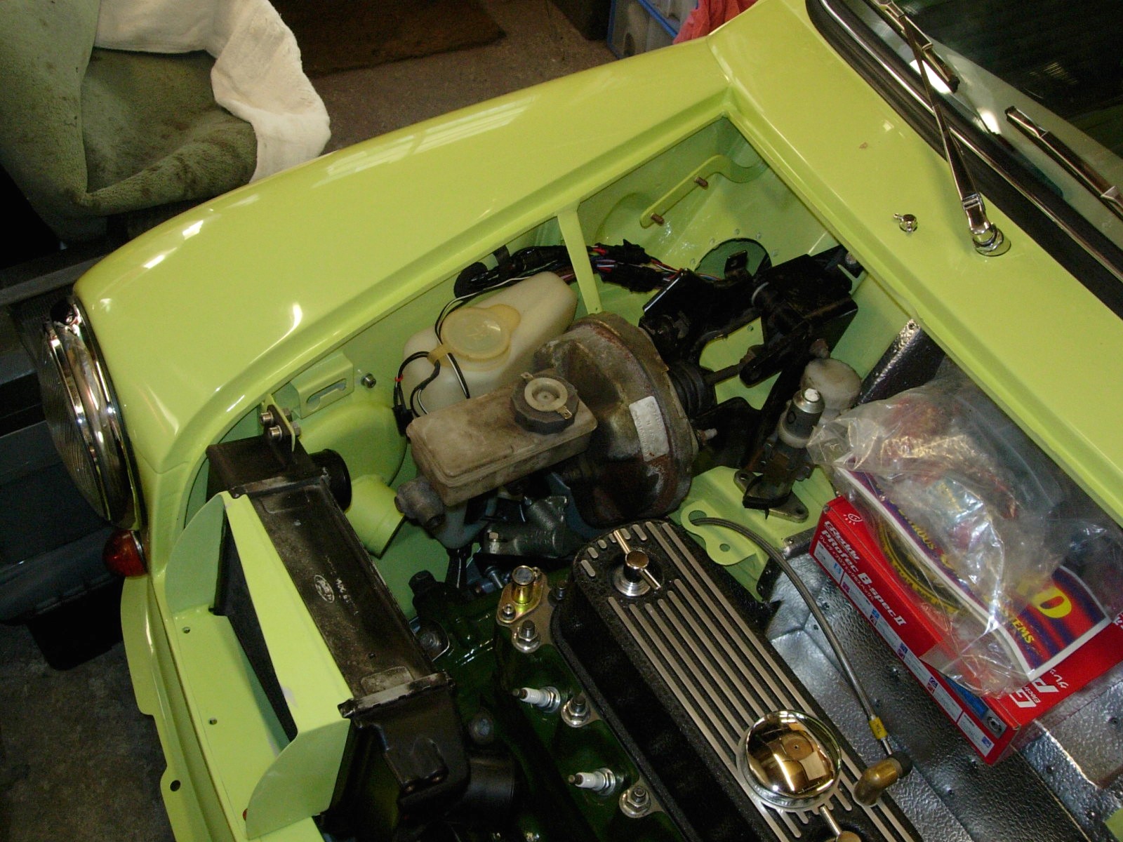

I've been having upload problems but I hope that a couple of early shots are attached showing the mounting point in the wing and the DIY duct, made from the base of a saucepan and an old fuel tank inlet pipe !
Usually takes me no longer than 2-3 seconds tops to start the engine. I'm also using a 625 Amp crank H/D battery which helps spin her up. Works a treat !

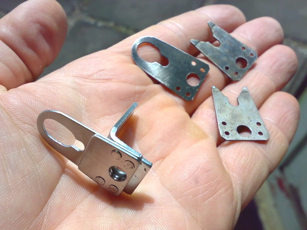

I have often wondered weather the bi-metallic strip holding the jet is also a factor.. when the carb (fuel) gets hot it is probably leaning out the mixture... cant help can it?
Anyone with a solid jet holder notice am improvement in warm starting?

Yeah Terry.
Modded my carb from the start as well. Made from st steel. Probably contributory along with the cooling fan and float extension.
Shot attached.
