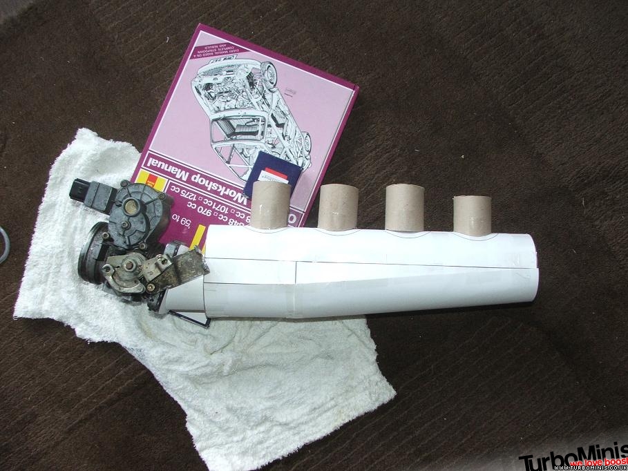

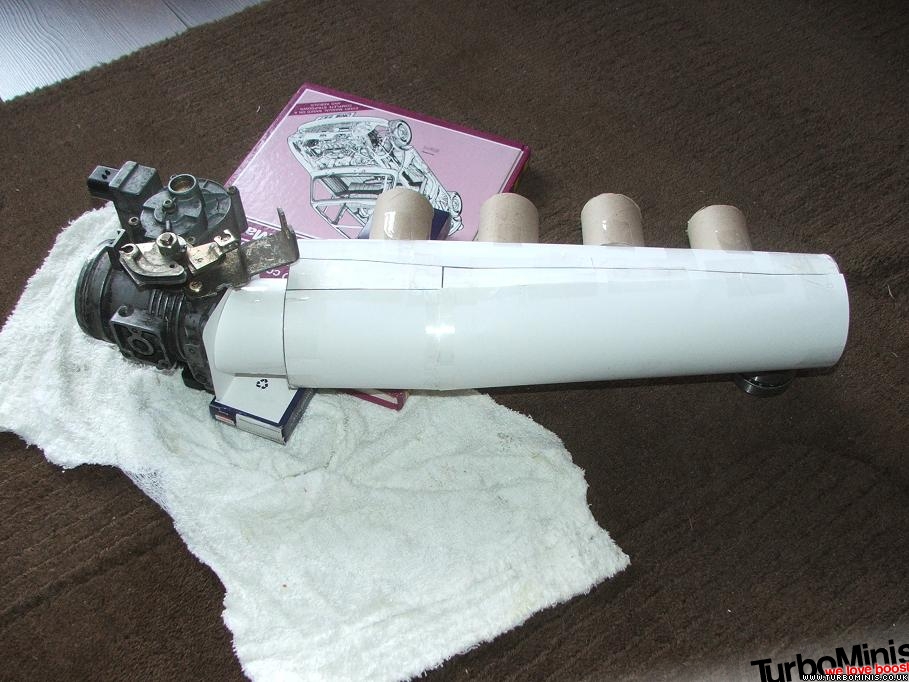

While I have been at home waiting for a call, during this time of mayhem, I have started to design the plenum. I constructed a mock up using CAD to visualise better.
The crank is there (I know your thoughts Robert *wink*) for ease of fitting the throttle body, which also opens up a possible location for the nitrous injector, on the raised square section, perfect to drill and thread :) It is also there to facilitate the use of an intercooler in the offside inner wing when the turbo goes on requiring only a short connecting hose. I may however remove the crank, fit the throttle straight and move it over a little depending on how it looks in the engine bay. The plenum itself will be made with 3" tube, and theory says to have it taper towards the end and past the last runner, with a parallelsection that runs just past the first runner. There will be a radiused mouth to the runners, which unfortunately are rather short. The throttle is from a Rover 800T, 56mm with a 'throttle kicker' stepper motor for idle air control.
Anyone have any suggestions, remembering that it needs to be simple to construct, and fit in the space at the front of the engine.

tilt the throtle body more towards no1 colin?

looks ok sprocket but i think it would work better in alloy or steel.

Yeah, i dont think it'll cope well under vacuum *hehe!*
It'll be ok if I glue it together with JB Weld
Towards No1? with the plenum in which orientation, throttle at No1 or No4? Trevor is looking for more runner between throttle and plenum. I need to get this on the car to see what room I have.

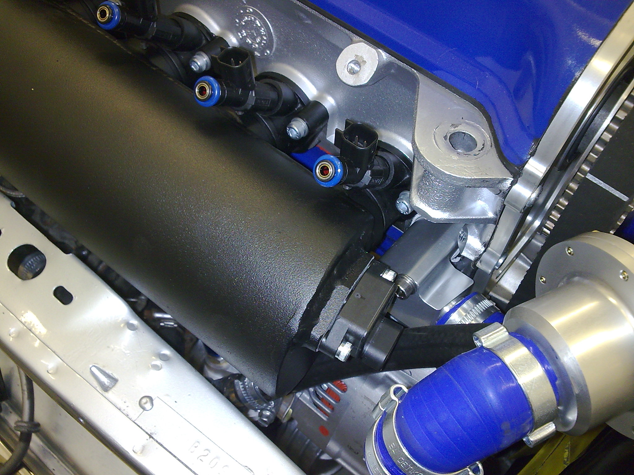

http://www.turbominis.co.uk/forums/index.php?p=vt&tid=165575
On 6th Jan, 2010 johnK said:
thats so 2009 Sprock!!!

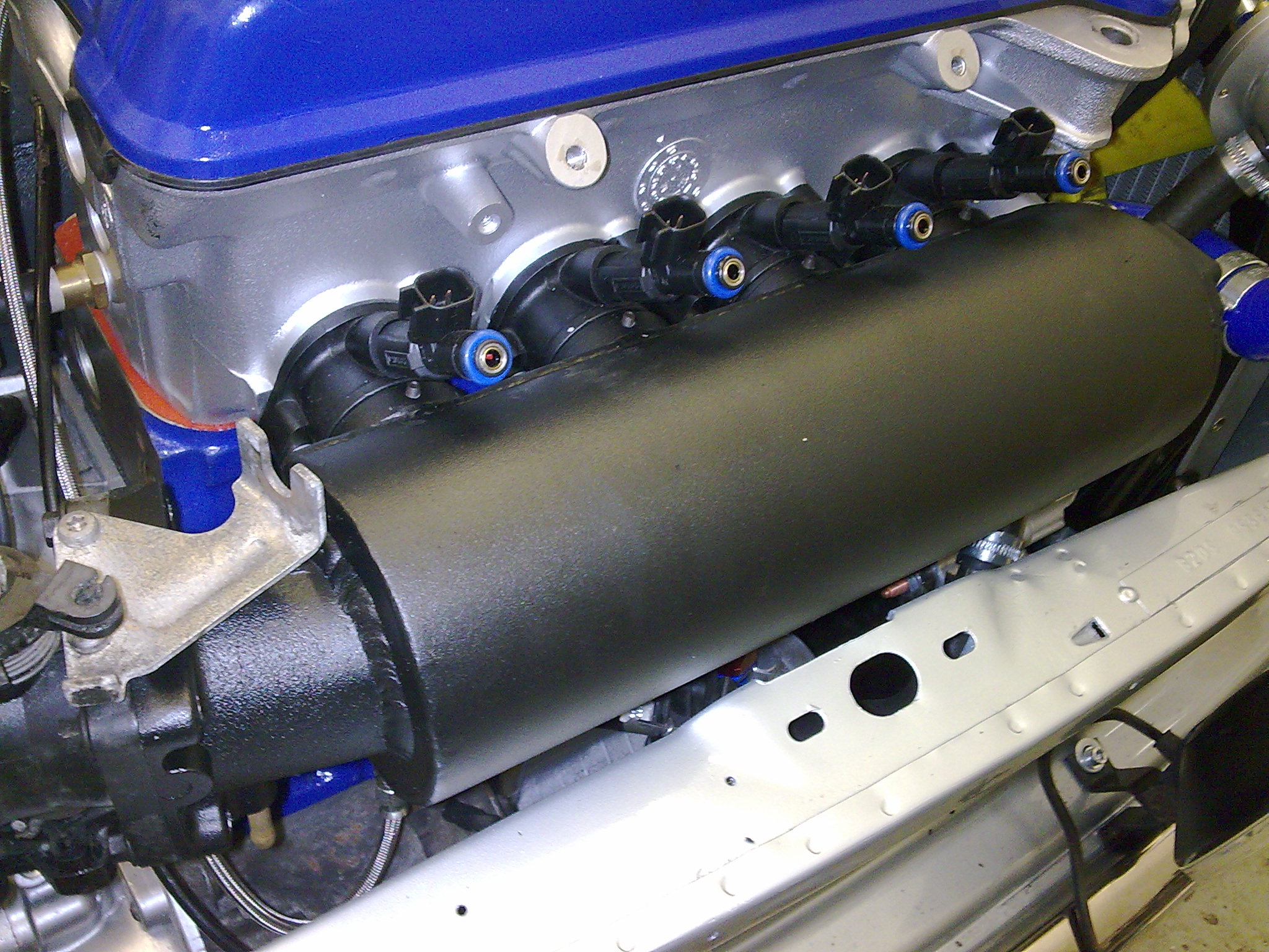

Is that a sign of things to come John? the plenum from your gold car on the silver demo car?
