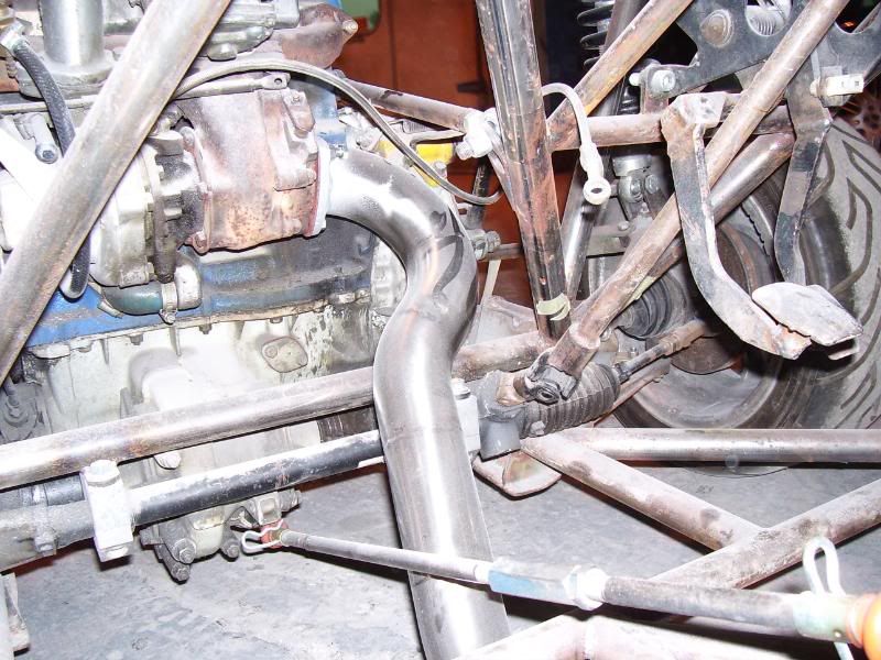

Out of curiosity i just whipped together a couple of brackets just to check clearance
1972 998 TURBO SLEEPER
Id rather see it on the subframe than mounted back on like that.
The old plate would have spread the load over a wide area, but you may find it flexing or it could even crack the floor there like the subframe sometimes does
Just weld the old bracket back on

codd_coupe
168 Posts
Member #: 1772
Leicestersheershire
On 26th Jan, 2010 Nic said:
Putting it on the subframe would be interesting though
Here is what the passenger side looks like. Dodgey camera phone photo I'm afraid though. It's an easy job to do. It makes dropping the front subframe off easier.
I'll get some better shots if anyone is interested when I take the proper camera out to the garage. *smiley*

Are those simply std U-bolts and some spacers?
Perhaps it will be up to the job then?
Looks fairly simple to do...every little helps!

I believe the metro has U bolts similar to the GTM to hold the rack on.
I guess the subframe would need to be solid mounted and be quite rigid to do this without risking damaging the column/rack.
Also would it not bring the rack slightly further away from the column?
Metro Steering rack:
Looks like it's just a couple of U bolts through the frame.
Allthough the metro rack looks to have a couple of forks for the U bolts to sit it:
