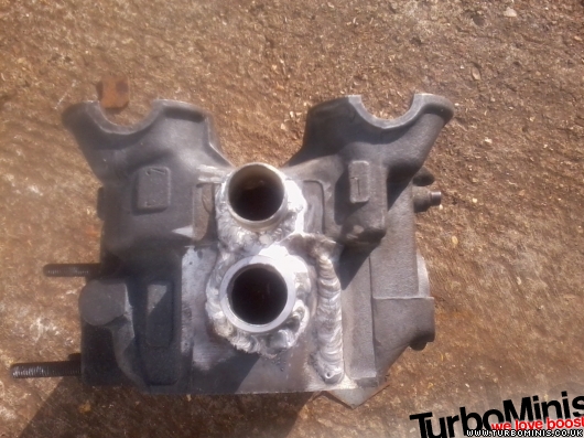

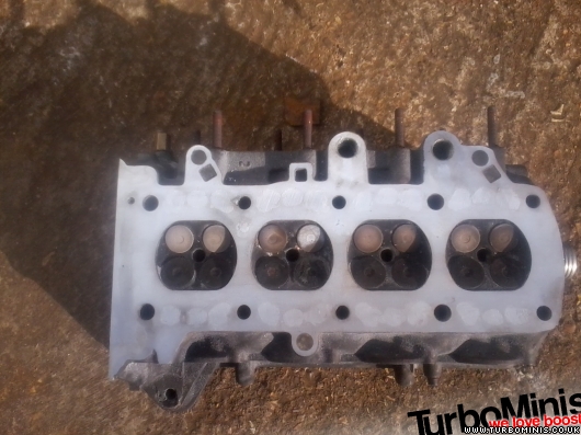

Its welded, dry decked, and flat! lol *happy*
All I need to do now, is pressure test it...fingers crossed!
how fucked was it crack wise?
My welder said it was pretty bad. He ground shite loads out to enable him to get a deep weld. 3 core plugs also popped out so im hoping they limited the damage elsewhere on the head.
There was originally a core plug where my temp sensor was located. If I left it as it was, it probably would of just popped that out instead of cracking. *oh well*

why the two outlets Matty?
think one might be an inlet (its dry decked)?
miniminor63
1849 Posts
Member #: 672
The oversills police
Oslo, Norway
one is the inlet for the water(the lower one). the other one is an oil drain
